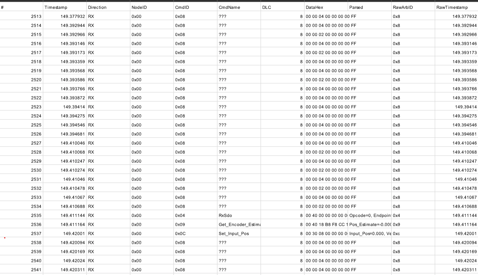

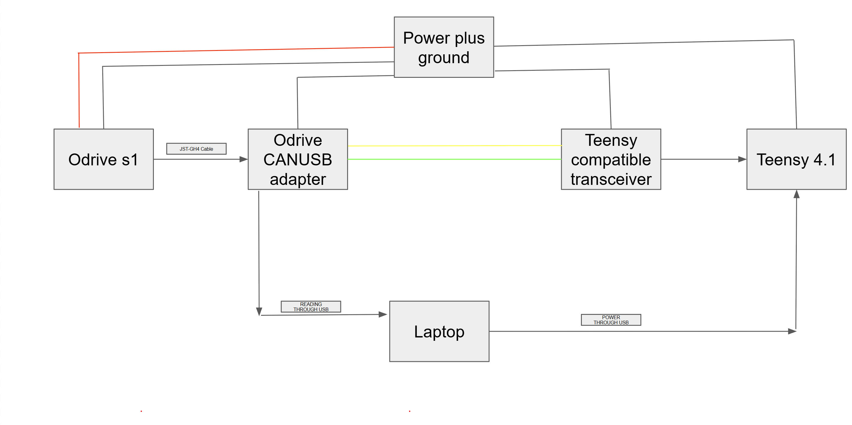

Hello, I have been using ODrive S1 for controlling 150KV motor using ODrive USB TO CAN adapter and a AI built CAN viewer tool on my laptop. It worked well. However I have now connected the system with a Teensy 4.1 and a compatible transceiver. When I read CAN Bus, I see 0x08 from same node ID 0 as ODrive (Teensy node id is set to 1) which I have never seen before and is not in the dbc too. I am attaching a CAN log and sketch of my setup. Has anyone ever faced this? Any suggestions are appreciated.

Those aren’t from the ODrive – they’re CAN error frames from the USB-CAN adapter. It reports bus errors as ID 0x20000008 (error flag + protocol error); mask off the flag and you’re left with node 0, command 0x08. Byte 2 is the error type (0x04 stuff error, 0x02 form error) and the last byte is the adapter’s receive error counter, pegged at 255. So the bus has been erroring continuously since the Teensy joined – the ODrive itself never sends 0x08.
If the viewer’s on python-can, those messages will have is\_error\_frame == True. Pulling the Teensy’s transceiver off CANH/CANL should make them disappear entirely.
The Teensy’s own frames decode fine, so I’d look at the physical layer rather than the sketch. A few questions:
- Which transceiver, and what’s it powered from? The Teensy is 3.3V-only – a 5V transceiver like a TJA1050 can be marginal on a 3.3V TXD, and its 5V RXD isn’t safe for the Teensy either.
- How many 120R terminators are on the bus? Should be exactly two, at the ends. A lot of SN65HVD230 breakouts have one soldered on, and the adapter has its own switch.
- What bitrate and clock setting are you giving FlexCAN\_T4?

1. I am using SN65HVD230 CAN Bus Transceiver for Teensy 4.1 and its getting powered from Teensy itself (3V pin)
2. When I measure total CAN bus resistance it comes around 60 ohms, so I assumed resistance should be fine.
3. Yes I think it was baudrate. It was set to 1000000 while my CAN was on 500K.
It doesnt have any question marks now. Thanks

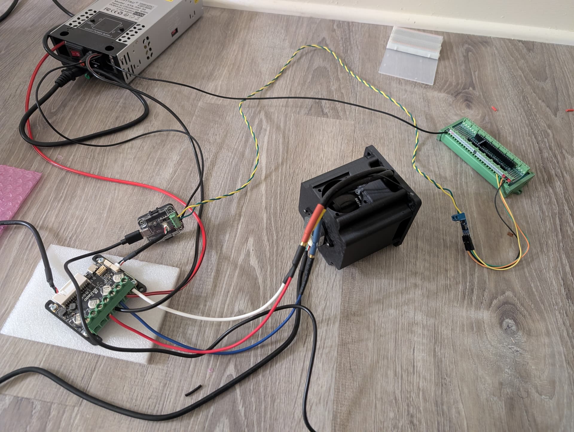

Could you send some pictures of the wiring? Or is everything working now?

Yes the CAN works now, the issue is now that Teensy is not able to read the CAN message, so I think it’s more of teensy to transceiver issue than an ODRIVE.
Here is my wiring although.

The code looks fine to me – the FlexCAN\_T4 setup matches the library examples, and the node/command ID math is right.
In your wiring photo the Teensy socket on the DIN breakout looks empty – was it just pulled for the picture?

Yes sorry, teensy was just removed from DIN Breakout before the photo.
