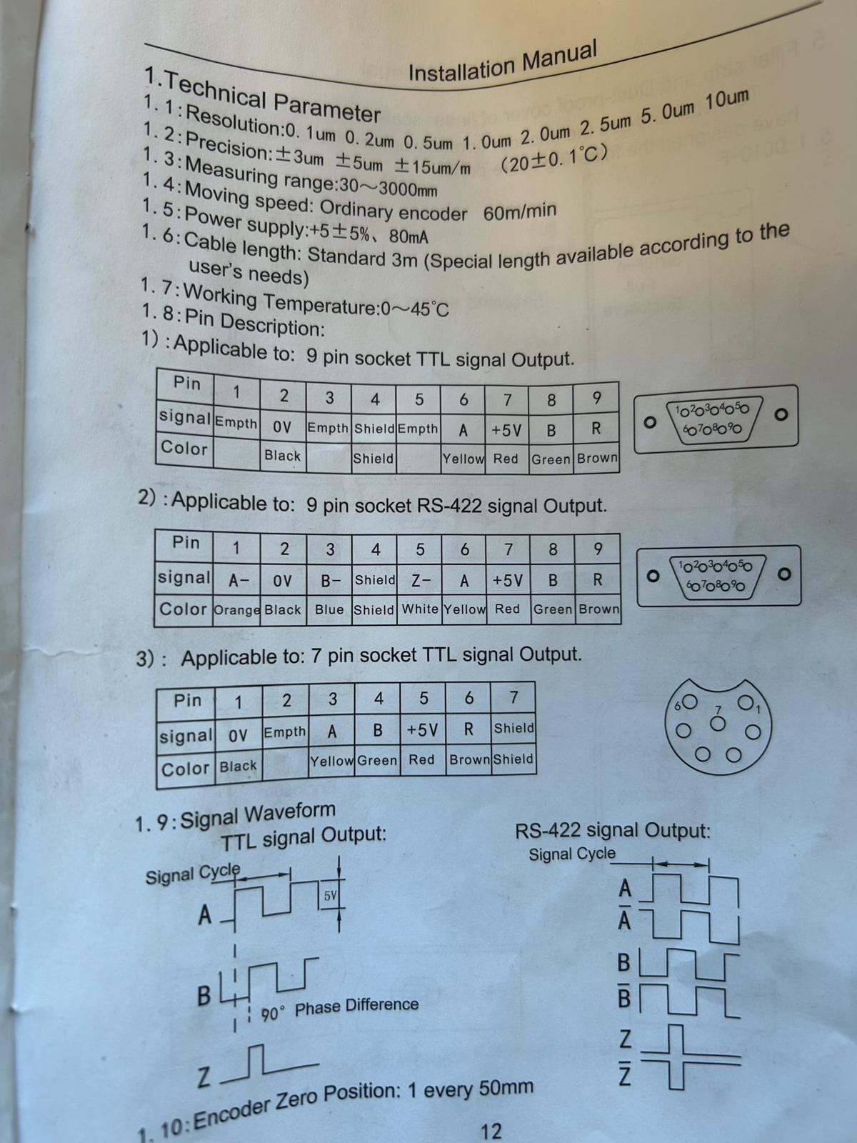

Ditron DC13
5V RS422 and/or 5V TTL connectivity (will likely end up with some of both types)
0.1 micron resolution
10000 counts per mm

Perhaps the simplest is to connect the encoder to the mesa board and linuxcnc, and run the ODrive in open loop. Any concerns with that approach?

Given that’s it’s just an incremental encoder, I think you should be able to connect it to both the ODrive and Mesa at once! I don’t think I see any issues at all with that 🙂

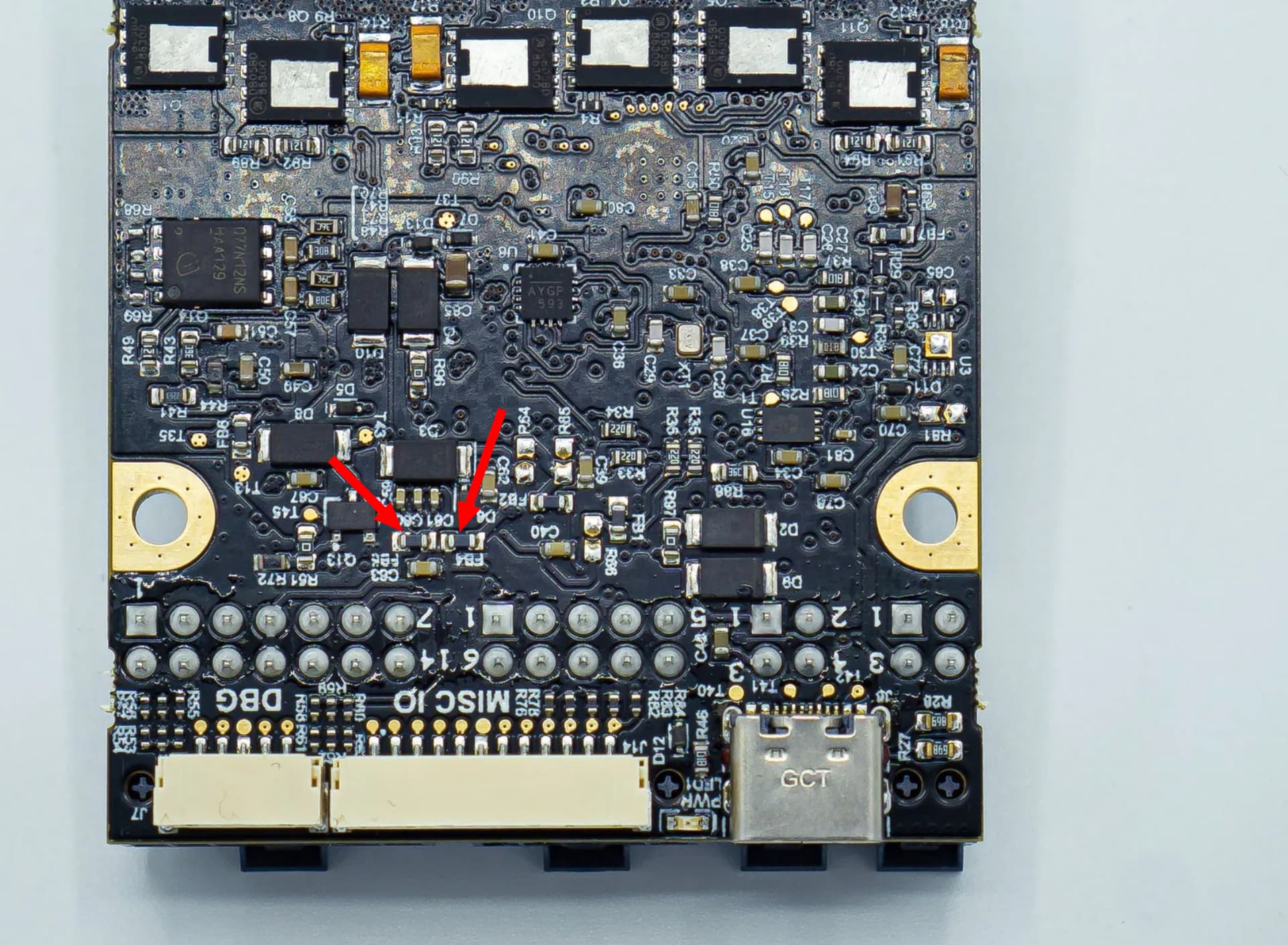

Any ground loop or resistance / signal level concerns if splicing the encoder to both the ODrive and mesa? Could there be situations where the two PID loops (linuxcnc+mesa vs ODrive) end up “fighting” each other?
Does the ODrive have the ability to re-output the encoder values, eg via GPIO pins, to the mesa board?
Ground loops, sort of. The Pro has common-mode filtered encoder inputs, so it should be able to withstand some AC-mode ground differential. But you can actually make it fully isolated – if you desolder FB4/FB5, it’ll isolate the the A/B/Z and Hall encoder inputs, just note you’ll have to externally supply power to the 5V/GND on J8.
 ![image](https://discourse.odriverobotics.com/uploads/default/original/2X/6/64774b3b709c648c7ecc69971ba25782c0d7485c.jpeg)
I mean that really depends on your system. What’s the ODrive actually doing here?
