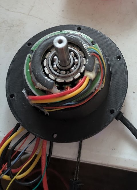

I am using an odrive micro to drive a RI50 frameless motor that is integral to a high friction gearbox
> **[RI50 KV100 Frameless Inrunner Torque Motor for Robot](https://www.cubemars.com/product/ri50-kv100-frameless-inrunner-torque-motor.html)**
> CubeMars Frameless Inrunning Torque Motor RI50 KV100 product features include：1、Voltage:24V-48V;2、Lower cogging torque for easy control;3、High torque density and dynamics;4、High precision control with 0.01°
The motor has a hall encoder built in.

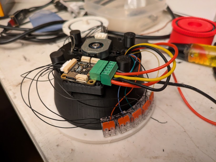

I was able to partially disassemble the gearbox to complete the motor calibration, but it is non-trivial and I’d like to avoid it in the future
I am using an AMT-232B encoder on the output of the 37:1 gearbox, and am having a hard time completing encoder calibration
> **[AMT232B-V | Modular | Absolute | Rotary Encoders](https://www.sameskydevices.com/product/motion-and-control/rotary-encoders/absolute/modular/amt232b-v)**
> Straight (Radial) Orientation, 14-bit Absolute Resolution
By manually spinning the motor I am able to verify the raw\_hall\_state has a stable sequence of 451326, and ENCODER\_HALL\_PHASE\_CALIBRATION succeeds.
ENCODER\_HALL\_POLARITY\_CALIBRATION fails with ILLEGAL\_HALL\_STATE. Could this be because the motor wires and encoder wires are routed near each other?
Spinning the motor by hand results in a reasonable raw encoder value
ENCODER\_OFFSET\_CALIBRATION fails with “POLE\_PAIR\_CPR\_MISMATCH”
I have been configuring by hand editing the config json and backing up/restoring with odrivetool over USB
Here is the current configuration, notable attempts:
- Thermistor enabled
- Commutation encoder hall
- Load encoder SPI CUI
- High calibration current/voltage to attempt to overcome gearbox friction
- Hall edges found?
- Pole pairs is 7 from motor datasheet
Power supply is ~12v

![PXL_20251017_013812499](https://discourse.odriverobotics.com/uploads/default/original/2X/d/d31d24200a6612f0579edb42642a8f1ae8aef957.jpeg)
 ![wire-route](https://discourse.odriverobotics.com/uploads/default/original/2X/2/2250a2cfa2bf26e4b4751eab78009c159239e54b.jpeg)
The ignore option did not change the calibration failures, I’ll try again in a more intentional way. Thanks for the help!
