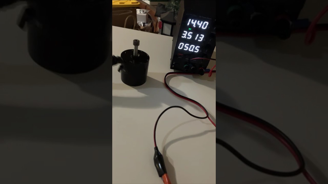

Hello,
I am trying to Rev Neo v1.1 Brushless Motor. It has an integrated hall encoder ([datasheet](https://www.revrobotics.com/content/docs/REV-21-1650-DS.pdf)). These motors have been successfully set up before, but I have having some trouble calibrating the motor as when I try to do the encoder phase offset calibration, the motor is incredibly jittery, thus resulting in inconsistent phase offset angle calculations between different calibration runs.
I have tried increasing the resistance\_calib\_max\_voltage to 7V and setting the dc\_max\_negative\_current to -0.01 but experienced the same issue.
I am using odrivetool v0.5.1 to calibrate this and input the following:

Thanks for the reply! I tried setting:
odrv0.axis0.config.calibration\_lockin.current = 30
and was still getting the same jitter. I checked my power supply while running the calibration and it looks like it is never pulling more than 3.5A

Power supply current will (almost always) be less than motor current, with the largest discrepancy at (near) zero speed – so that’s to be expected.
Could you post a video of what the motor looks like during calibration?

Ah, on 0.5.1 the lock-in current isn’t used for the hall offset calibration. That firmware runs the scan open-loop in voltage (calibration\_current \* the measured phase resistance), so that’s why it made no difference.
From the video, the motor’s stepping twice per electrical revolution rather than rotating, and the supply current drops from 3.5A during the resistance measurement to about 2.3A during the scan. That’s what I’d expect if a phase is knocked out on the ODrive, or if there’s a bad connection to one of the motor phases. Sensorless is current controlled, so it would mostly hide that.
I’d recommend upgrading to v0.5.6 – or better yet, using a newer Pro/S1/Micro, which have much better performance and firmware support (as well as hall sensor support) than those old boards.
And, I’m guessing from the firmware version that you’re using a v3.6 clone? Those usually have some really bad EMI issues that totally knocks out hall encoders in the first place.

I got to test it today and it ended up being an issue with a bad connection to one of the motor phases. I swapped out the connector and was able to get it calibrating and tuned just fine. Thank you for the help!
