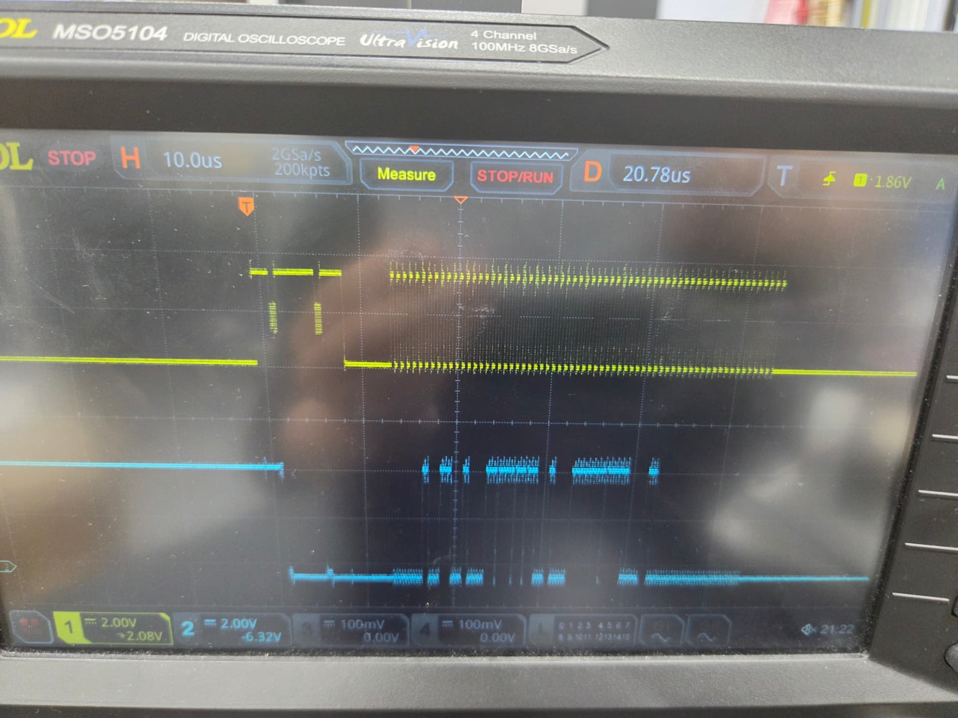

I’m trying to read a Renishaw EVOLUTE linear BiSS-C readhead with an ODrive Micro and always get `NO_RESPONSE`. The same encoder, transceiver and wiring work fine with an STM32 Nucleo.

### Scope capture (Micro, approximate values, screenshot attached)
- SCK idles **Low**
- t = 0 µs: SCK goes High and stays High
- t ≈ 2 µs and ≈ 7 µs: two short bursts
- t ≈ 3 µs: encoder data line goes Low
- t ≈ 14 µs: main clock burst starts, ~39 µs long, ~1.5–1.6 MHz (~60 clocks, estimated)
- A complete frame (~36 bits) appears after the Start bit around the 5th main clock
 ![20261008_212136](https://discourse.odriverobotics.com/uploads/default/original/2X/8/84ee03b93d7264ebc785e60b8f36f94f1b59b7ee.jpeg)
My guess (I’m not sure about this) is that the encoder is responding, but it’s being triggered by the SCK activity before the main clock burst. If so, SLO would already be Low by the time the main burst starts, and maybe the firmware treats that as no response.

Hi!
Your guess is right. On the Micro, the SPI clock is shared with the onboard SPI devices, so you see a burst on SCK every control cycle even when the ODrive isn’t talking to your encoder – that’s the high section with the two short bursts at the start of your capture. A regular SPI encoder ignores that since its nCS stays high, but BiSS-C has no chip select, so the EVOLUTE takes the first burst as a request (SLO drops right after it) and is already mid-cycle when the real read starts.
So the clock to the encoder has to be gated with nCS. What we’ve typically seen work is inverting nCS and using it to drive the driver-enable (DE) pin of an RS-422/RS-485 transceiver, so MA is only driven during the encoder read – e.g. an SN65C1168E, 2x THVD1420/THVD1450, or 1x THVD1452. The receiver side (SLO → R → MISO) can stay always-on.
If you’d rather keep the THVD1451, an OR gate in front of D does the same job (e.g. 74AHCT1G32, powered from the same 5V): SCK and nCS (G00) in, output to D. MA then sits high whenever nCS is high (BiSS-C is idle-high), and only gets the clock during the encoder read.
No inverting adapter needed, CPOL isn’t the issue here.
