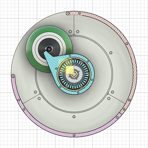

Hello all, this might be a bit of a weird application for Odrive so allow me to explain.
I am making a machine that is meant to throw a juggling object called a diabolo. The machine is basically a 3/4 circular ramp that pushes the diabolo around until it exits out the other end. Here’s a cross-section of the launcher, the green thing is the diabolo and the blue is the arm which pushes the diabolo around the ramp, mounted to the face of my motor. In the picture it is in its “armed position”, then I command it to move around (clockwise in the pic) and once it completes 3/4 of a revolution the ramp ends and diabolo should continue with the tangential velocity it had at the point of leaving the ramp.

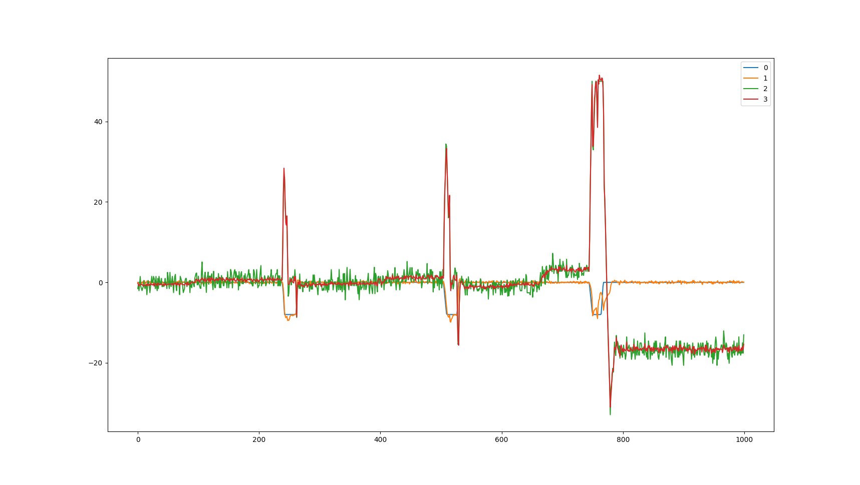

Here’s my conundrum, I just can’t seem to get the gains right to save my life. I understand that this sort of intermittent torque can be very confusing for the odrive and unsurprisingly it’s causing some erratic behaviour. Below are the results from the liveplotter, Blue is target velocity, orange is measured velocity, green is target current and red is measued current. As you can see, the first launch is usually the best. The current is almost zero while I ask the motor to hold position without any load. Then it increases slightly as I apply the load (the diabolo, around 250g). Then I command the launcher to move and the current spikes, the measured velocity follows the target velocity nicely until the object is launched, then there is some expected overshoot as the load is released and the odrive catches up to correct the torque.
 ![odd spinout](https://discourse.odriverobotics.com/uploads/default/original/2X/2/2c2aa0a4a27b836308e1fa04db6964ea7f921ca9.png)
What I don’t understand is why the launches are getting progressively worse. As you can see, at all points the current increases, both when it is just holding still and when it is launching the object, this also translates to worse launches. After the third launch you can see how erratic the current/velocity is and most concerningly after the launch it is using 20A to make the motor just hold position with no load attached!
Ah, this is textbook encoder slipping, likely an issue with the encoder magnet. I’d give this a quick read: [Designing for Magnetic Encoders — ODrive Documentation 0.6.12 documentation](https://docs.odriverobotics.com/v/latest/articles/magnetic-encoders.html)
Essentially, just make sure the magnet is 100% bonded to the motor shaft, and not just held in there with friction or magnetic force or anything like that – some glue is always a good move.

Thank you, I can confirm this was the issue. I thought it couldn’t be encoder slippage because I thought I press fit the magnet reasonably hard, but sure enough as soon as I took the motor off the magnet was loose (actually surprised how well it worked, all things considered). Presumably since I 3d printed the mount then creep was enough to undo it. A dab of superglue and haven’t had the problem since 🙂
