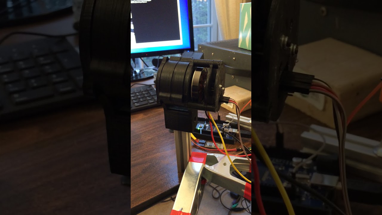

Hi there - I’m trying to characterize the performance of some prototype robot joints that I’m designing and have noticed an “issue” with the ODrive not being able to successfully reach the goal position I’m giving it. It feels to me like this is a tuning issue, but it’s not obvious to me where I should be looking to further understand what I’m seeing. Any pointers would be greatly appreciated!
Just a little background – I’m using an ODrive v3.6 with 0.5.1 firmware. I’m driving small Flycat iRotor motors (pathetic little things, but very inexpensive). I’m controlling the ODrive over CAN from an Arduino Mega at the moment. I’ve gone through the tuning process for the motors and am using the following tuning parameters:
pos\_gain=50.0
vel\_gain=0.01
vel\_integrator\_gain=0.0
So, what I’m doing is playing with my latest joint iteration and it seems to be exhibiting symptoms of sticking. Although after doing a bunch of exercises with it I think what is really happing is it’s having issues positioning the motor to within the error I’ve specified (0.1 turns). If I bump (in my Arduino driver code) the allowable position error to 0.3 turns my tests complete as expected. If I run the following (from odrivetool):

For clarity - what my “characterize” process is doing is first moving the joint to one extreme of the movement, waiting for it to get “close enough” (defined by an allowable error tolerance (0.3 turns in this case), then it moves through ten cycles, extending the joint 1/10th max extension, waits for the joint to get there, then back to zero, waits, then 2/10th max extension, etc. Until it gets to max extension on the 10th step. You can see that each step takes longer (which is to be expected, because the joint is moving further). It’s not really possible to see from this graph, but on none of the extensions does the joint ever actually get to the goal position, but on the last one it is fairly obvious that it’s about 0.2 turns shy of the correct position. And you can see that the controller is still pushing 5amps through the motor to try to close that last little gap.
So, why is the controller able to move the motor larger distances, but gets ‘hung up’ on the final little bit? Note, this is a full 1/5th to 1/4 of a turn of the motor, so I wouldn’t think it would be a cogging problem.

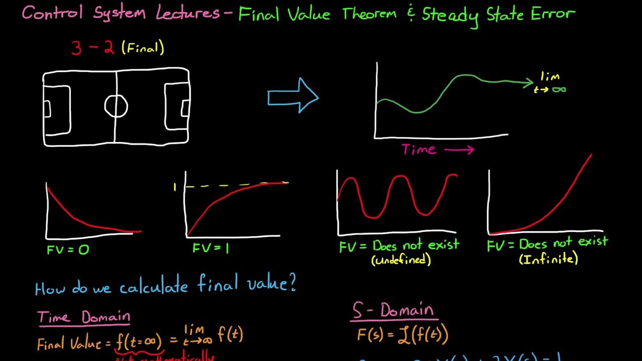

This is expected behaviour from control theory with “pure” proportional control. It’s called steady-state error.
[![](https://img.youtube.com/vi/PXxveGoNRUw/maxresdefault.jpg "Final Value Theorem and Steady State Error") ](https://www.youtube.com/watch?v=PXxveGoNRUw)
