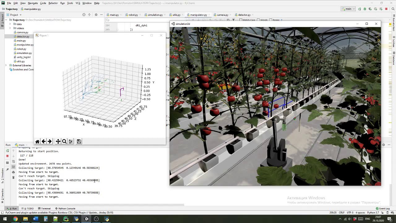

Hello, everyone.
I just want to show you the current state of project development.
We are using Odrive paired with AMT232B-V absolute encoders.
The simulation environment is made with Unity3d.
Tomato recognition runs on a Mask-R CNN.
The trajectory for the grip is built using the gradient descent method.
The end of the grip has soft rubber tentacles to prevent crushing the fruits and vegetables. When air pressure is applied to them, the grip occurs. The video shows 2 tentacles, but there will be up to 4 in total.
