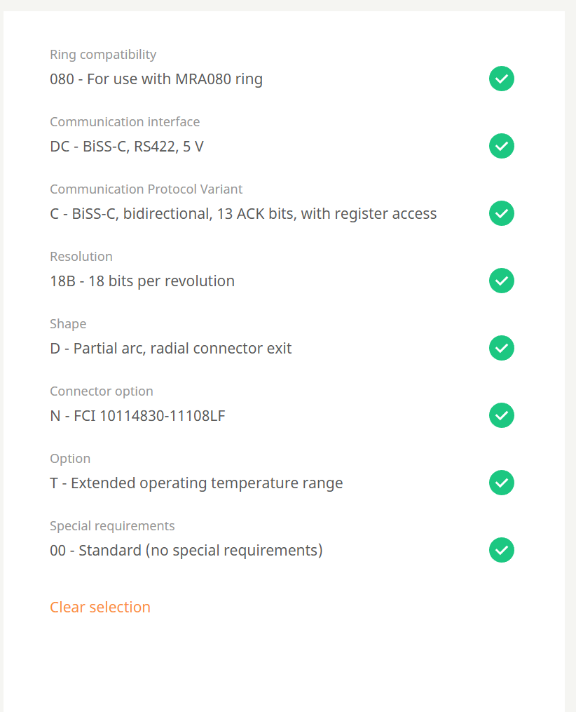

Hello Fellow ODrivers,
My team is thinking of using the AksIM-2 BiSS encoder for our next ODrive project. I wanted to know if there are any tips/tricks you recommend before we start.
We plan on using the ODrive Pro for this. We saw that this particular encoder is experimentally supported and wanted to reach out and see if we can get a head start.
I attached a pic of the encoder configuration for anyone interested.

Hi! Shouldn’t be any issue at all. People have used this exact encoder before.
