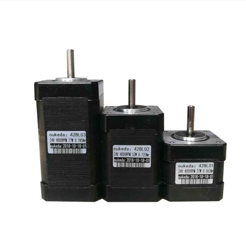

May I ask what encoder you are using? Note with hall sensors due to the low resolution, position control is extremely poor, and velocity control at low speeds is quite bad.
the motor i bought has its own hall sensor internally. (i don’t use external encoder including external hall sensor)
i leave the link i bought.
then, i think i should modify the step input value because i use hall sensor and u said its performance is poor at low speed.
would it be right?
i’m thinking about 6.6 rev/s because its maximum speed is 66.66 rev/s (4000 rpm)
