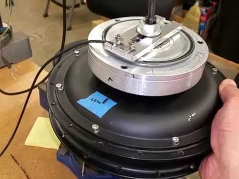

Unfortunately, I am not able to get the motor working enough to do the anti-cogging function.
I’m able to pass motor and encoder calibrations, but when I go to set a position, the motor will not move (or sometimes moves after a delay). When it doesn’t move, my 22V DC supply shows the current steadily increasing to around 4 A before shutting off the motor with a DC_BUS_UNDER_VOLTAGE error.
After a complete confuration erase here are the settings I use:

I’ve tried many different settings and modes. The motor acts as if there is not enough torque to overcome the small load. When it does move, I get OVERSPEED errors.
Can you help with some ideas??
