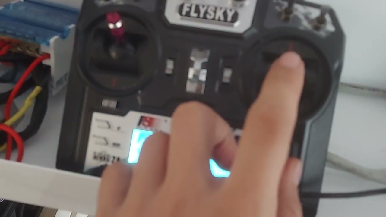

Hi ı have a 1000w 48v 5kv hub motor and ı drive with 12s lion before, but now ı want use 13s lion and ı have a dc_bus_over_voltage error, how it is gone does anyone can help me?
When first open all thing is okey, but while ı give speed from rc control if ı give high acceleration motor is cut the voltage and throw this error
when ı try 10s lion its not any issue
but ı try 13s and ı have this error, ı cant find which value fix that
I use 0.5Ohm 50w standart resistor, on odrivetool ı give resistor = 0.5
What I Did:
increase over voltage trip level = my odrive burned
erase and set again
Hey Samet,
Is this with ODrive v3.6, Pro, or S1?
The default resistor included is 2 ohm - if this is set incorrectly, then yes an overvoltage error can occur. I’d set it correctly and try again.
my resistor is 0.5 ohm and ı set true, ı use odesc 3.6 54V
