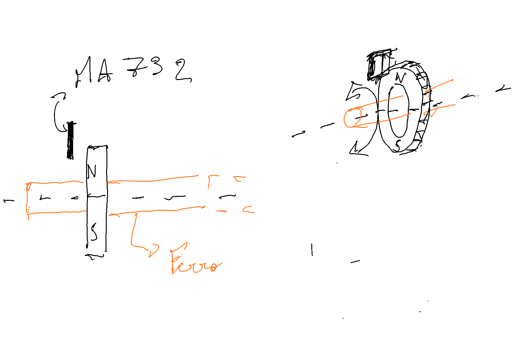

  • The motor has an external rotor with a static shaft, so I cannot mount the encoder on-axis
  • I designed a 3D-printed part fixed to the rotor, on which I mounted a ring magnet
  • The encoder is placed off-axis
More precisely, the geometry is the following:
  • The distance between the motor axis and the sensing center of the encoder is equal to the external radius of the ring magnet
  • So the center of the sensor is aligned radially with the outer edge of the ring magnet
  • The sensor is not facing the magnet radially
  • Instead, it is oriented parallel to the motor axis and “looks” along the axis direction, towards the motor
In other words, the sensor is positioned beside the rotor, at the same radius as the outer edge of the magnet, and measures the magnetic field along a direction parallel to the shaft
(see schematic)

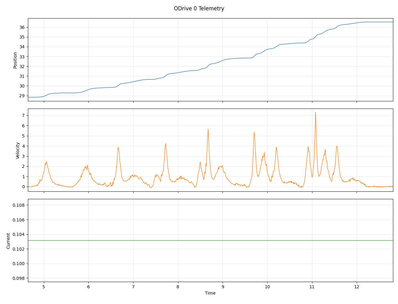

At low speed (when I rotate the motor slowly by hand):
  • The measurements look correct
  • I observe one acceleration followed by one deceleration
  • The position evolves smoothly
At higher speed (still by hand, but faster):
  • The measurements become incorrect
  • I observe multiple acceleration and deceleration events, even though I only applied a single impulse
  • This suggests that the position measurement is also corrupted

Measurement example
I recorded several manual accelerations (7 attempts with increasing force):
  • The first two measurements look correct
  • The following ones show multiple speed peaks, even though each corresponds to a single acceleration of the motor

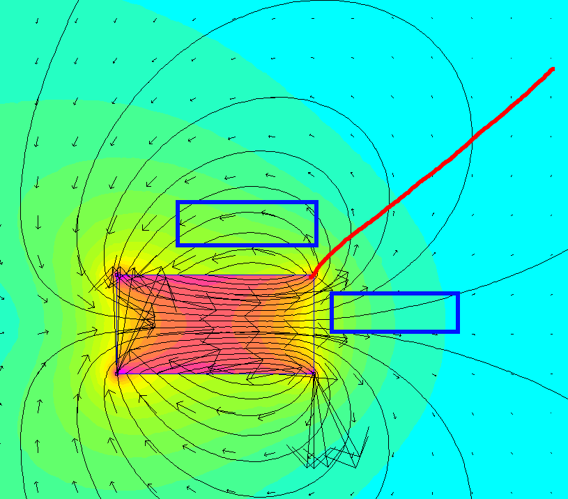

This is textbook off-axis sensing – it introduces a periodic error in the sensed position, that needs to be compensated. You can write to registers in the MA732 itself to do this compensation in the chip itself, but the ODrive has much more fine-grained compensation it can do onboard.
Note you have to be careful with ring magnets – there’s a big dead zone in the field strength right where you have the MA732 mounted right now. You ideally want it to be aligned more above the magnet, or a bit further out.
Specifically this is because the field sensor needs to be able to sense a radial component to the magnetic field, but there’s a general region (denoted by the red line) where the flux vector is primarily vertical. So having it more on either side of that line is best. Usually people will position it around one of the two blue boxes.

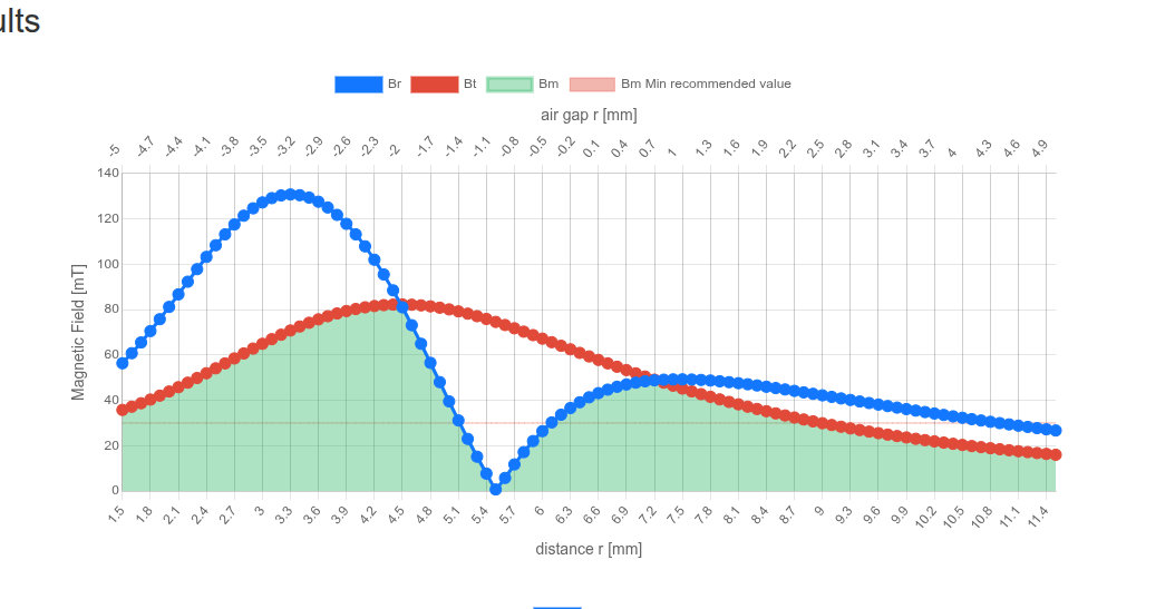

This is a really great tool to find the ideal sensor location: https://sensors.monolithicpower.com/
Then once you have the k value from the simulation, you can write it to off_axis_k on the ODrive: ODrive API Reference — ODrive Documentation 0.6.12 documentation
Then, you’ll want to run harmonic compensation to fine-tune any distortion.
After that, you can run encoder calibration as normal, and it should work fine!
