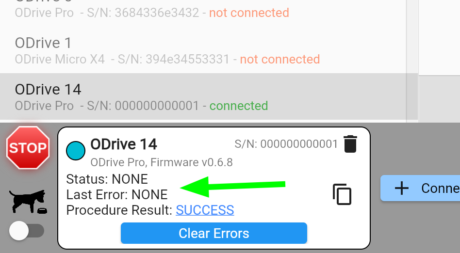

For this post I report and ask about position mode. If I switch it to control position, the first instant I touch the slider the motor kicks and turns off. Not sure where to start here. Any suggestions?

Guessing this is just an issue with the pos_gain tuning (try setting pos_gain lower). As bad as hall sensors are for low-speed velocity control, they’re even worse for position control. You can get some semblance of control with tuning, though may not be worth it. I’m guessing the S1 is throwing some error that you can see in the bottom left corner – what error is it?
