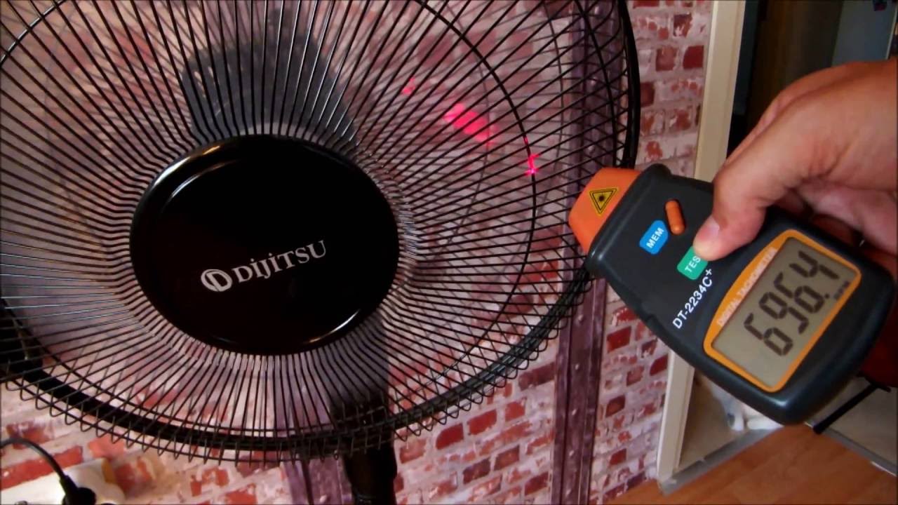

i would like to have a simple, good enough, easy to use, rpm meter.
i found the dt2234+ on banggood
it is a bit cheap ($12)
but it seems to do the job.
my typical usecase is that i have a spinning motor running at constant speed (hopefully)(typically turnigy), that i may control with odrive (and then i just want a quick and dirty way to check that it spins as i beleive it does). sometimes it’s with another controller (and here i dont have a clue). and sometimes it’s not even a brushless motor.
ideally i woudlnt connect anything mecanically. dont have to use/configure an oscilloscope.
i just want a second pair of eyes
what would you buy/make? how do u do this?

I have one of those handhelds. There ok. If you can spare $70 a better option is an Eagle tree elogger V4. You get real time or data logging/graphs at 50hz sample rate for rpm, temp, amps/volts/watts and more. I mainly bought mine for rc aircraft but have used it more on non rc related things. Good bang for the buck

Yes. That’s what I’m referring to. It does require an optional rpm sensor. Either optical,
http://www.eagletreesystems.com/index.php?route=product/product&path=65&product_id=71
magnetic,
http://www.eagletreesystems.com/index.php?route=product/product&path=65&product_id=69
or the brushless type that connects to 2 of the 3 motor wires.
http://www.eagletreesystems.com/index.php?route=product/product&path=65&product_id=64
An example of how the optical sensor would work is by having a small silver colored or polished shaft collar mounted on the motor shaft with 180deg of the surface painted (or sharpie markered) black. The magnetic sensor would use 1 or more magnets mounted to the similar shaft collar example above. More magnets = higher resolution.
