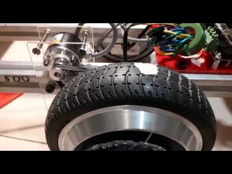

I have mode some changes to my setup.
I used a GT2 timing pulley. The timing pulley has a pitch of 2mm. I have also used a different pulley as suggested. The meshing with that pulley mounted on the encoder shaft is better that the earlier setup shown in the images above.
The setup now is shown in the image below.
the front side of the encoder is shown in the image below
based on the setup. the gear ratio now is 1:8.35
the pulley on the encoder has 20 teeth, the number of teeth on the hub motor is 167.

The ENCODER_OFFSET_CALIBRATION is successful.
However my motor does not Run when I try out the CLOSED_LOOP_CONTROL_MODE.
I give a input_vel and still the motor does not rotate as required.
What is get is some abnormal behavior where the motor turns in one direction and violently oscillates.
How do I fix this issue ?
This is extremely concerning.
Here is a video of the motor behavior. I requested the motor a input_vel=1
Thanks in advance!
