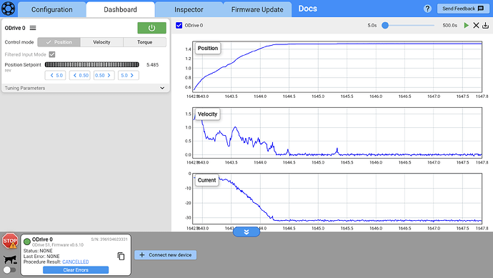

I finally got some time to work on the project and got a couple CNC parts back to push the actuator to its limit. If the M8325s is able to do about 3NM at stall torque, that plus my gear ratio should be an actuator stall torque of 75NM? I have it lifting cinder blocks with a fish scale attached on a 2 foot pole. It seems to be stalling at closer to 54NM. Nothing is bending or breaking, just seems to be hitting its stall torque. The tool seems to be reading out 32 Amps at stall. Any thoughts as to why it seems to be leaving 10amps/20NM on the table?
For configuration parameters I set everything pretty default. The motor limit is set to 50A. No limits are set on the supply. My temp limit is 130C. The control mode is “ramped velocity control.” When conducting this test I was using position control. When using torque control, strangely it capped at 20A. Would love thoughts and advice. Thanks!
Hi!
In torque control mode, with torque mode velocity limit enabled, the ODrive uses vel_gain to derate the torque versus speed. With high torque motors, this can cause a torque limit even at standstill – see here for more information: Controller — ODrive Documentation 0.6.11 documentation
I’d recommend either tuning your vel_gain, or disabling enable_torque_mode_vel_limit – note that the latter can have safety considerations (as it removes the ODrive’s ability to limit the speed of your motor), so I’d strongly recommend just tuning your vel_gain.

Okay, so I’m just going to reiterate your system config as I understand it, correct me if anything’s wrong:
  • You’re using M8325s, which has a default 50A current limit in the GUI
  • You’re using a S1 + 48V supply. Given the S1’s voltage-current derating, we can assume a 40A worst-case maximum current.
  • You’re using the S1’s onboard encoder, with the S1 mounted to the M8325s
  • You have the M8325s connected to the 1:25 planetary, with a 2’ pole, a heavy load, and the maximum torque you’re able to get from the motor is (seemingly) about 2.16Nm.
Now, when you say “The tool seems to be reading out 32 Amps at stall,” what exactly are you referring to? Do you mean the estimated current based on the force you’re reading on the scale? Or the current shown in the ODrive GUI?
I would go to the inspector tab, and find and graph the following properties:
  • effective_torque_setpoint
  • iq_measured
  • iq_setpoint
If you can send a plot of these while you’re doing that load test, that would be very helpful.
Also make sure torque_soft_min is less than -3Nm (e.g. -5Nm) and torque_soft_max is greater than 3Nm (e.g. 5Nm).
Also look for fet_thermistor.temperature and motor_thermistor.temperature, and make sure both of those are below about 80C – the ODrive may be getting hot and self-limiting.
I’d also note that torque control mode is likely the right choice for this – after either tuning your vel_gain or disabling enable_torque_mode_vel_limit.

I disabled the enable_torque_mode_vel_limit setting as I wasn’t sure how to tune the velocity gain (I imagine more would enable higher torque at risk of instability or the actuator jerking?).
The 32A stall limit is what I measured on the tool from the main screen when controlling from position or torque control. Screenshot below:
Here is a capture of the three variables all in one go. I slowly incremented the position until the rope is taught (around 90 degrees or parallel to the floor), and then increment further to induce the motor into stall torque.

S1 derates allowable current based on bus voltage, see here: ODrive S1 Datasheet — ODrive Documentation 0.6.11 documentation
Drop your overvoltage trip threshold to around 50-51V and you should get your full 40A :slight_smile:
If you want to push even more current, grab a lower voltage power supply (24-36V or so) and you can push 80A transients/peaks (just make sure you have some sort of thermal management / heatspreader plate on the S1).
This did it! I did a torque test of 82NM on the actuator at around 40A! I’ll try to push it to see where it fails, but so far it’s doing everything I needed. Time to buy more :slight_smile:
The idea of getting a lower voltage power supply is really interesting to me! I’ve vaguely heard of people dropping the bus voltage to apply more torque, but have you heard of anyone doing this with odrives dynamically? For example a 6DOF arm that moves quickly under no load at 48V, but drops to a 36V or 24V high load mode when lifting a heavy object? Seems interesting, could maybe even be done with a power supply controlled over CAN or some sort of switching between supplies?
Great to hear!!
Hmm, this may be something else. The S1’s voltage-current limitations are just due to how we designed the inverter, and isn’t going to be an issue in future ODrive models (nor is it a limitation on the ODrive Pro). Here, dropping the bus voltage just allows for more overall power (48V * 40A limit = ~1.9kW, 36V * 80A limit = ~2.8kW), which you’d have to change the gear ratio to take advantage of. If you were to use an ODrive Pro instead (which can maintain full output current up to nameplate voltage), maximizing power would require using a power supply of said maximum nameplate voltage.
