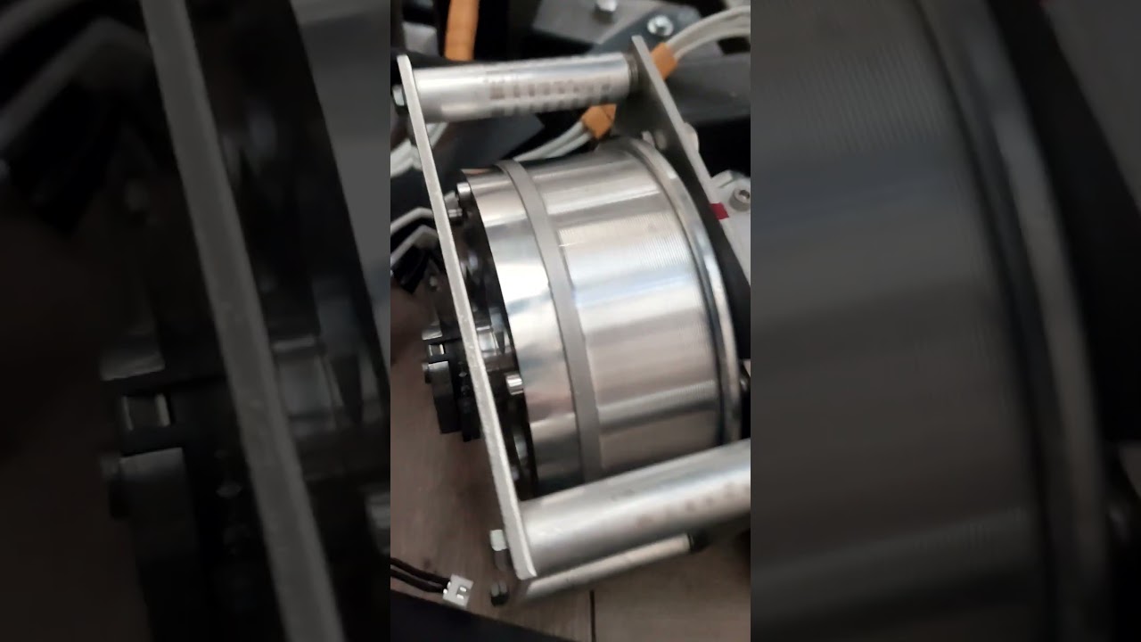

I have weird issue with hoverboard motor (25mm magnets), it’s clicking constantly when under load in closed loop. Only 1 of 6 identical motors does this. Makes the same sound like the index finding or going to IDLE mode when testing, but constantly. It’s very annoying because it’s part of 6DOF motion simulator. I ruled out encoders (AMT CUI103), cables, motors and odrives channels by interchanging them. Only one ODrive, only channel 1 does this. What can be the cause?
