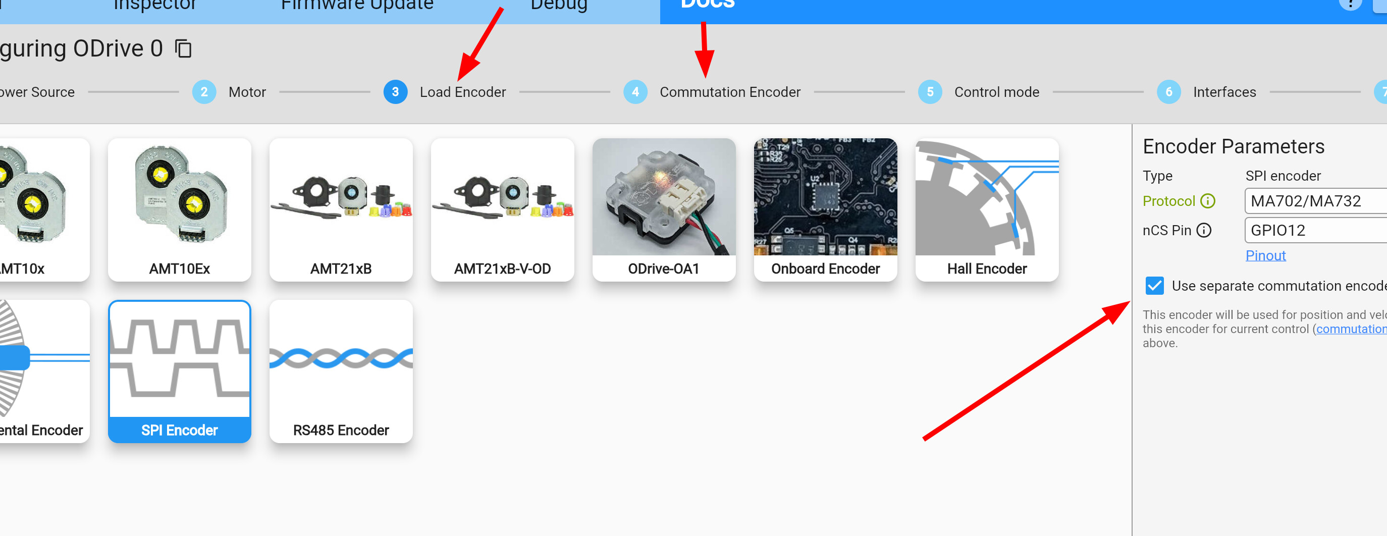

Thank you for your insightful answers. Actually, one of our products has dual encoders, hall sensor before gearbox for motor and MA732 after the gearbox for shaft. The gear ratio is 112:1. The ODrive does support dual encoders like its specification states.
Can you instruct me how to configure dual encoder from the Encoder Configuration section? What should I add or change in Inspector panel?
You just need to check “use separate commutation encoder”
Then you get the option to define both commutation and load encoder; here the commutation encoder would be hall sensors, load encoder would be the SPI encoder.
