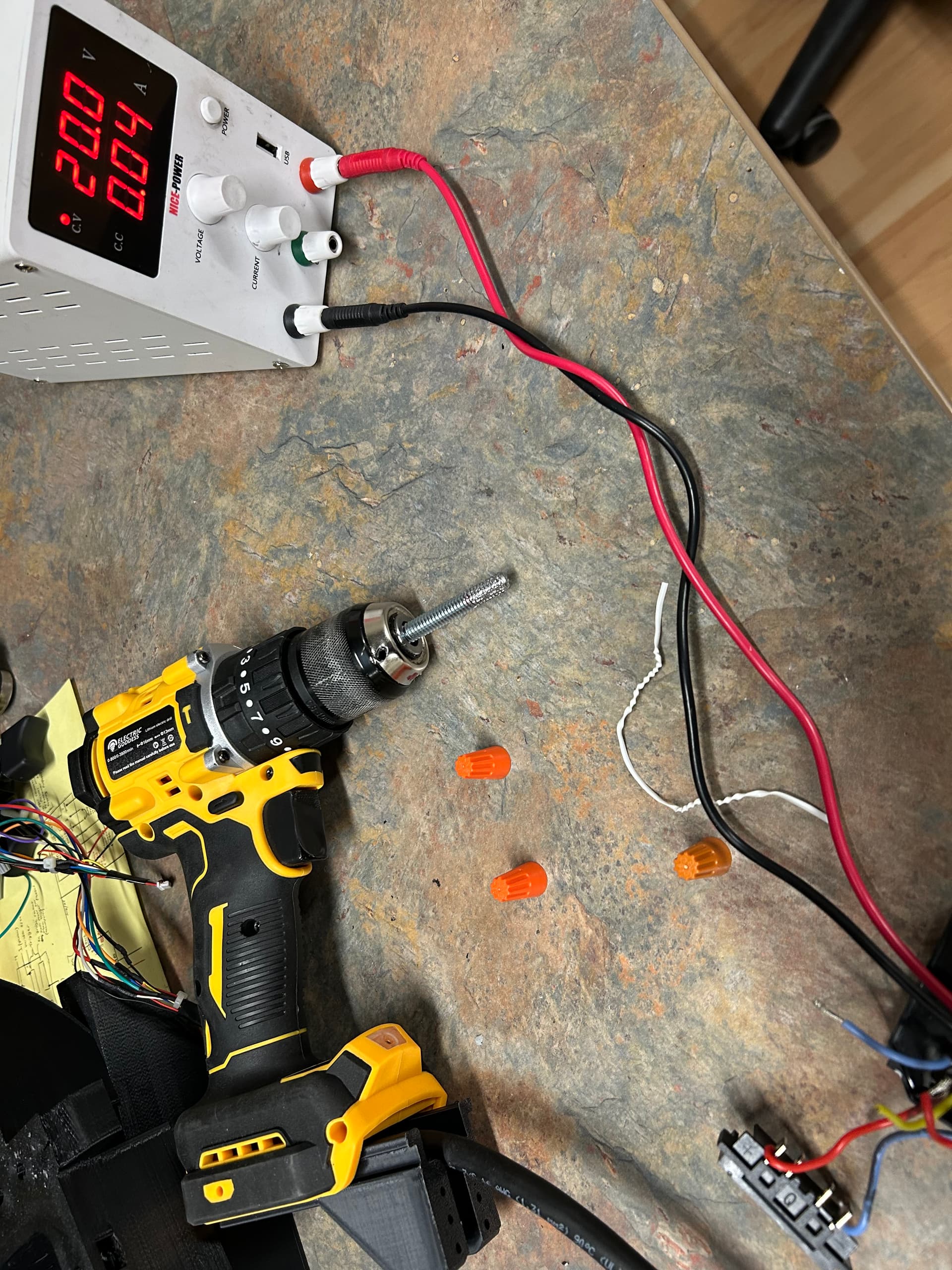

Hello,

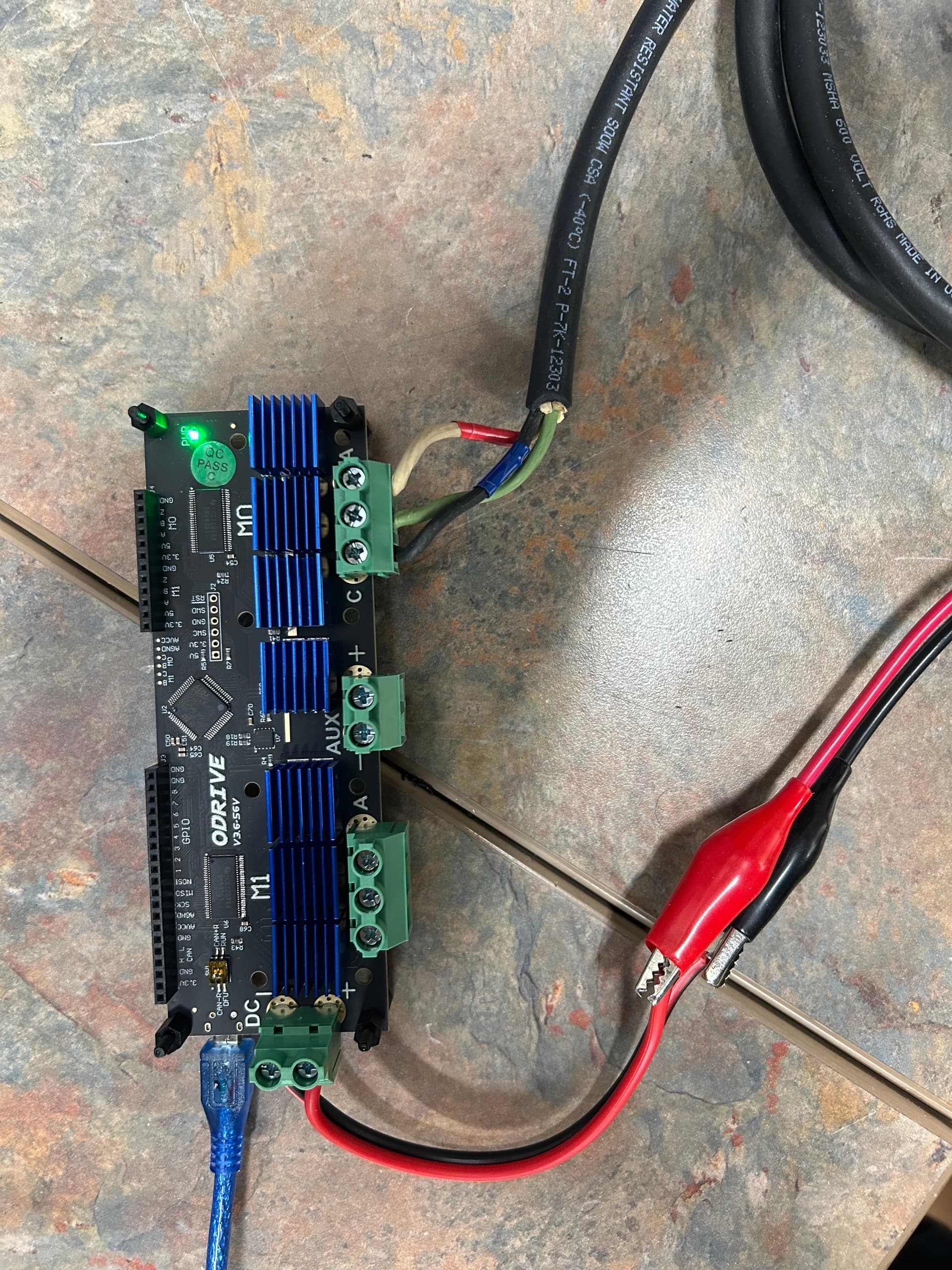

I’m new to ODrive, and I was hoping to have it control the drive system of the RC UGV I’m building, which is powered by two 20V cordless drills.

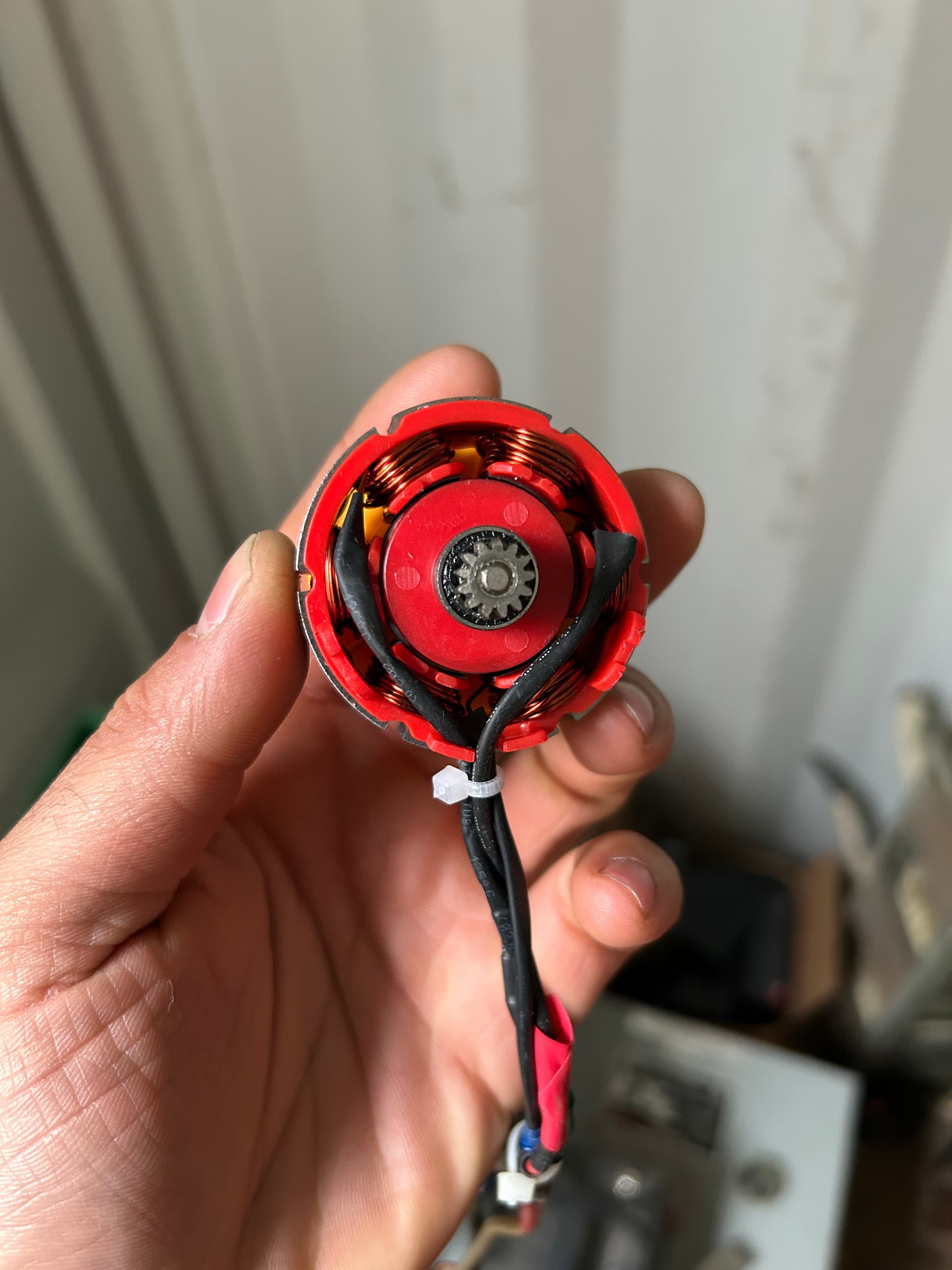

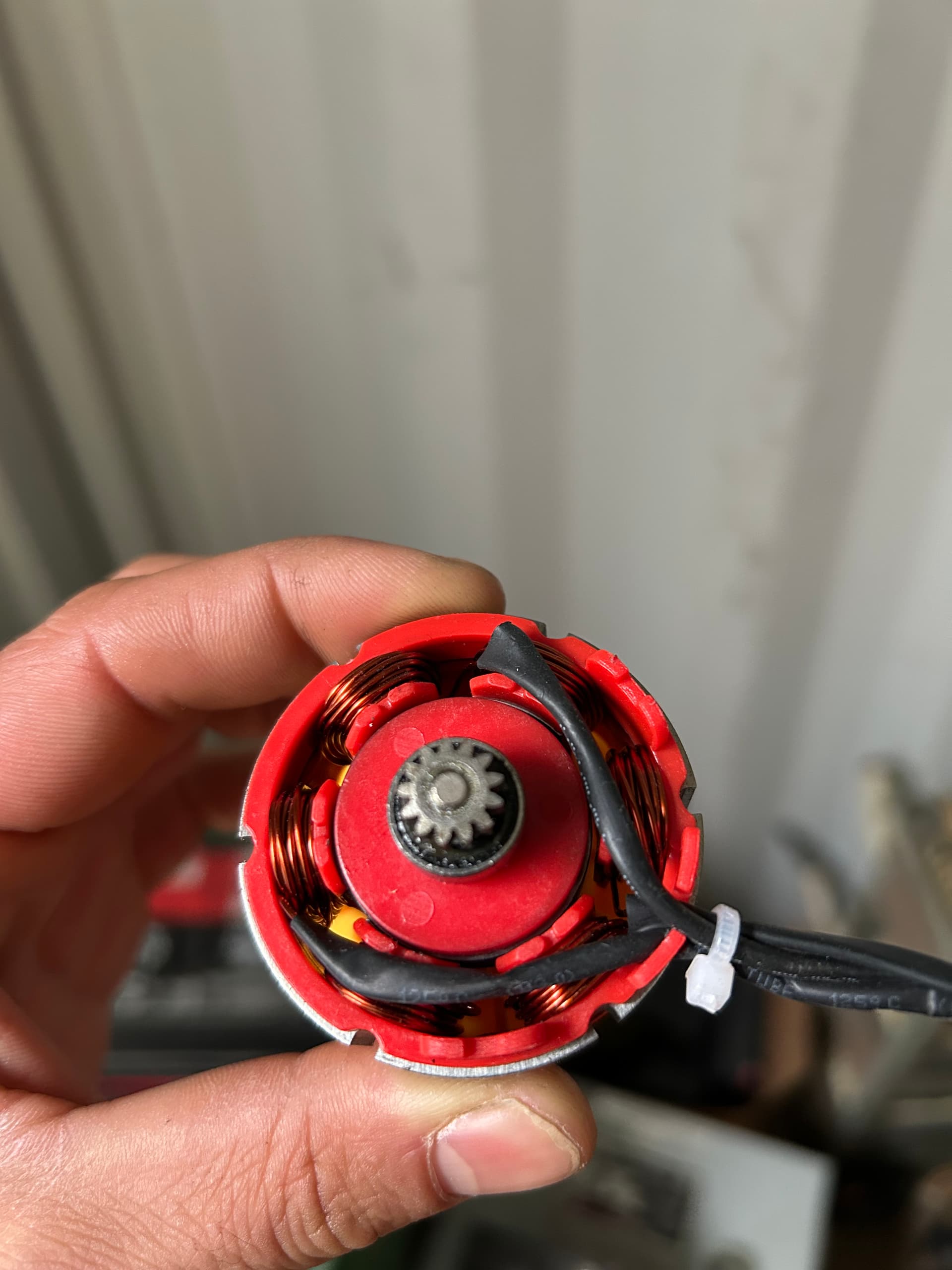

I have the drill’s ESC which obviously runs the motor perfectly fine, but my issue is that I want to run the motor at a slower speed than what the ESC can run it (the slowest speed the ESC allows is ~150rpm before it cuts out to 0; I want at least 20-40rpm as the slowest speed). I was hoping to achieve a ‘creep’ speed function utilizing an ODrive V3.6-56v board.
I have no information on the motor, but I measured the resistance between each phase and it 2.4 ohms exactly between all phases.
I did run some test codes, had my motor successfully ‘beep’ at me, but it doesn’t move at all (Although I have had the motor move a tik (I think it moved the next pole. It moved very little) when running the code, but when I re-ran it, it beeped but didn’t move. I even tried manually spinning the motor with no luck. (I see the amperage go up on my power supply before the motor beeps; The highest being ~1.5A then dropping down to ~0.87A after the motor beeps then drops to 0A)
I’m completely lost and any help on getting my motor running with this board would be greatly appreciated.
Thanks in advance.
The drill I am using
Drill Motor:
Wiring Setup:
Output from the code I used (originally I was using 20V but I bumped it to 24v because I heard that’s the operating voltage the ODrive board likes):

If you’re looking to run that motor in sensorless mode, the ODrive isn’t going to do much better than the drill controller. If you want control at low speeds, you’ll need to add an encoder.
Additionally, I’d note that LLMs do a really bad job with ODrive parameters – a lot of those API calls are just incorrect. I’d recommend reading the docs, and upgrading the firmware on your board (v0.5.1 is old, even for the v3.6).
Thanks for your response, I really appreciate it.
I do agree that LLMs do a terrible job, but I figured I’d give it a try just to see what happens.
I managed to upgrade the firmware to v0.5.6. & I’m reading through the docs now.
So how would an encoder help the ODrive start/run the motor? Especially since this motor has such a high resistance compared to other motors used in examples and youtube tutorials. Also, does it have to be a certain encoder or can it be any rotary encoder?
Thanks again.
No worries, glad to help!
Some sort of position sensing is required for proper control of brushless motors. There are various “sensorless” methodologies to avoid this requirement, but they nearly all require some minimum speed of the motor – usually a sensorless controller (like a drone ESC, your drill’s internal ESC, or the ODrive in sensorless mode) will send a series of pulses to the motor to “drag” the rotor around (sort of like a stepper motor – very different methodology than actual proper BLDC control) until it’s at the minimum speed feasible for sensorless control, then it’ll kick in the actual control algorithm.
However, if you have an encoder, all this is null and void – the position sensing that the encoder gives allows for 100% torque output at zero speed. Plus, way more precise torque/speed/position control than any sort of sensorless scheme.
You can see supported encoders here: ODrive encoder guide - Google Sheets
Note that quadrature (“incremental”) encoders require an encoder calibration at each startup, which can only be done with no (or very little) load on the motor. If the encoder has an index line, you only have to do the encoder calibration once (e.g. before you put the motor on a gearbox) and as long as you don’t shift the relative rotation of the encoder and motor (they need to stay coupled), future startups of the motor only require up to a single rotation to restore calibration. Absolute encoders only require one-time calibration, but usually communicate over a digital communications protocol like SPI, which the v3.6 has a lot of issues with, so I wouldn’t recommend that (ODrive Pro/S1/Micro are much more reliable and performant overall). More info here: Encoders — ODrive Documentation 0.5.6 documentation
Shouldn’t super matter! Careful to set the current limit correctly so the motor doesn’t get too hot. But the ODrive auto-calibrates the motor’s resistance/inductance.
Thanks. I will try a compatible encoder and see how it goes.
Best of luck, let me know if I can help!

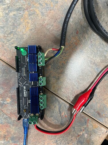

Hello again,
I bought a BQLZR 600P/R Incremental Rotary Encoder and temporarily attached it to the shaft of my drill for testing, but when I try to set everything up in odrivetool I get this error (I bought the Odrive from AliExpress):
Device 355434653034: Not a genuine ODrive! Some features may not work as expected.
Connected to device 355434653034 as dev0
In [1]: odrv0.axis0.motor.config.current_lim = 10
NameError                                 Traceback (most recent call last)
File <ipython-input-1-15704943fe5b>:1
----> 1 odrv0.axis0.motor.config.current_lim = 10
NameError: name 'odrv0' is not defined
How do I fix this error so I can test to see if my motor will work with the encoder?
Thanks again.
Ok so I figured it out
I used dev0 instead of odrv0.
However when following the docs and running: dev0.axis0.requested_state = AXIS_STATE_FULL_CALIBRATION_SEQUENCE my motor only turns in one direction but not the other, even though the doc says: After about 2 seconds you should hear a beep. Then the motor will turn slowly in one direction for a few seconds, then back in the other direction. Is this indicative of a problem or did I not set something up correctly?
When I run: dump_errors(dev0) I get this:
dump_errors(dev0)
system: no error
axis0
  axis: Error(s):
    AxisError.INVALID_STATE
  motor: no error
  DRV fault: none
  sensorless_estimator: no error
  encoder: no error
  controller: no error
axis1
  axis: no error
  motor: no error
  DRV fault: none
  encoder: no error
Also, these are the setup cmds I ran:
dev0.axis0.motor.config.current_lim = 10
dev0.axis0.motor.config.pole_pairs = 7
dev0.axis0.encoder.config.cpr = 2400
dev0.axis0.encoder.config.mode = 1
dev0.save_configuration()
dev0.axis0.requested_state = AXIS_STATE_CLOSED_LOOP_CONTROL
dev0.axis0.controller.input_pos = 1
Oh gotcha - unfortunately those aliexpress ODrives are all knockoffs/clones, and have all sorts of issues – not worth your time whatsoever. I’d recommend returning it and getting a genuine ODrive product (only genuine ODrive products sold are via our webshop) – strongly recommend the S1, it’s much more reliable and supports newer/easier firmware than the old v3.6, plus our new web GUI.
