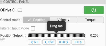

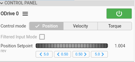

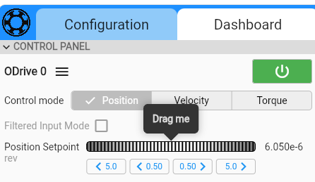

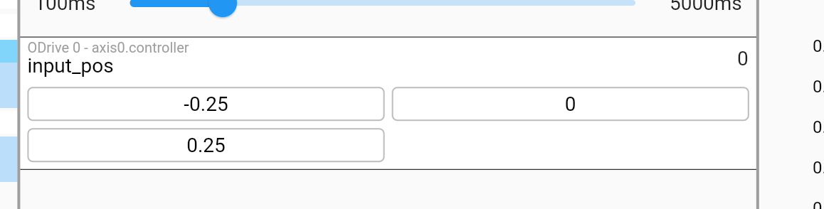

I do have another question, in the GUI of Dashboard, there are 4 buttons for positions, <5.0, <0.5, 0.5> and 5.0>. We are really interested in quarter turn of the motor, means we need buttons like <0.25 and 0.25>. Is there a way how to achieve it? or can you simply update your GUI for us to test our motor? And we will buy more ODrive Pro if this feature is available. We highly appreciate all your support.

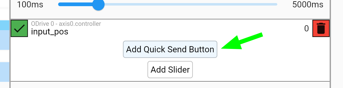

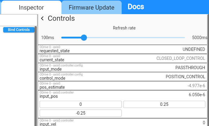

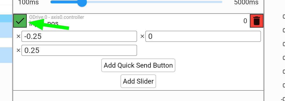

In the inspector tab, you can set custom buttons for sending position setpoints:
The new buttons were not added, maybe I don’t have the version of software you have, or I missed any steps?
Hi! Sorry if I wasn’t clear. This will just add the buttons in the inspector tab, so you can move the motor to desired setpoints yourself.
Thanks for the feature request though, I’ll add it to the list!
If I may ask – are you looking at using the GUI in a production environment? I may recommend a quick Python script if you need very simple user control like this; the GUI is typically intended for bringup / testing / tuning.

If you can add the buttons or numerical input box for position in GUI, it will much convenient for us. Since we are focusing on quarter turn of the motor. The half turn buttons cause motor overturn and the dragging wheel is very hard to set accurate position, not very useful.
You may simply replace <5.0 and 5.0> with <0.25 and 0.25> in the GUI. Please let me know once you add the feature. Thanks for your understanding and support.
