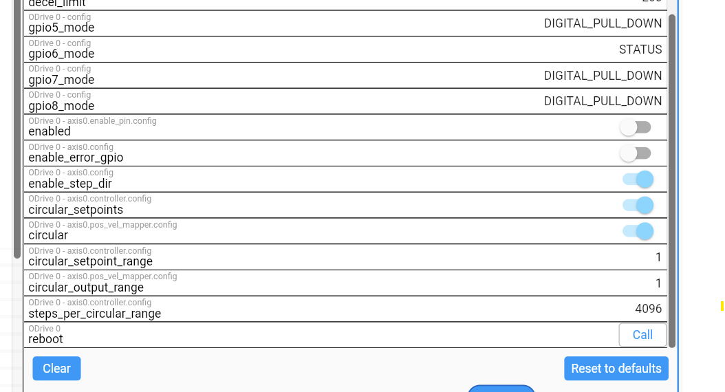

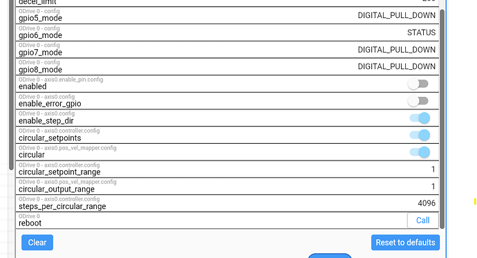

nothing i change seem to matter, it keeps wrapping around the circular setpoint range
here are my configurations, what am i missing?
