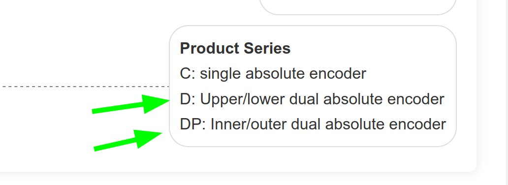

Hi! BiSS-C is typically the best bet, but we don’t currently support dual BiSS-C encoders. However, do you mean two discrete encoders, or this encoder with one of these two ordering options? Because that definitely changes things.
