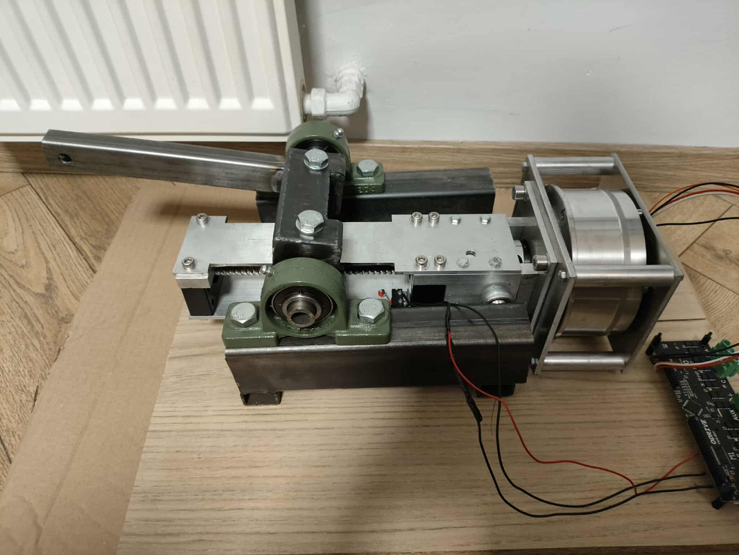

Here is how the actuator looks (i don’t use limit switch to set starting position, just make sure real index point is where I need to start)

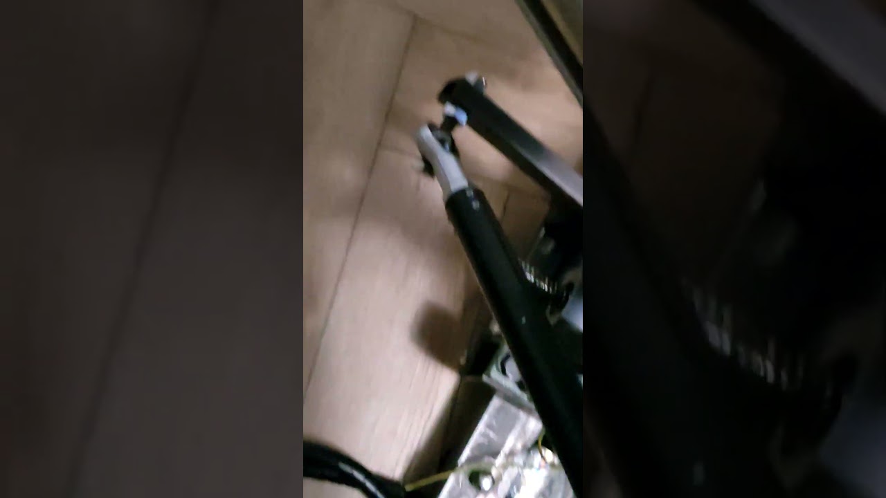

Here is up direction:

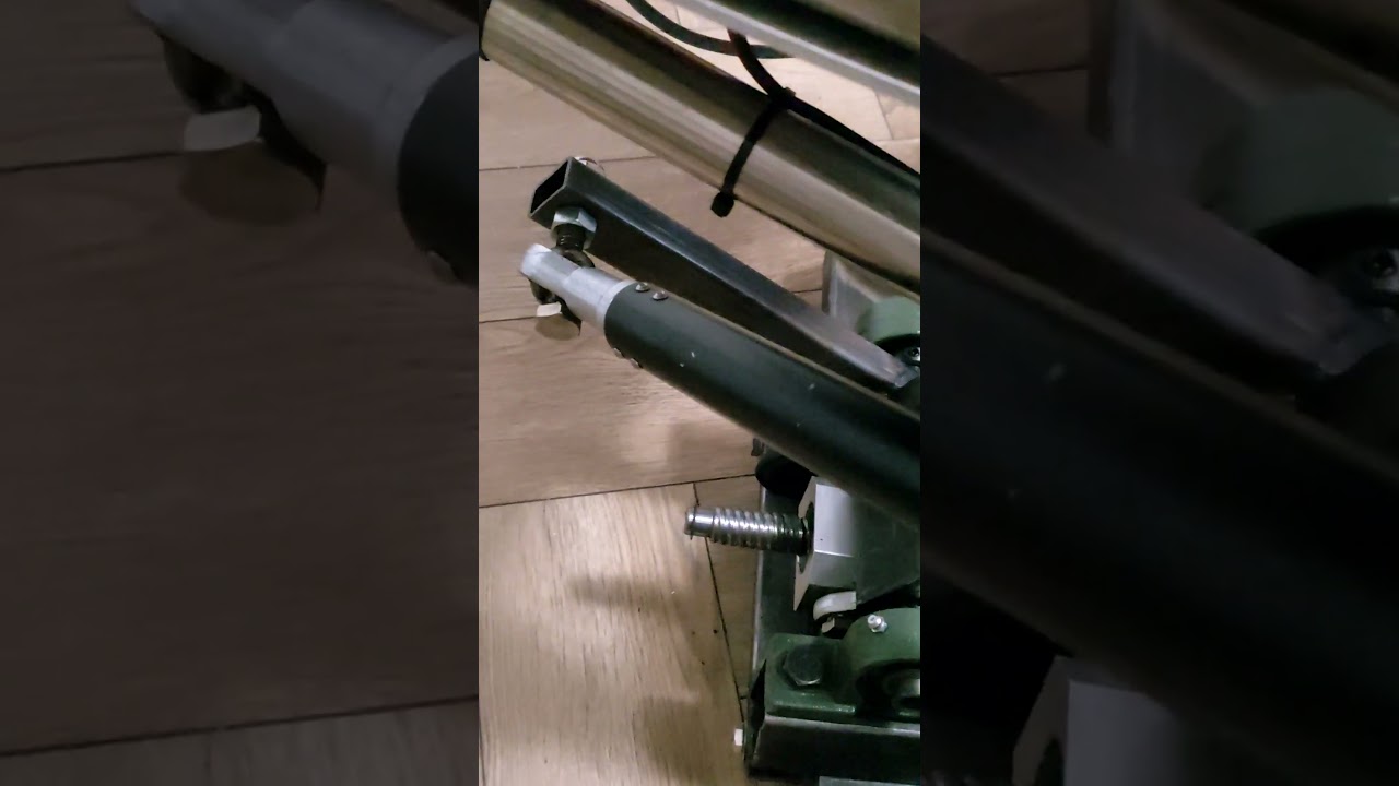

Here is down:
I don’t understand why this happens, please help me.
