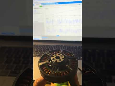

When I turn to position control, the motor is seems to be doing fine but if I use velocity mode and command it to turn at 2 rev / s, I only see live plotter at about 1 rev/s. And both velocity and current oscillate a lot.

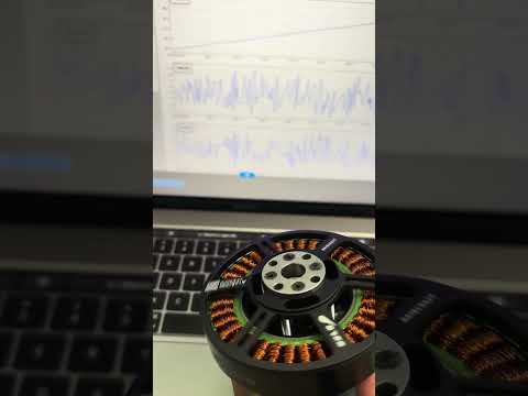

Video below for when the motor turns at 2 rev/s
In that video you were only using vel_gain – your vel_integrator_gain was zero. This is typically not enough to correct for steady-state error, can you try again but with vel_integrator_gain increased to maybe 0.5?
I tried different vel_integrator_gains unto 6.25 but the behavior is the same
