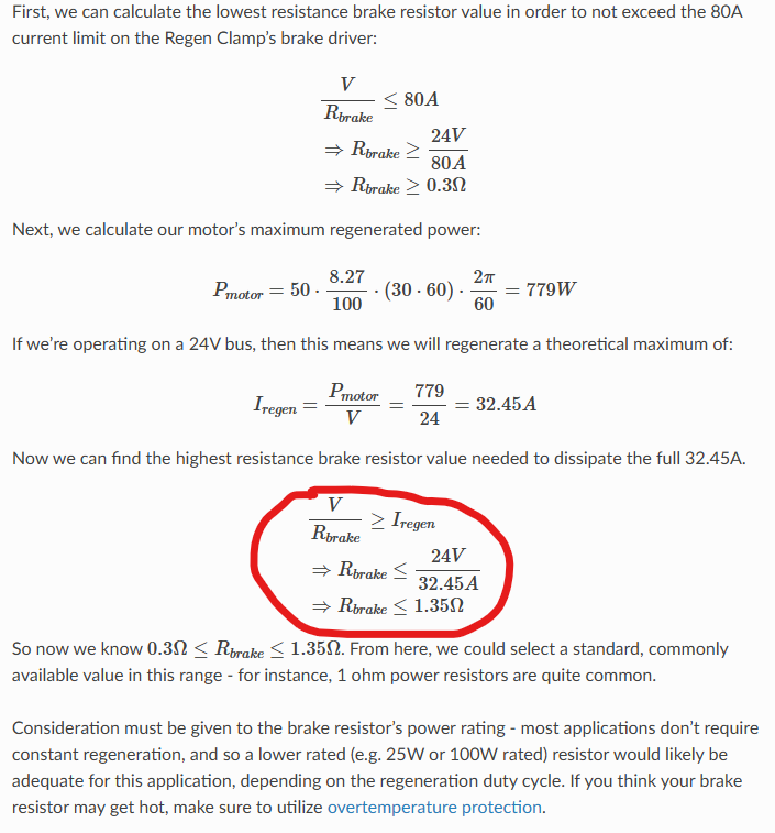

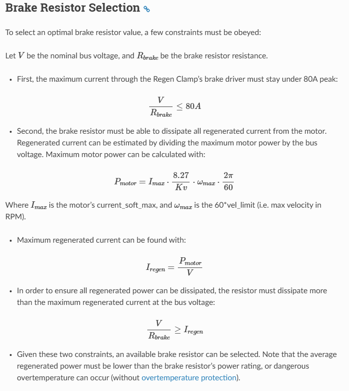

I wanted to know how I should proceed with calculating my regen clamp resistor bounds as shown below (from the regen clamp data page) using four ODrive S1 connected to four D5065 270kv respectively. It feels like I would need to multiply or divide by four somewhere but would love some guidance.
My amperage is limited by my 24VDC 40A power supply. I would like to stay below 38A while operating if possible. All of my motors will be connected to different gear boxes but my the motor with the highest RPM will be around 6000RPM. With that info, I ran through the calculations and came up with a resistor value range of 0.3Ohm <= R <= 0.788Ohm. Is this right?

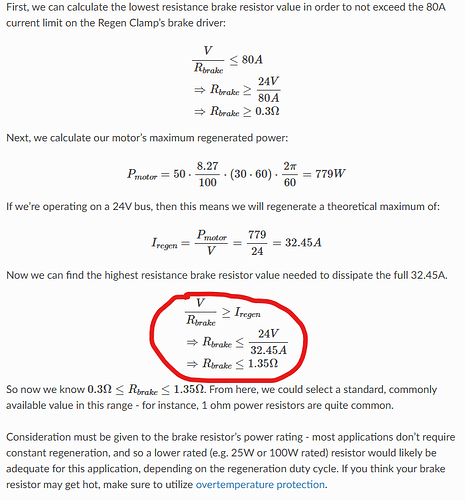

On another note, just to be thorough with my calculations, is this final step a mistake on the regen clamp datasheet page? Should it not be 0.74 Ohm for the upper bound?

Thanks for the question! Assuming the cumulative regenerated current of all four ODrives will not exceed 38A, then that would correspond to a maximum resistance of 24V/38A = 0.63 ohm. As maximum regenerated current is usually quite a bit lower than supply current (given motor efficiency/inefficiency), I think this is a safe bet. You can also limit the per-ODrive regenerated current via the active power limit feature, namely I_bus_soft_min.
And yes, you’re right – docs are wrong! I just fixed that, should update in a few minutes.

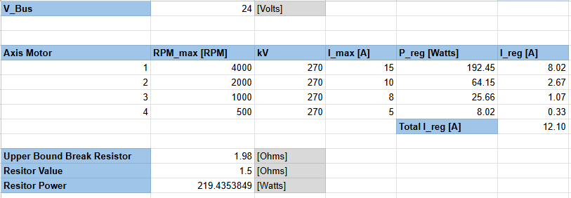

              Reran the regen clamp resistor calculations on each of my motor separately, added the results and found an upper limit for my resistor:
I think I can get away with a 1.5ohm resistor rated at 250W, specifically this one.
Let me know what you think and with your blessing I will be good to move forward. Thanks!
              Sure! I don’t see an issue at all. I’d maybe get a 1ohm just for more headroom, but I’m sure it’ll work fine

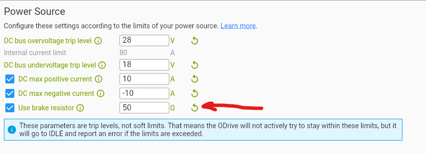

              One last question on this front. When configuring my ODrives, what break resistor value should I use? Does it have to be some fraction of the total resistance as per the maximum current that the axis should experience or is it just the 1.5ohm value for all my axis?
              If you’re not connecting the brake resistor directly to the S1, you should leave that box unchecked.
