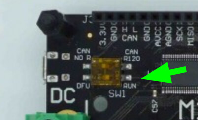

Hi everyone, I am new to these boards, and I just got a new v3.6 in and I cant get it to recognize in odrivetool. I am powering the board with a 6s lipo, and board light comes on. I have tried Zadig, and it does show up there either. I get the sound when I plug it in to my computer but it doesnt seem to find a com port. Anyone know what I might be doing wrong, or if I am missing something.
What specifically shows up in device manager when you plug it in?
I get 'STM32 BOOTLOADER" in device manager, it also show up on the list in zadig.
Sounds like the RUN/DFU switch on the board is set to DFU, try flipping it back to RUN and then power cycling the board
ok,yes, I noticed that after my last reply, I switched it and power cycle and now it is showing odrive3.6 native interface in my device manager, but now when I try odrive tool I am getting ’ [UsbDiscoverer] Failed to open USB device: -5’

I got it to connect, i had to change the cdc interface back with zadig, and changed the odrive native interface in zadig to libusb. and it is now connected. thank you,
