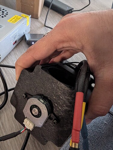

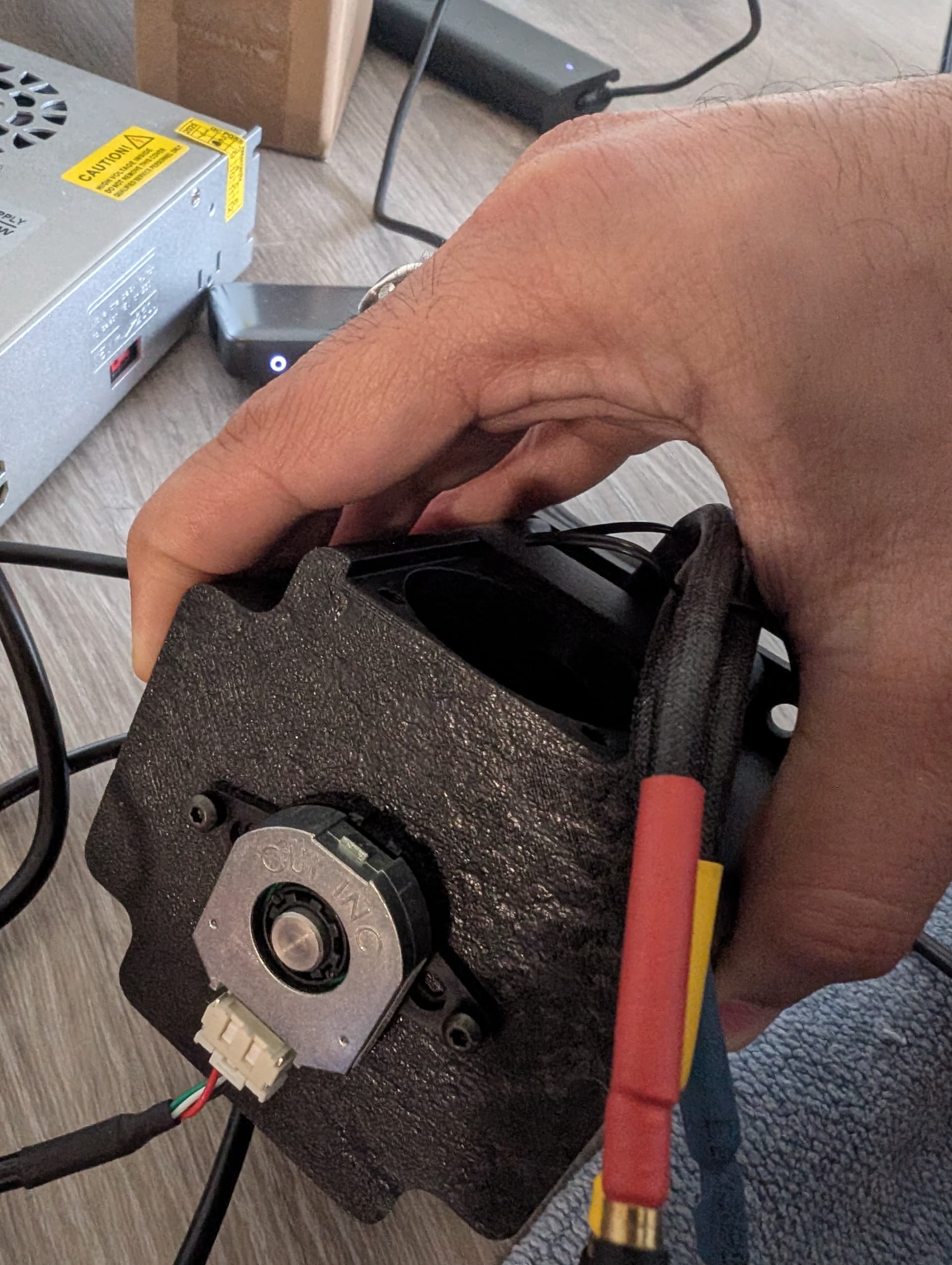

I increased the lockin current, and now it gives ‘No Response’ as procedure result. I tried different values between 10Amps and 30 Amps, it does the same. I am also adding photo of encoder setup. Its CUI-AMT212B-V-OD.

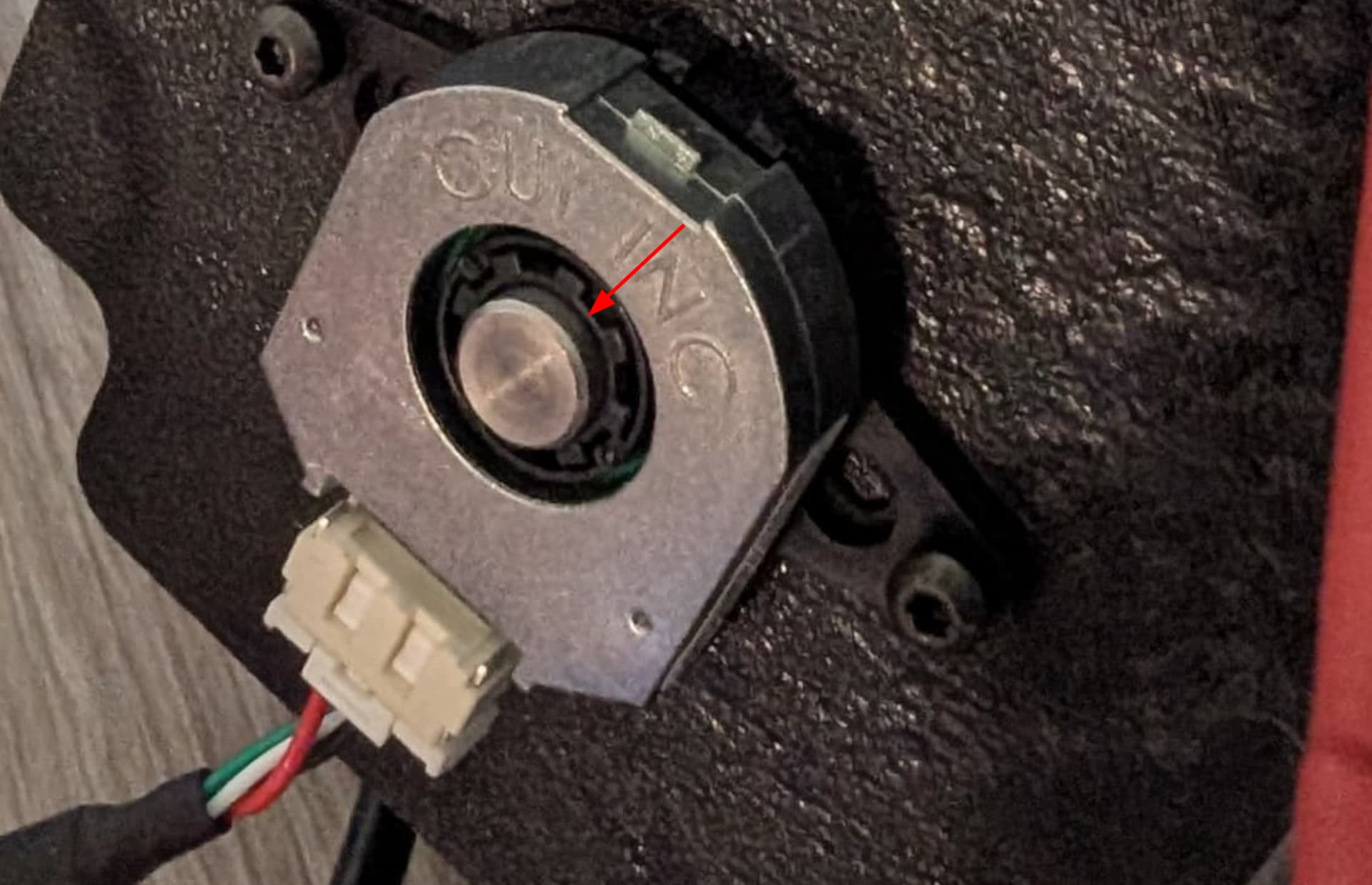

What color shaft sleeve are you using in the encoder? You should be using the blue shaft sleeve (for 8mm shaft), but I don’t see it there.
If you didn’t use that, then the encoder won’t be coupled to the shaft, so the encoder won’t move when the shaft moves. If the rs485_encoder_group0.raw is showing valid data in the GUI but you’re still getting the NO_RESPONSE error, this is likely your cause. It would also explain the POLE_PAIRS_CPR_MISMATCH error – that can also be caused by marginal encoder assembly.

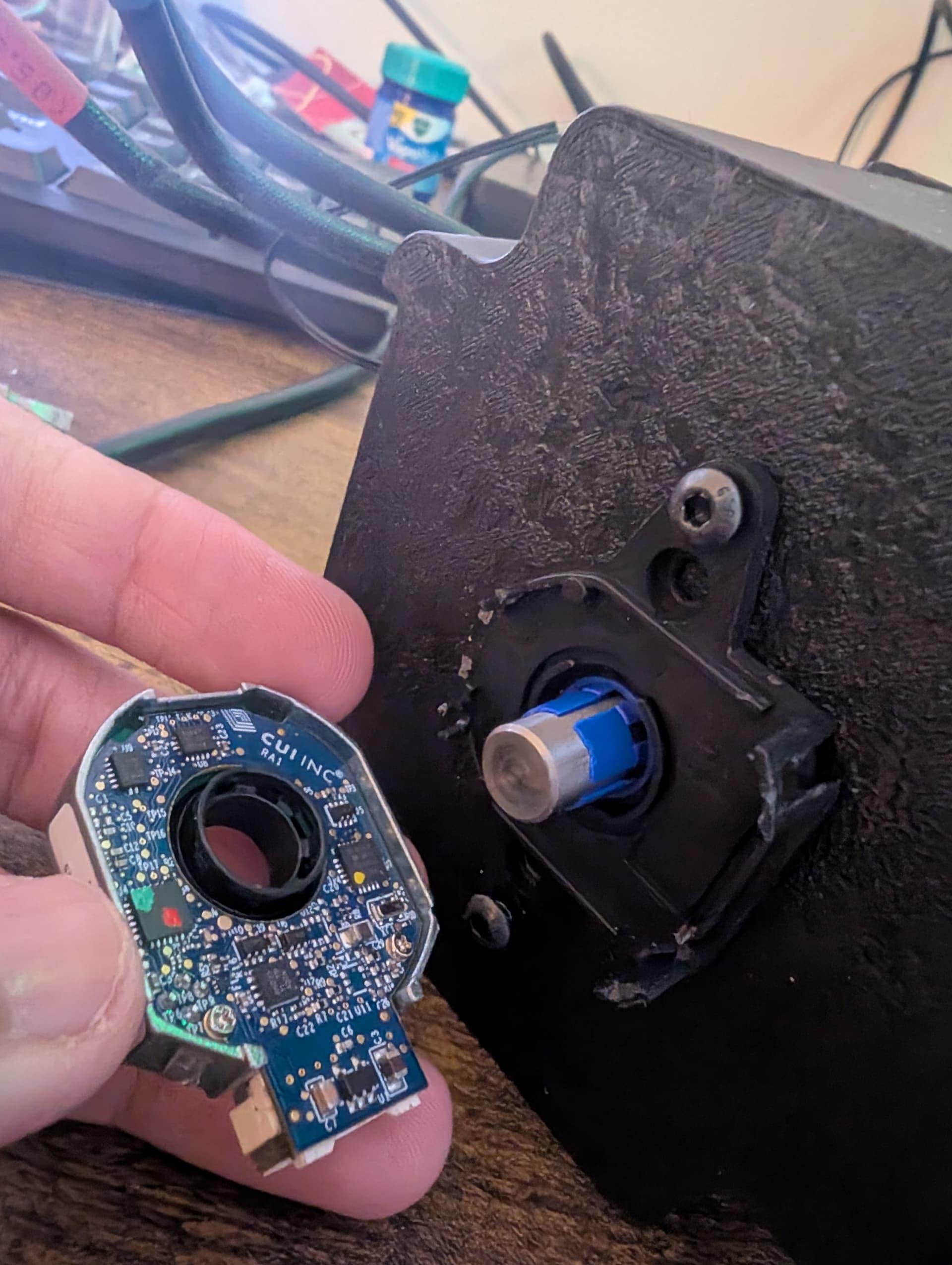

I have the blue one inside if you are referring to the one in this image

Sometimes the connectors on those encoders can be damaged by impact, and the PCB can crack. Can you verify that in the GUI rs485_encoder_group0.raw consistently outputs a number 0-1 and tracks the encoder movement, as you move the motor shaft / wiggle the encoder cable/connector/etc?
No worries. I took it apart and connected back and it works fine now. Thanks for the help.
