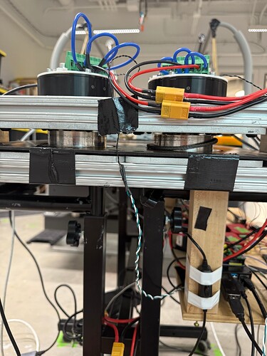

I am currently having an issue with my S1 that I suspect is a “browning out” problem. During use, sometimes connectors get jostled the wrong way which causes power to not be fully delivered via USB-C from my Raspberry Pi. This causes the ODrive to repeat the previously sent command until I kill the system with an E-Stop. The message I get in the middle of the control loop has arbitration ID 0x04, instead of 0x09, and when I try reading the message the same way I do in closed loop mode, get_encoder_estimates reads (-2.86e-42,0) for motor position and velocity (note the first number is usually just any very small number). It seems as if the motor loses itself and spins indefinitely unless I cut power myself. Upon rebooting, I check for a heartbeat and do not get one until I reset the connection between my Raspberry Pi and ODrive, the power cycling always seems to do the trick.
I try to send a message over the CAN bus, but since the connection has been effectively severed during that moment, the message is not received.

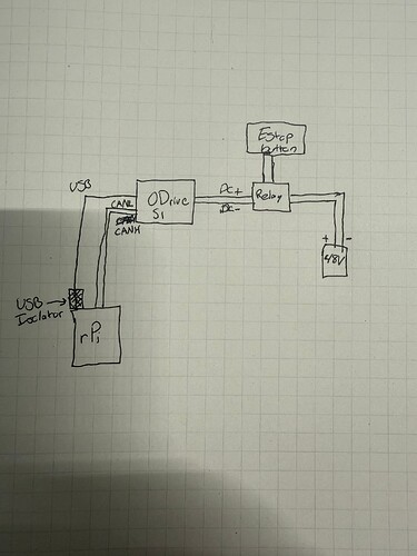

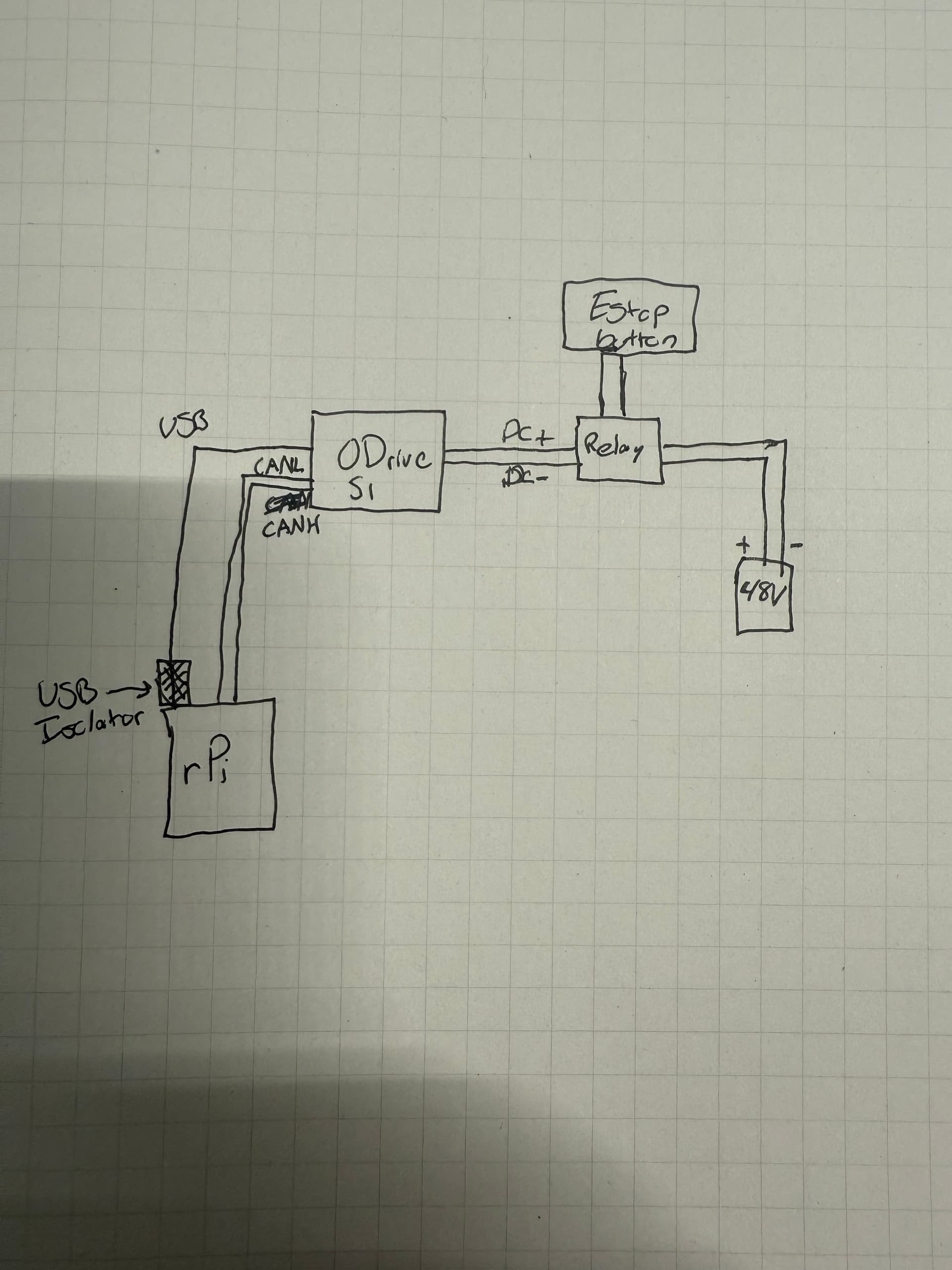

  3. I attached a drawing of the wiring because it is quite a messy setup currently so pictures do little to help. Let me know if you require more pictures and I will try to take some informative ones. The rPi is directly connected to wall power. We have the drives powered by the battery and the rPi isolated from that.

Maybe I set this up wrong, but the ODrive does not display anything from the LED unless I have the Raspberry Pi plugged into it as well. I do not see a cyan LED color when the power is being delivered to the ODrive unless the USBC is plugged into the ODrive at the same time. I power the S1s with 2 6s LiPo batteries. Any idea why this might be happening?
Yeah this is super abnormal. Do you think you might be shorting the 5V rail somehow? Does it still do this when you disconnect everything (except the power) from the S1?

That’s very strange. I think some pictures of the wiring would be very helpful. What encoder/others do you have plugged into the S1?

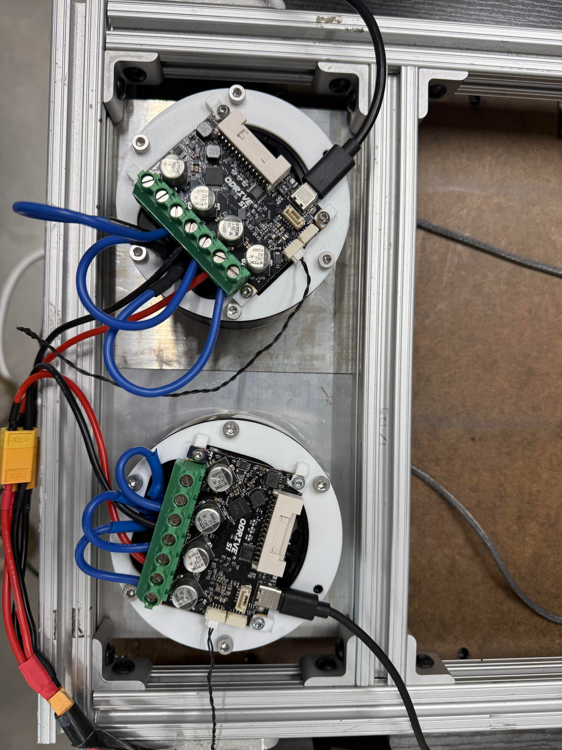

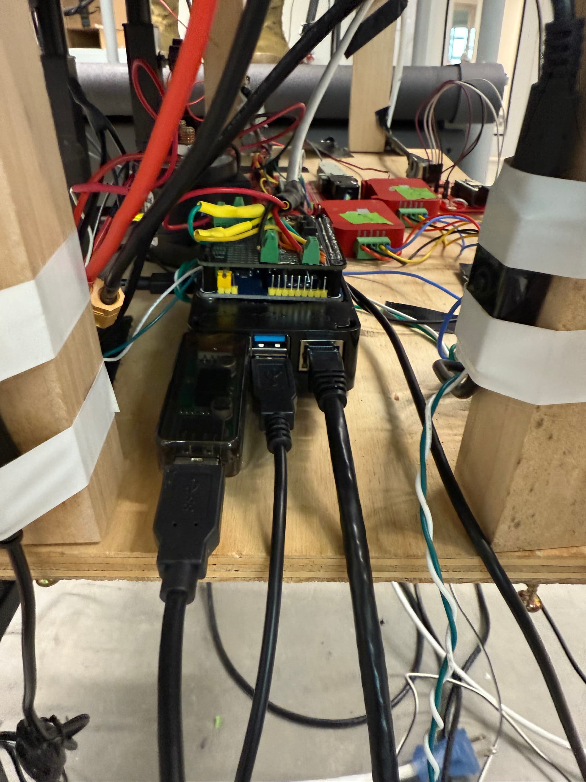

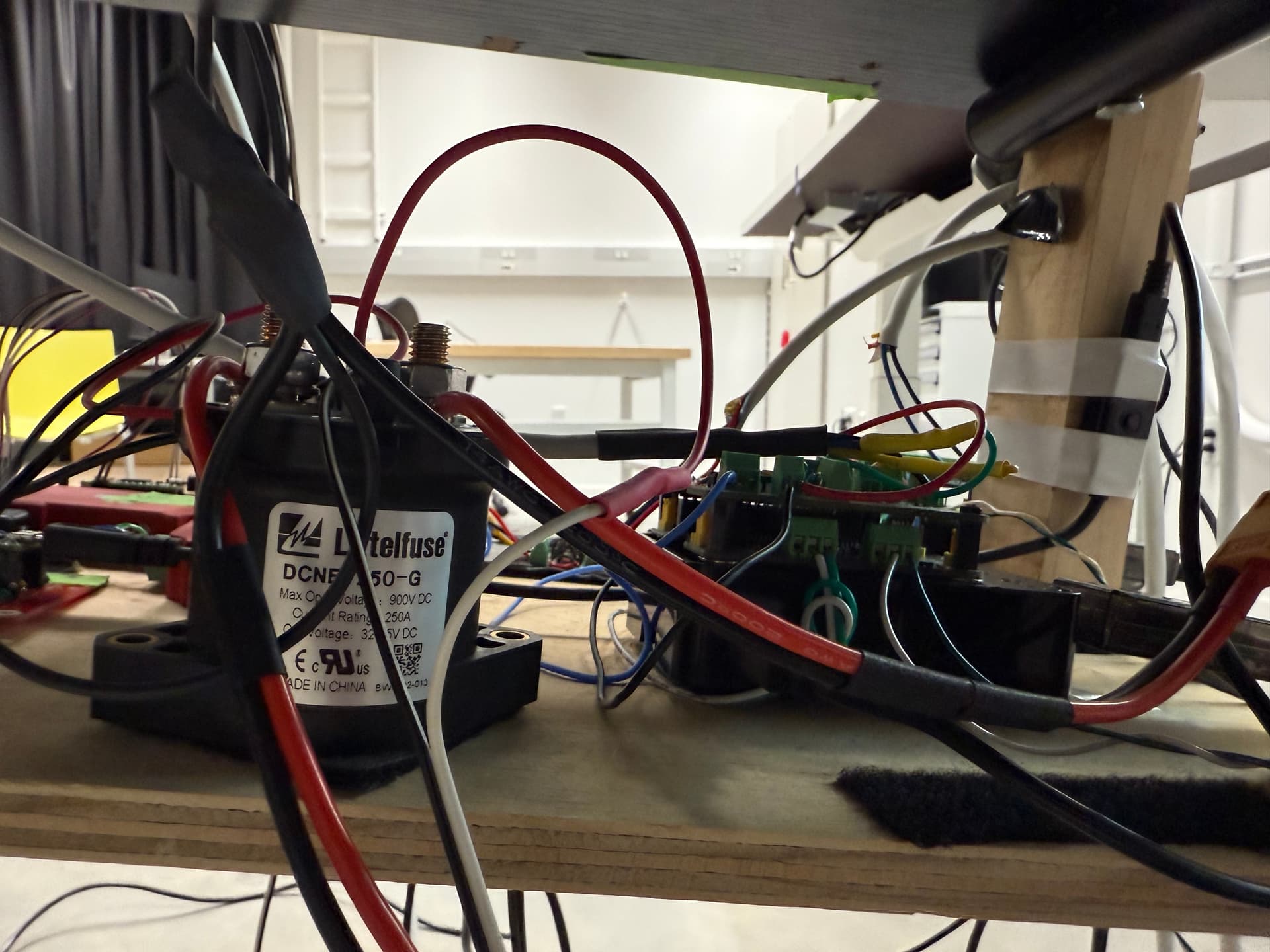

I have nothing else plugged into the S1, I use the onboard encoder and no other accessories. I attached some pictures of the setup, its a bit tough to follow but the green and white cables are the CAN wires, and then the power gets delivered through the relay from DC+ and DC- that is gated by the relay and EStop button. The other CAN connection is for intermittent messages the Pis send to each other.
EDIT: the ethernet from the Pi is to my PC so I can SSH in, and the other USB is a connection to an external microcontroller board. The ODrive is connected to the USB isolator.

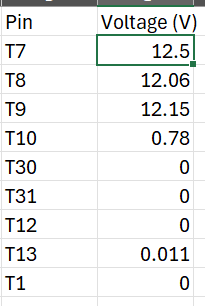

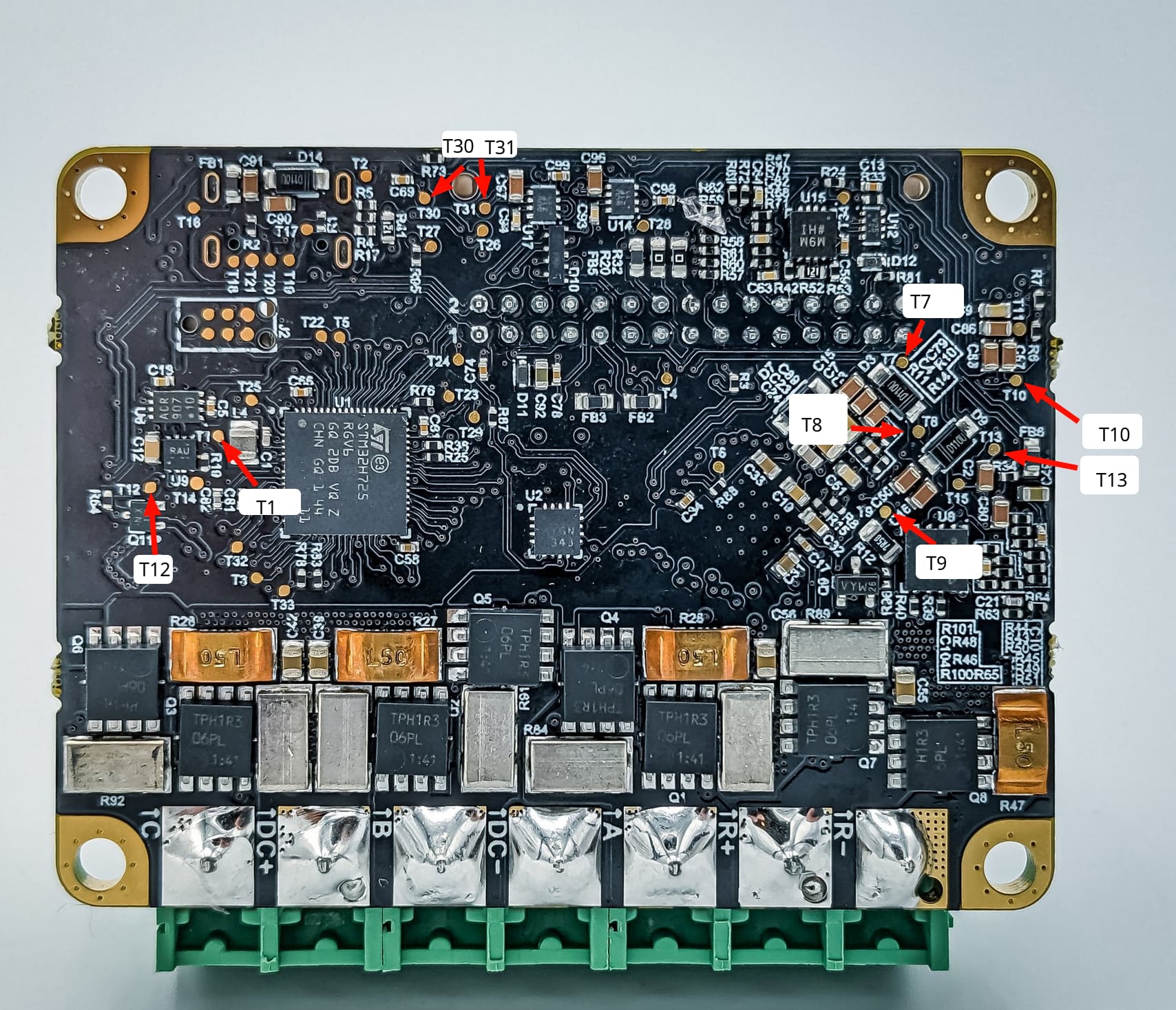

Interesting. So the only way this can happen is if you nuked the 5V logic rail somehow, but the 12V gate drive rail was still OK.
Here’s something that would be super super useful:
  • Remove the S1 from the motor, disconnect CAN and USB
  • Connect DC+/DC- directly to a bench power supply via the screw terminals (so we don’t have to worry about any soldering issues with your connectors).
  • Give it about 24V from the bench supply at some nominal safe current limit - maybe 0.1-0.5A.
  • Check what the reported current output is from the bench supply. Should be something like 0.01-0.05A.
  • Measure the following test points (on the back of the board). All measurements can be done relative to DC-
  • T7, T8, T9, T10, T30, T31, T12, T13, T1
Diagram below w/ test points marked to make it easier:
Careful when measuring the test points, they’re pretty small and you don’t want your multimeter probe to slip. Once you’ve done that, please let me know the voltage at each!

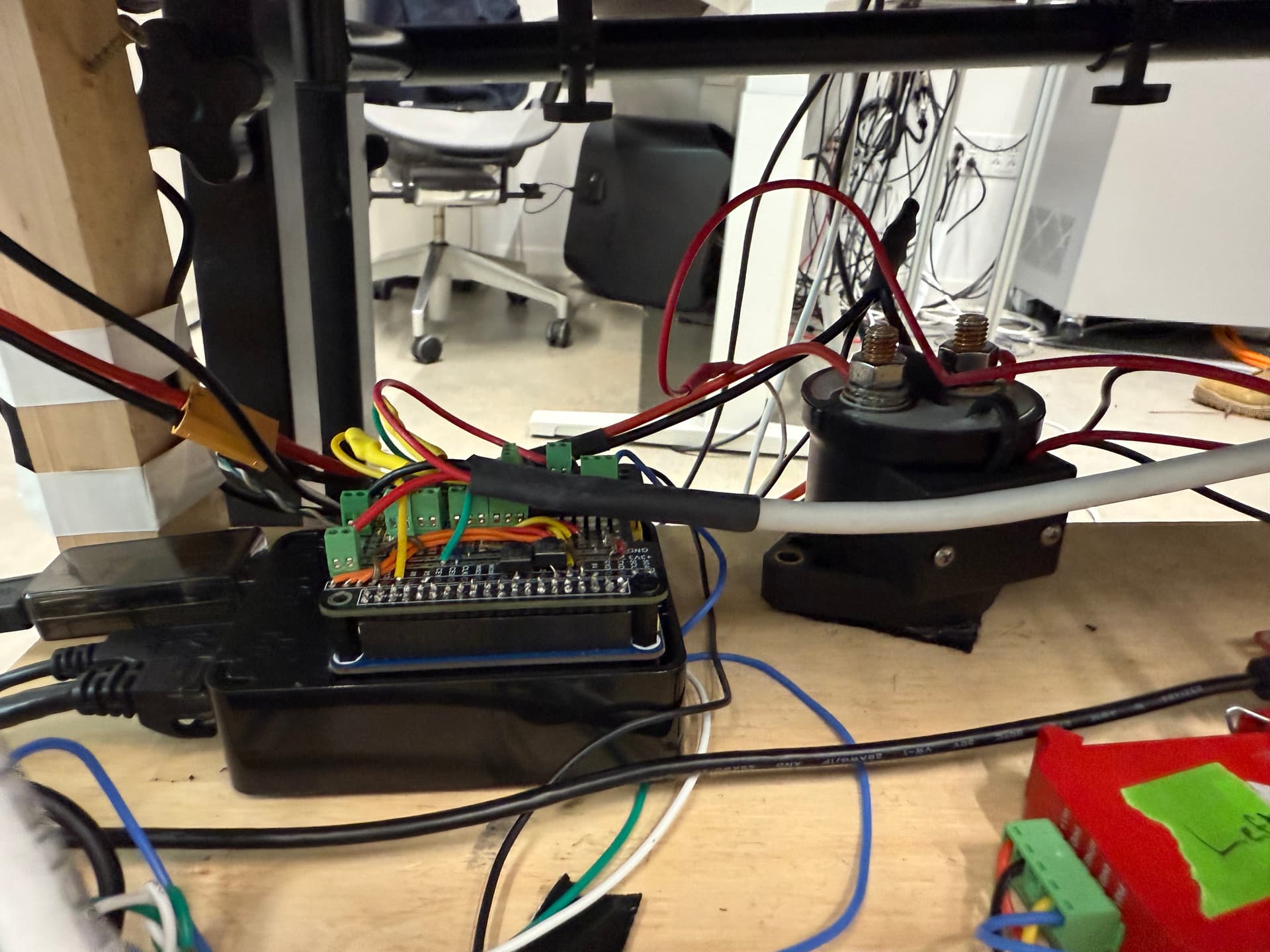

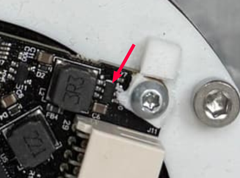

I have two concerns with what I’ve seen from your pictures:
  1. You have a piece of plastic for mounting that’s sitting directly on top of the 5V regulator, marked with an arrow. This definitely makes me suspect mechanical damage.
  2. As far as I can tell, you don’t have any precharge or soft-start circuit. This means that whenever your contactor closes (connects), you’re slamming the S1s with your full bus voltage. That causes a massive inrush current, and can spike the input voltage really high (I’ve seen to 80-90V from a 48V supply with uncontrolled inrush), and cause damage. I would strongly recommend adding a second relay/contactor in parallel with the main bus one, with a ~1-2ohm resistor across it – this way when powering on the system, you can close the precharge contactor for a second or two before closing the main contactor, so that the bus voltage at the S1s can safely ramp up with managed inrush current.

Tested! Here are the results. The lack of 5V makes me think that the regulator is damaged.
I appreciate the advice about implementing a soft start circuit. I will look into adding one in to avoid this issue in the future with other drives. I am not sure if it was mechanical damage that caused this or something else, but better safe than sorry!

T7: 12V output from DC+ → 12V step-down
T8: Filtered 12V supply for system power
T9: Filtered 12V supply for gate drive power (for the inverter)
T10: 5V rail for internal power
T30: 5V rail for external power
T31: 3.3V rail for external power
T12: 3.3V rail for internal power
T13: 3.3V analog rail
T1: ~1.8V rail for microcontroller power.
So it definitely looks like there’s something blown with the 12V->5V step-down, which is why the S1 only works with the external USB supply (which also feeds 5V)

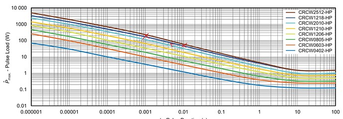

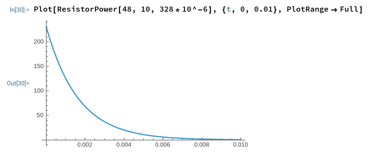

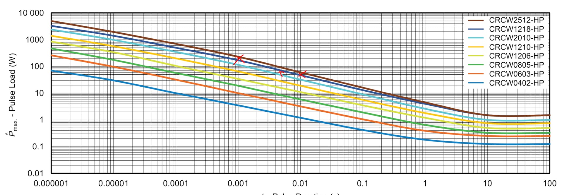

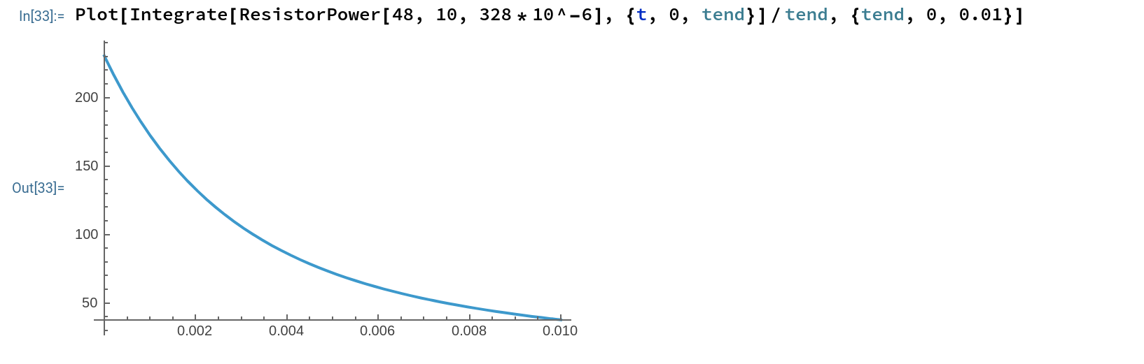

EDIT2: Assuming the worst case, what wattage resistor should I be looking at for the soft start? Most datasheets report continuous, unsure of what peaks they can handle.
It really depends. You can calculate the total energy of the precharge pulse, and compare to the resistor’s short term overload rating. For instance, a 10-ohm resistor from a 48V supply into a single S1 (328uF capacitance) will result in a voltage curve across the resistor of V e^(-t / RC) == 48 e^(-t / 10 * 328e-6), and thus a power curve (given P = V^2 / R) of (48 e^(-t / 10 * 328e-6))^2 / 10. If you integrate this, you get about 0.377 joules, across about 10ms:
And then an average pulse power curve (y axis is watts, x axis is integration time) of this:
So that’s about 175W average across 1ms, 75W average across 5ms, and about 50W average across 10ms.
Looking at the single pulse rating in the datasheet for the Vishay CRCW-HP series (which is a pulse rated resistor), we can mark these points (175W @ 1ms, 75W @ 5ms, 50W @ 10ms), and see that it’s all within the curve for the CRCW2512-HP
So even a small (pulse rated!) resistor like the CRCW251210R0FKEGHP will work just fine here. And I think you’d be totally fine also with something like a wirewound resistor, even though it’s not specifically pulse rated.
