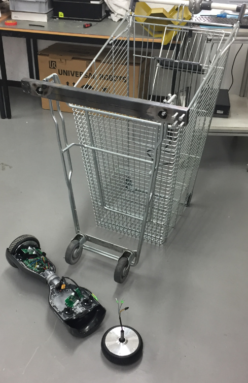

The shopping trolley demo is great.
excellent! i think i need to steal one of these trolleys and do that demo.
could u document the motors (looks like overboard motors) & battery specs please?
I just used “standard” hoverboard motors and 2x 5S lipo batteries in series. Specifically it was this wheel and these batteries, but many similar ones exist.
I just coudln’t resist… hack in progress :smiley:
