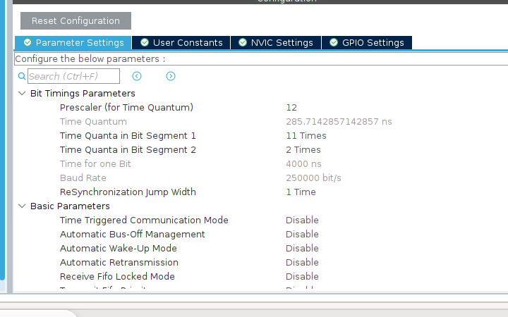

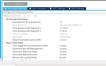

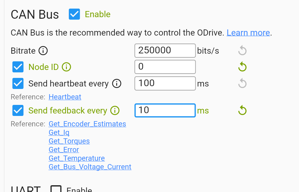

What CAN bit timing parameters are you using? I like this calculator: http://www.bittiming.can-wiki.info/
Do you have an external USB-CAN dongle you can use to verify the F4 is sending messages correctly?
The parameters look like this
I have a USB Type-C CAN cable, it should work.
Amazon link
I think that CAN timing looks correct. I would definitely use the USB-CAN adapter to look at the raw packets being sent – if you can show me those, it should really help with diagnosing.

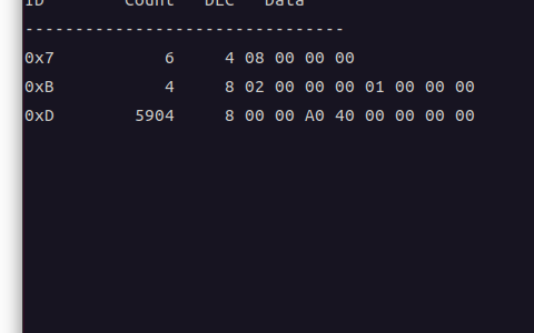

CAN messages were sent and received! Sending a speed-controlled message
I can’t get out of idle mode even after connecting. Please help.

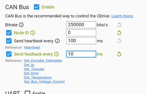

Are you able to receive heartbeat messages from the ODrive? It’s worth enabling those and verifying you can get them.

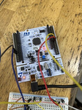

It seems like it’s not receiving properly.

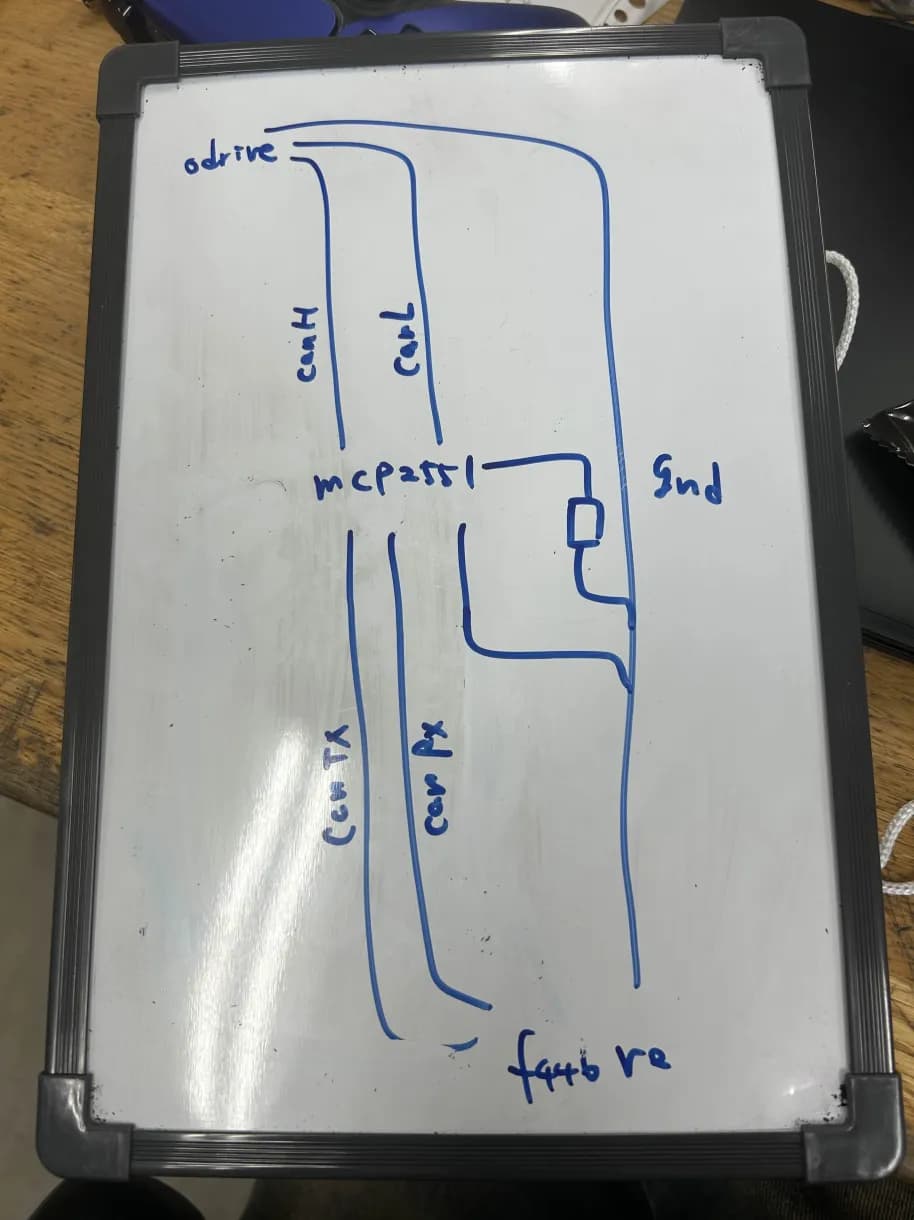

Are there any other settings I need to do besides turning it on and connecting it to the microcontroller via canbus?

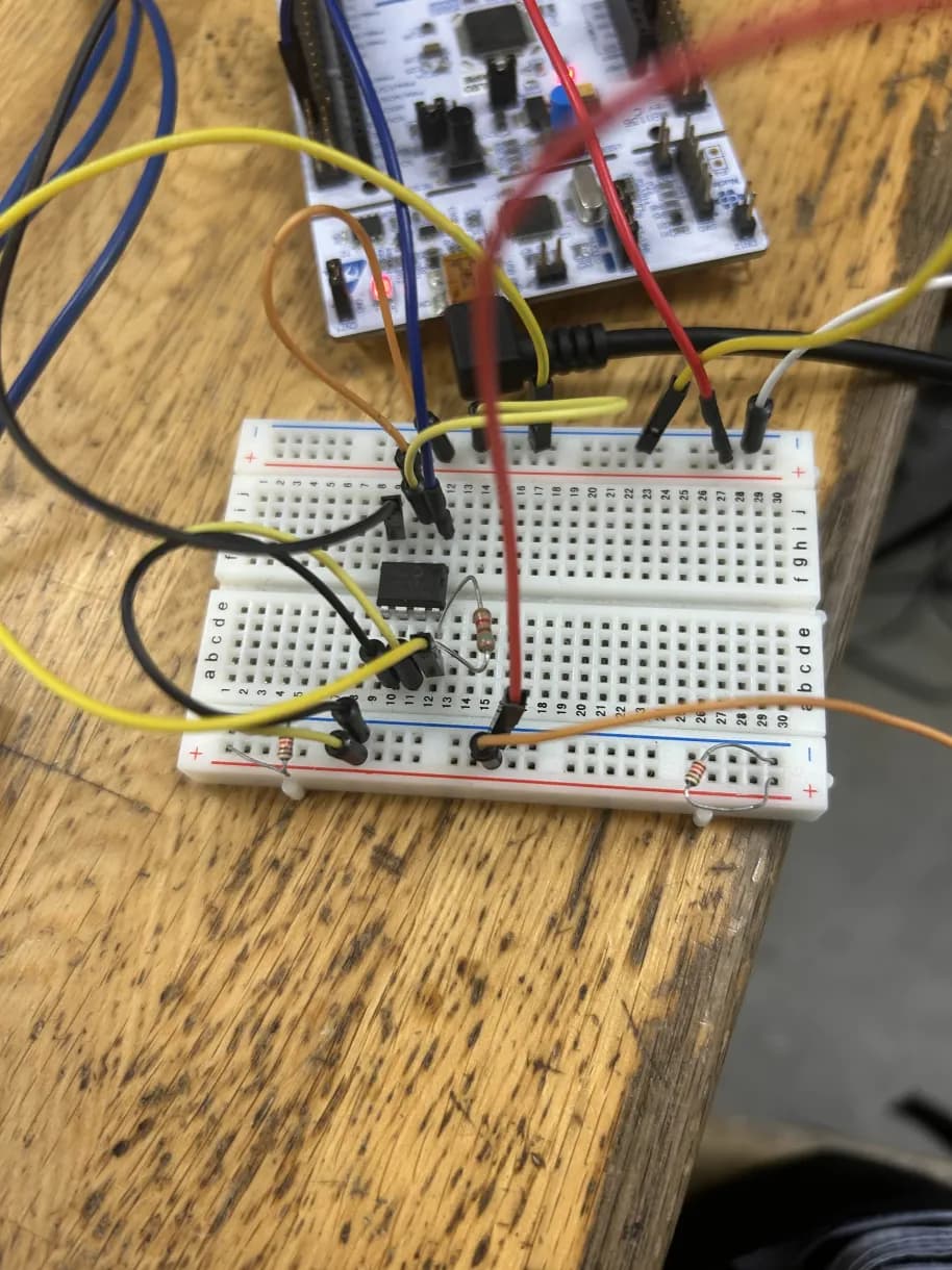

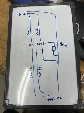

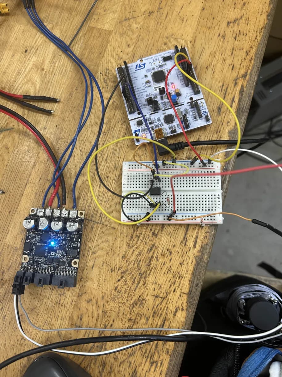

Perhaps it’s a grounding issue? Could you show some pictures of your wiring?
ODrive Pro needs a ground tie between CAN_GND and DC-, see: CAN Bus Guide — ODrive Documentation 0.6.11 documentation. That’s likely your issue here.
After correcting the wiring and checking the baud rate in the ODrive web GUI, I found that even though it was set to 250,000, it was still 1 Mbps, so I adjusted the microcontroller and it worked.
Thank you so much!!!

Can you show the exact messages you’re sending as a result of Set_Controller_Modes and Set_Axis_Requested_State?
This is the result received by the can receiving module.
can0  00B   [8]  02 00 00 00 01 00 00 00
can0  007   [4]  08 00 00 00
