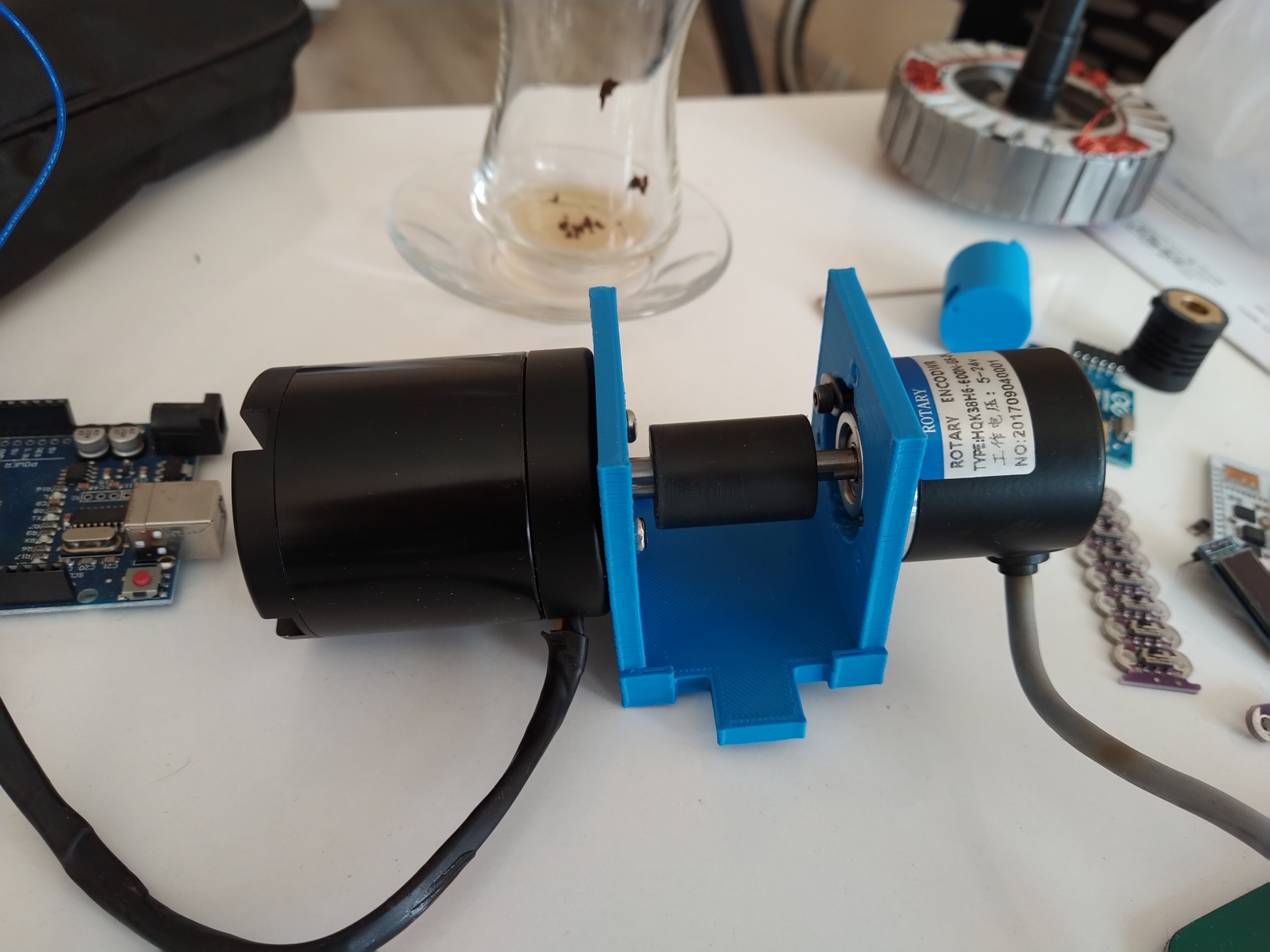

Odrive stops working
i have 3.5 odrive with latest firmware
Full Calibration is ok motor moves cw and ccw closed loop is ok holding the motor
No dumb errors
when i sent a position command motor turns
After that odrive cant recognize commands.i cant send a new postion or calibration command
İ need to reconnect the battery
Any ideas?
Thanks

Hi again,
Now i command dump_errors(odrv0) i got below errors
i read error flags on documents but cant understand.
What do you think?
thanks
axis0
axis: Error(s):
AXIS_ERROR_CONTROLLER_FAILED
motor: Error(s):
MOTOR_ERROR_CONTROL_DEADLINE_MISSED
fet_thermistor: no error
motor_thermistor: no error
encoder: no error
controller: Error(s):
CONTROLLER_ERROR_OVERSPEED
axis1
axis: no error
motor: no error
encoder: no error
controller: no error
You just need to increase your controller.config.vel_limit or vel_limit_tolerance (OVERSPEED)
