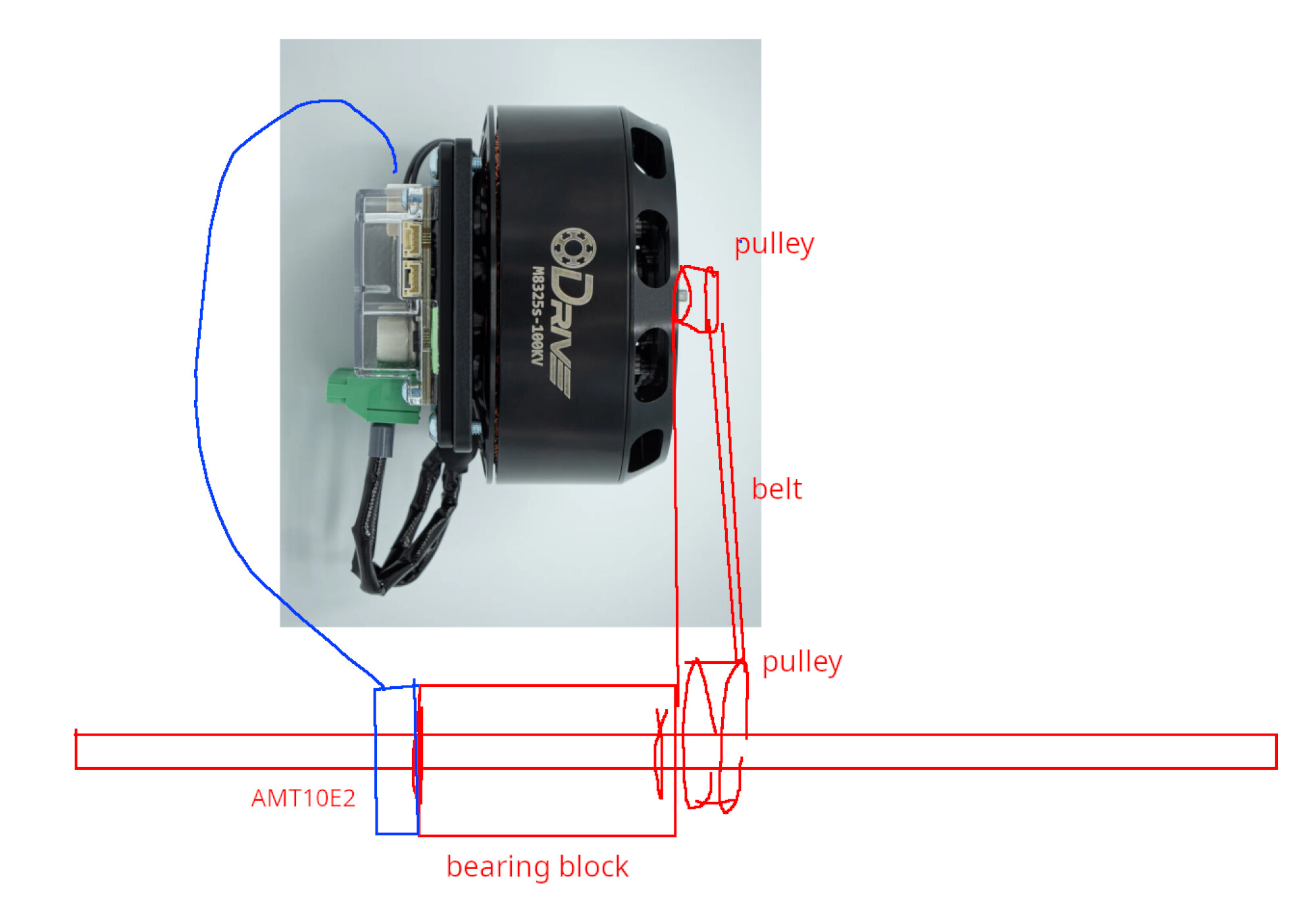

Lots of text, apologies. To sum it up, I think 5Nm continuous, especially from an S1, is going to be quite tricky. The good news is that 200W is quite low power, all things considered. I think you could move this from “tricky” to “trivial” with a simple design change to add a belt reduction; e.g. a S1+M8325s kit plus a 2:1 belt reduction would get you an easy/comfortable 6.6Nm holding torque at up to ~800 RPM at 24V. And you could use an AMT10E2 for the output shaft, getting super nice high resolution torque and pos/vel control/sensing. Something like this (apologies for the shitty diagram):

Of course, this would be pretty big, and it’s a lot more speed than you need, but smaller motors will need a larger reduction. If you can make that AKE60-8 work for your application, I think that’s maybe what I’d consider pursuing, since it’s designed for torque transparency.

I am leaning towards a belt reduction option which will simplify motor selection but might also yield some other advantages for my application.
If use the odrive built in encoder on the motor side and use the AMT10e-v on the shaft side, I would have more data to work with to calculate shaft torque by comparing the 2 in real time.
Given my primary goal is to map torque on the output shaft as accurately as possible, I think this would be a good solution and can still make use of the micro.
My main concern here is that 5Nm @ 400RPM is 210W, which is more than the Micro’s max peak output power at 24V (7A * 24V = 168W) – and note continuous output is around 80-100W.
Having the encoder on the output shaft is really great, it’s also not going to help too much with torque estimation unless you can really accurately characterize the belt deflection under load.
My recommendation would be to use an S1 with a low cogging torque motor, with as small of a belt reduction as you can get. You should be able to get pretty darn good torque estimation, and if you need more then you can consider adding a torque transducer between the motor output and the belt pulley, or using a spring between the motor and belt pulley and comparing the motor output position and AMT10E2 position to calculate the torque – this is what’s done in a lot of higher end robotics (called a series elastic actuator).
I think if you can fit the S1+M8325s + a 2:1 belt reduction, that’s likely the best option here from a price and ease perspective.
