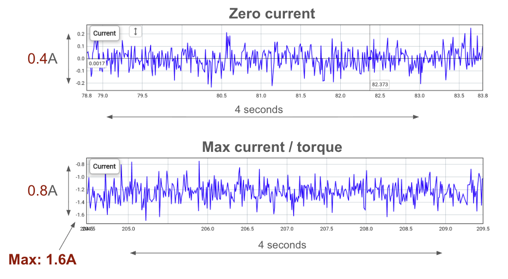

I’m using an ODrive S1 with a small Steadywin PM1806 motor and an AS5048A encoder.
I was able to get everything working through the GUI and odrivetools, including calibration, position control, UART communication, and CAN communication.
My goal was to use the motor in torque/current control mode, but I found that the current measurement (and thus the estimated torque) looks quite noisy. Since the motor’s maximum current is only about ±1.5 A, I was surprised by the size of the observed error.

  1. First, the GUI samples much slower than the actual ODrive loop frequency. Onboard, the current noise is more of a gaussian noise / pink noise, which results in little to no increase in power dissipation or actual meaningful torque noise (given motor inertia) – however the GUI samples slow enough that it looks all weird and error-filled. However the noise spectra does reduce the current control fidelity.
  2. The S1 definitely has a good amount of current noise, it’s optimized for higher current motors in general, where ~100mA 3sigma noise isn’t noticeable. The ODrive Micro may be a better solution for your motor – the micro has about 1-2 orders of magnitude less current noise than the S1/Pro
  3. You’re also seeing encoder noise in there, since the encoder estimator and current controllers are intrinsically coupled. And the AS5048 is a noisy encoder.

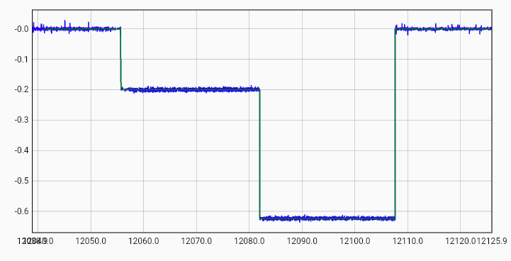

Switching to a high-current motor setup didn’t help—in fact, it made things even more jittery.
But then I tried an ODrive Micro (which I’d ordered a few weeks ago), and it worked like magic! I had originally thought the S1 would be the more stable choice since it’s been around longer, but as you mentioned, it’s probably tuned for much more powerful motors. The Micro seems like the right fit for this small motor. On top of that, I can now access iq_setpoint—two birds with one stone. :wink:
