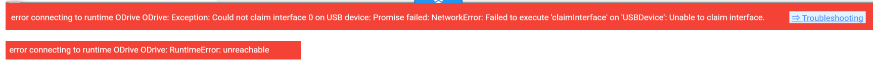

I’m trying to control ODrive through WEB Gui but I’m receiving the following errors:
Edit: Resolved by downloading Zadig and replacing drivers
Keeping post up for anyone who needs to fix “could not claim interface on USB device” errors or “RuntimeError unreachable”
