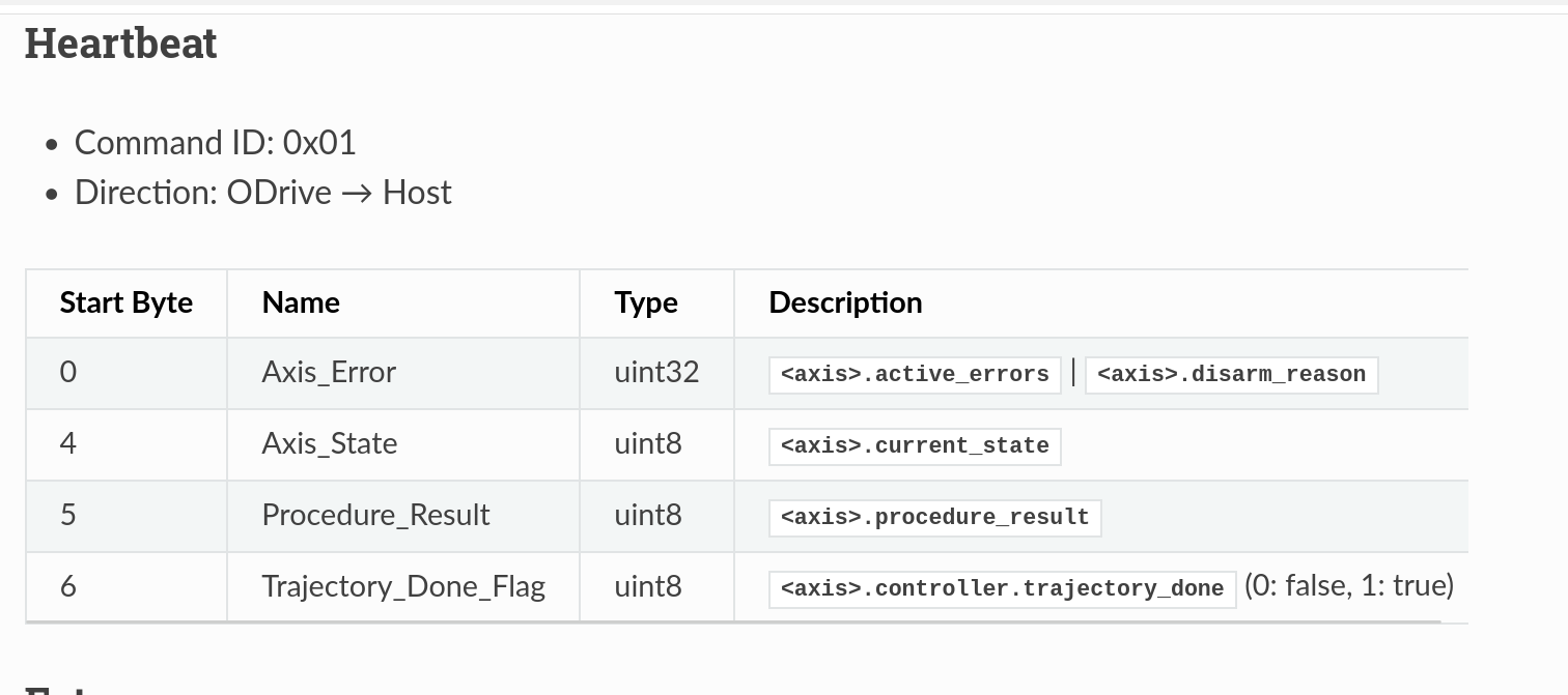

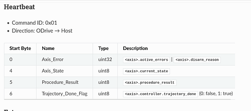

However, if we look at the heartbeat message from node 1 again, we can see the data payload is:
00 00 00 00 01 0E 01 00, corresponding to this mapping:
Here, it looks like procedure_result is 0x0E, and if we look at the procedure_result enum then we can see that this corresponds to the NOT_CALIBRATED error.
So my best guess is either:
- You haven’t fully set up the ODrives in the GUI (e.g. run through all the steps in the final configuration tab, where you apply settings and then run calibration then save the config
or
- You’re using an incremental encoder, or an incremental encoder with index, both which requires some action to be taken before you can enter closed loop (encoder offset calibration and index search, respectively).
The can_simple.py script generally assumes your ODrives are already calibrated/tuned, and can safely be put in closed loop velocity mode. If you want an example for how to run calibration over CAN bus, you can check out can_calibrate.py.
