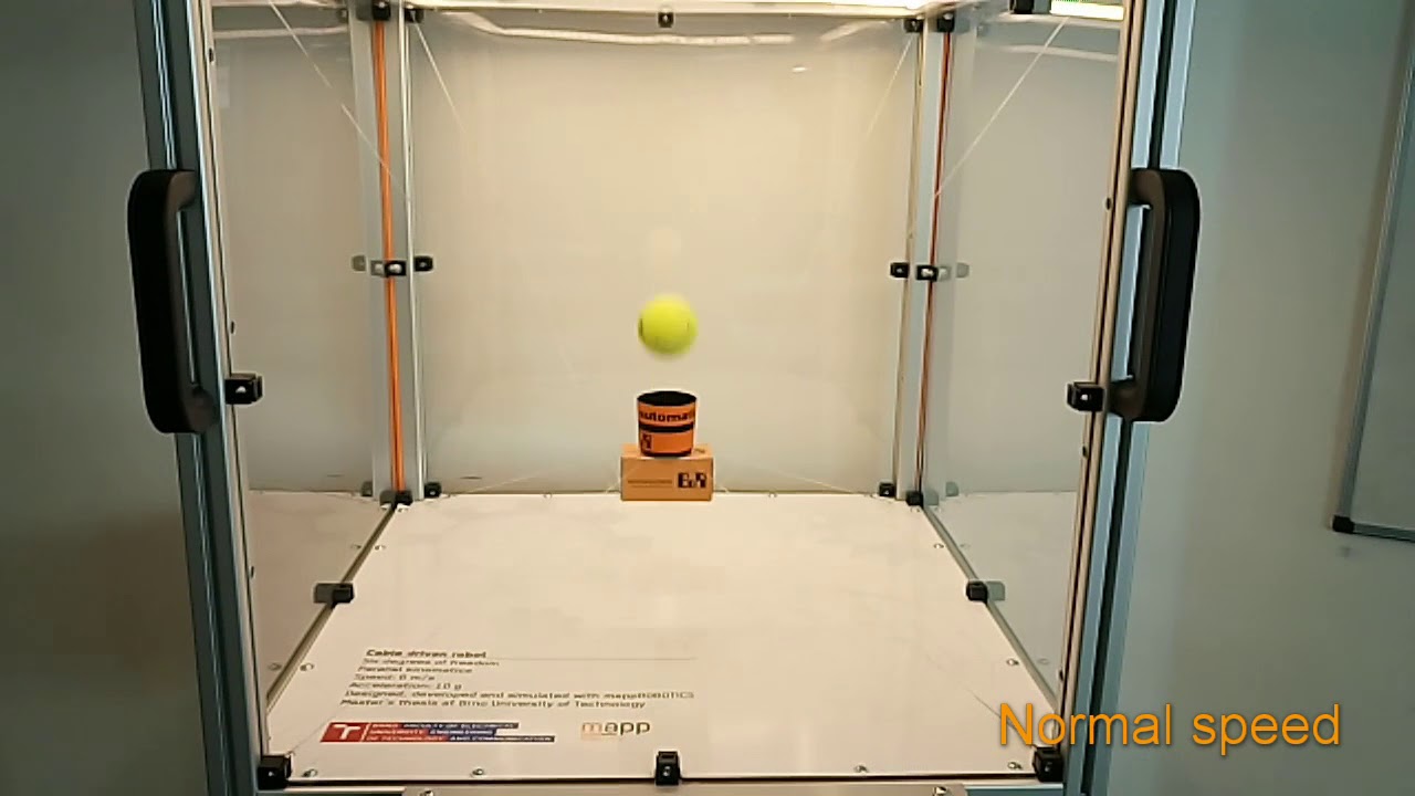

I have been looking at the string actuated robot for some time, the video in your link looks has no kinetic control, which effects vibration on the string.
you can use 8 motors for 6-degree movement control or 4 motors for 3-degree control.
and github has a working matlab model you can try:

Thank you Einzeln, this is very interesting but using the extra strings from the bottom is not practical for my application, but I guess this system can work, the extra vibration can be minimize with a gimbal.
this project is a huge undertaking, you will need some fat budget to do this.
Hi Einzeln, not sure what you mean by fat budget, this guy has a solution with more than what I need for around $300, my problem is that I’m new to robotics and have no clue how to get what Torbjorn has done and modified to my needs. It will be fun to learn.
A four motor setup with matlab/simulink industrial motor/controller setup from Omron costs 3000USD, not to say alone the proper trained technical personnel and control algorithm programmers.
in the video they used a Marlin based firmware with modified IK to run the G-code for printing. You have a good sense to simplify your problem, but with a camera with proper stabilization, it will be more complicated. when the space you need to cover become huge.
