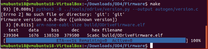

I wanted to still compile Odrive 0.4, so I did not follow the hidden github developer guide for 0.5.1
So I followed the one linked from the main blog site.
Therefore, now, I followed your link to the github developer guide and re-installed everything in the Linux (ubuntu <20.04 )
Tom, this is the result. and I am sooooooo sooooooo happy :slight_smile:
THANKYOU !!
