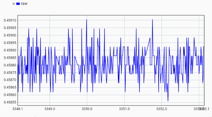

When inspecting the raw encoder signal (motor at rest and disabled), I see some noise (attached plot). I’m not sure if this level of noise is considered normal.
Yeah, this level of noise is pretty normal. Magnetic encoders are intrinsically a bit noisy – the one we use onboard the S1 (MA702) has about 0.03° of RMS noise, eyeballing that plot you’re seeing exactly that. The GUI also samples a lot slower than the ODrive’s onboard loops, so there’s a good bit of aliasing. There’s also filtering (the encoder estimator) between the encoder’s raw value and the actual ODrive’s internal position count (axis0.pos_estimate).
