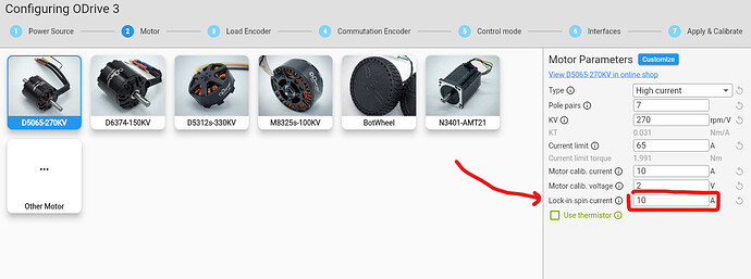

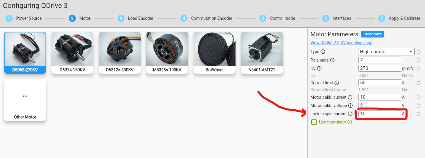

  2. Seems like you’re using the D5065 270KV from our shop, but your calibration_lockin.current is really low – you should bump this to around the motor’s max continuous current (about 40-45A) for more accurate calibration

  2. I used the default value given for the motor and I thought that would be all good. I will set this higher - probably try 20A and move up if that doesn’t work since I don’t want to fry the ODrive if it is too high. What is interesting is that I have calibrated another D5065 the exact same way I did for this one and it all worked exactly as I had intended. Weird that this one is acting up but this is still worth a shot.

I will try changing the lock-in spin current for calibration and update my script and see where that gets me.

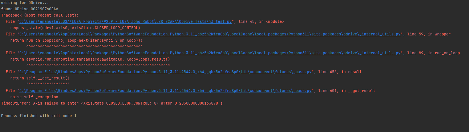

When I ran the script with the suggested changes I got these errors after ENCODER_OFFSET_CALIBRATION was complete:
Just to reiterate, I am able to go into velocity and torque control modes, just not position control.
Could also be just due to different load on the motor. No worries on frying the ODrive – it’ll self-limit current if it gets too hot! Even without a heatspreader plate or any sort of thermal management (just bare PCB), 20-30A is just fine.

Very much depends. If you crank calibration_lockin.current it should help a lot. What sorts of loads are we talking about / what’s the robot?
The robot is a SCARA style robot similar to the YK-XG from Yamaha.
Our J1 has a 100:1 gear ration and J2 is at 20:1. For loads, do you want the moment of inertia of the associated linkages?
Ah gotcha. So you don’t have any “biased” loads in one direction or another, which is good – those are what throw off calibration (e.g. a robot arm joint that’s subject to gravity – more load torque in one direction than another). I’d say to set calibration_lockin.current to the aforementioned 40-45A, and then maybe increase calib_scan_distance to 16 or so to increase the distance the ODrive moves the motor for calibration (which can also help).
Cool cool.
I was trying to increase the lock-in current but I could only for up to 35A. I think my soft/hard current limits are too small because I kept getting overcurrent errors.
I will definitely try increasing the scan distance next week when I get back to the lab.
Will keep you posted
Cool! If you still have ibus hard/soft min/max limits of -5/5, I’d say bump the I_bus_hard_max to maybe 2x of the soft max (and ditto with hard/soft min), it’s probably getting some brief transients that violate the hard max – you always need some margin there.
