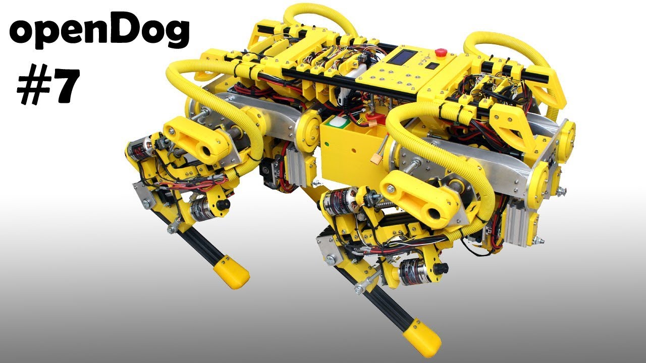

Are you saying you want to use something different than an arduino or teensy?
With either, you would be able to control multiple odrives at a time.
Check the link below for how he combines odrive with arduinos.
