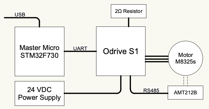

I’m trying to get a custom STM32F730 PCB to talk to my S1 controller, but it seems to be ignoring the data. The S1 is running the latest firmware 0.6.10 and seems to respond to orivetool commands via USB.

My UART interface is as follows:
Tx out from STM32 board goes to pin 8 of J11
Rx In from STM32 board goes to pin 7 of J11
+3.3 VDC goes to pin 9 of J11
GND goes to pin 10 f J11.
I am thinking that the physical connection and timing are correct, but suspect that the semantics for my commands are wrong. I’ve also tried replacing axis0 with odrv0 (as well as 1 for both cases).

I agree, w axis0.requested_state 7\r\n should result in putting the ODrive in ENCODER_OFFSET_CALIBRATION. However, the ODrive may be experiencing another error (whether operating or configuration) that prevents it from entering this state. Are you able to configure and run it via ODrivetool or the GUI? Can you share any errors that the ODrive returns, via either dump_errors(odrv0) or the status readout in the GUI (bottom left corner)?
As well, can you share the other calibration and configuration you’ve done on the ODrive? I’m assuming you’ve already set up the motor and encoder configuration, and done motor calibration.
The errors I get are:
THERMISTER.DISCONNECTED
ProcedureResult.NOT.CALIBRATED
I don’t think the thermister is the issue, but maybe I am missing a step with setup?
THERMISTOR_DISCONNECTED means you enabled the thermistor in your configuration but one’s not connected properly. Could you share your wiring and your entire configuration?
Isn’t the thermister internal on the S1?
I wanted to add, I really appreciate you taking the time to help me.
So, disabling the thermister did the trick. I can now control the unit via the UART.
