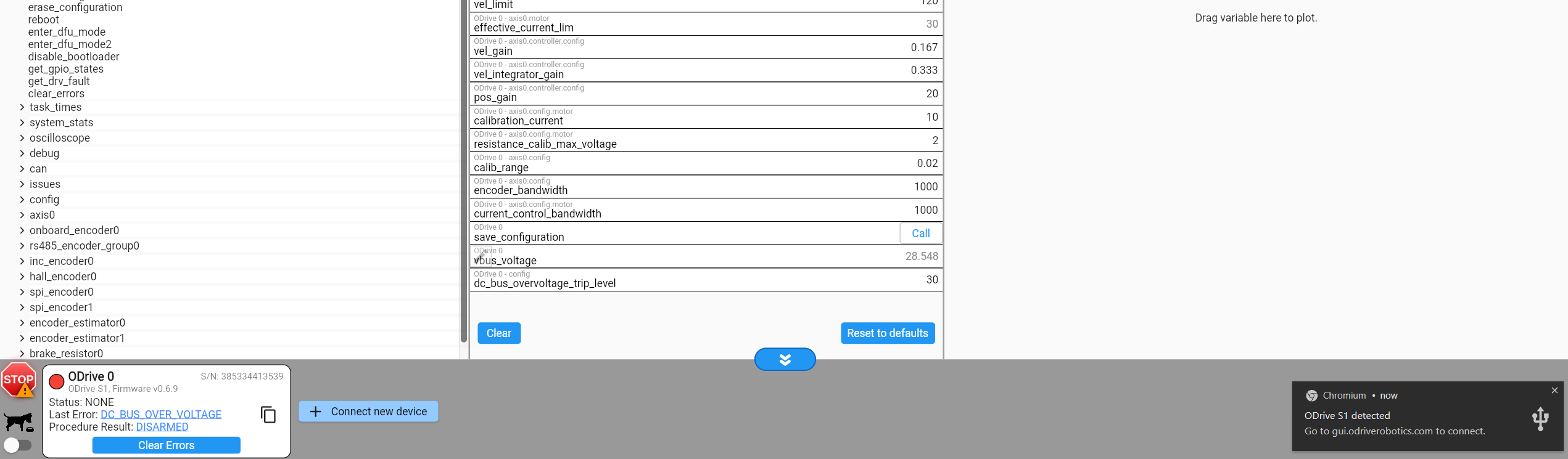

Hello, I am currently using three odrive S1 to control a holonomic drive powered by 24V lithium Polymer Battery, but one is constantly giving an error of dc_bus_overvoltage even if the limit is set at 30V
Could you help out on this?
What does the vbus_voltage property on the ODrive say? e.g. if you check in the inspector tab?
You usually need a bit more margin than that between the overvoltage trip threshold and the actual bus voltage – your 24V lipo is likely actually a 7s, which is 29.4V nominal. Usually 2-4V margin is good – try 32V or 34V for your trip level.
