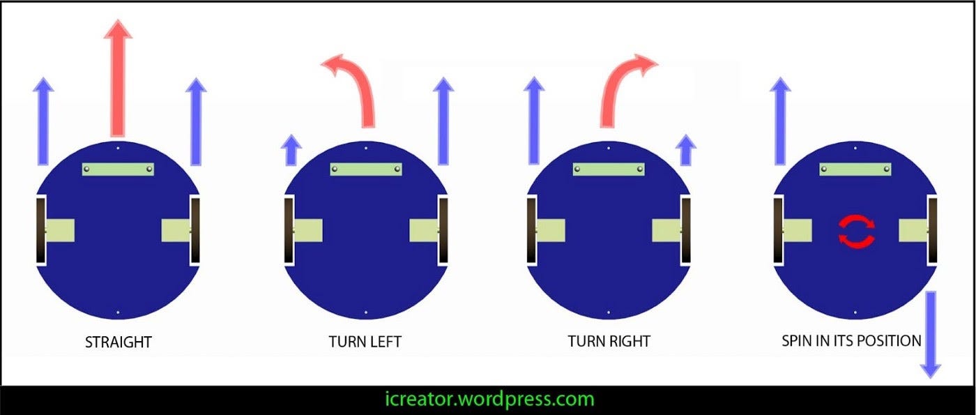

If you are not using some differential velocity setpoints with the setup:
then the expected behavior is simple forward or reverse without steering.
To make a turn these two wheels need to spin at different speeds, otherwise the vehicle will either continue in a straight line, or one of the wheels will loose traction and start slipping. The solution here is to use differential drive (sometimes referred to as skid steering), where the main controller (in this case an Arduino) knows which direction you are trying to turn, and increases / decreases the velocity setpoints for each wheel to achieve this
image source
For a more theoretical understanding of the different steering methods, here are some common kinematics equations.
Also, here is a differential steering Arduino Library for reference.
