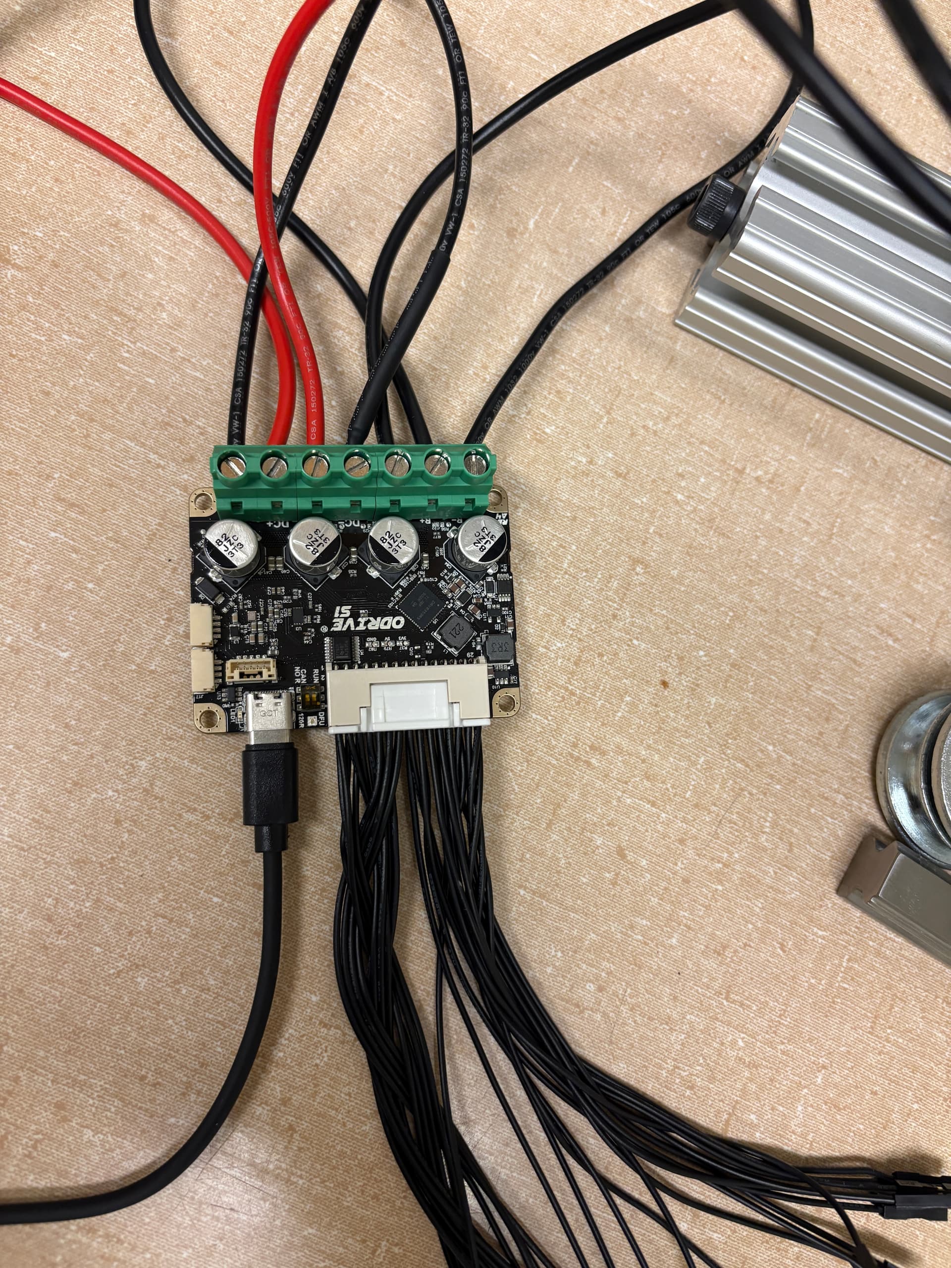

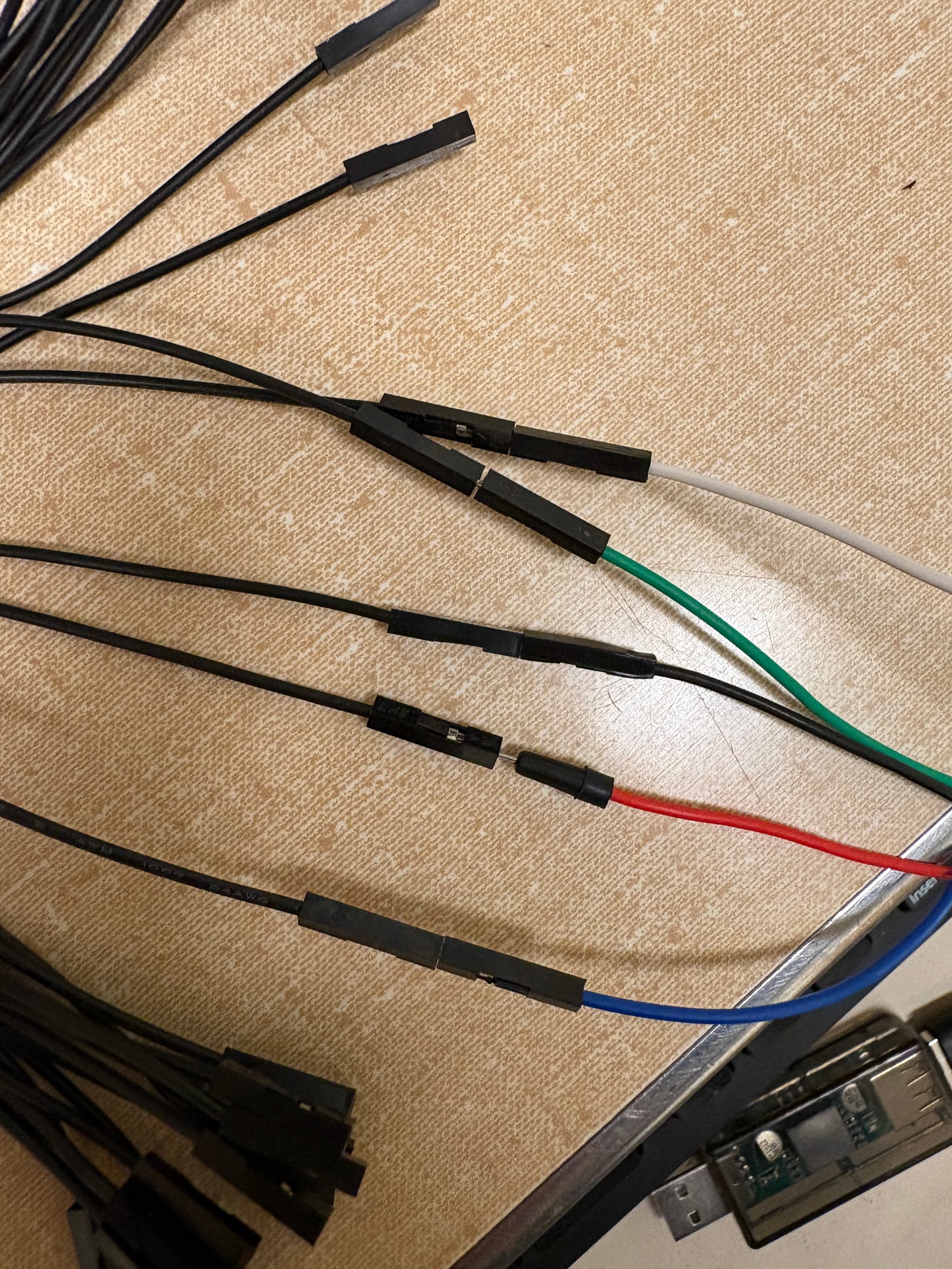

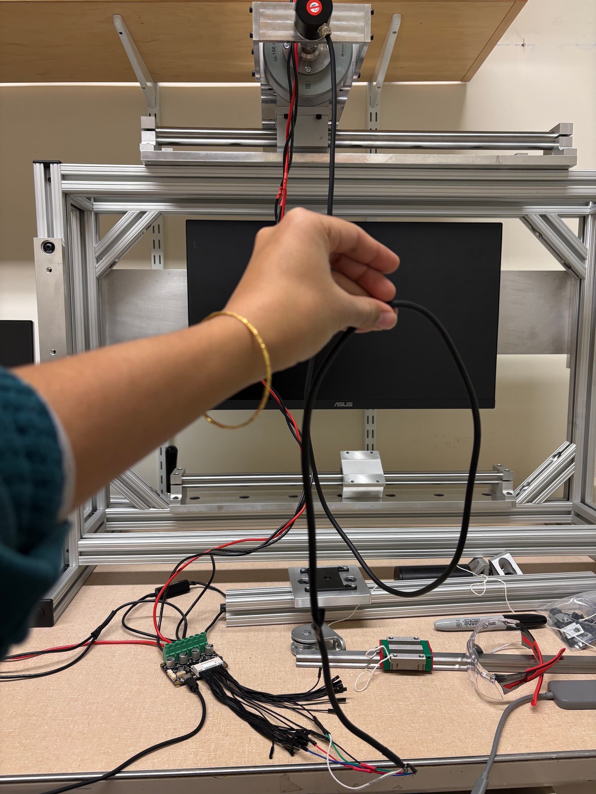

Hi! That video was super helpful, thank you! This sounds pretty textbook like an encoder issue. Likely either the encoder is slipping, or there’s some wiring or interferance issue causing the ODrive to miss pulses. Could you send some pictures of the encoder coupling and your wiring?
Thank you so much! Attached are some photos of my setup, and here’s also another google drive link with a video of the motor, rotary encoder, and shaft collar connecting the two.

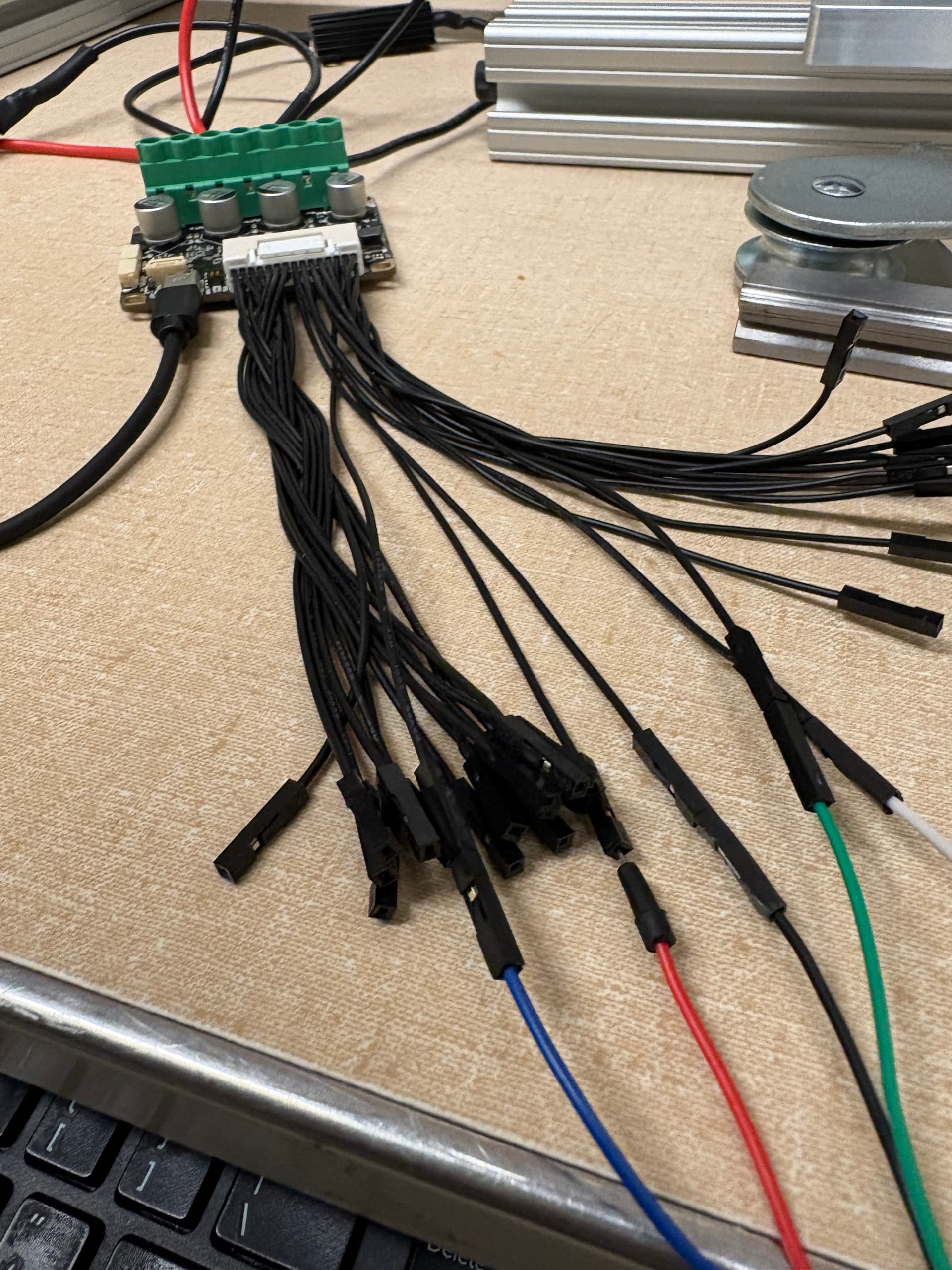

I tried to capture the broader wiring in the first photo below. I kept the wires really long just for ease of moving stuff around in our lab, but eventually I will be shortening these.
Here are the connections between my encoder wires (PWR is red, GND black, CLK is white, DT is green, and the drain wire is blue, connected to pin 26).
And here’s what my ODrive looks like
Do you have an oscilloscope? It would be interesting to see the A/B waveforms while the motor’s running, I think it could be possible to have an intermittent connection with those pin headers. And just to confirm, no possibility of slippage whatsoever with that shaft coupler, you think? Since you have a 20 pole pair motor, it only needs to slip about 3° to invalidate calibration.

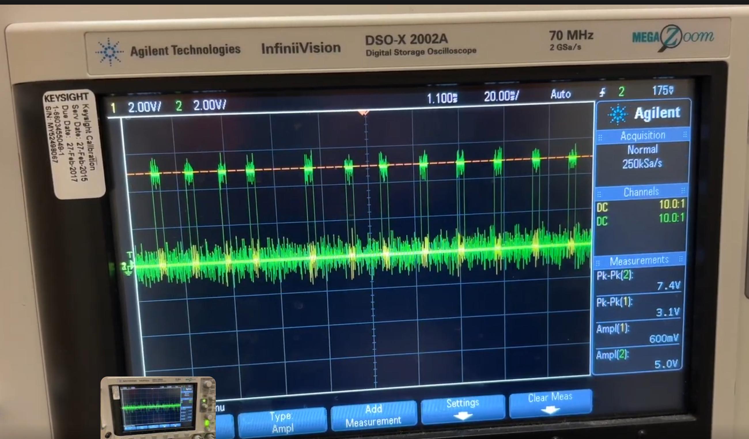

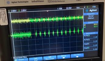

I do have an oscilloscope! Just hooked it up to the rotary encoder A/B phase outputs. The results are pretty strange:
Here’s a video of the A/B waveforms when the motor is idle, and I manually rotate the shaft. The waveforms are crisp. (Because I’m manually spinning the motor, the frequency is very variable as I’m not that smooth).

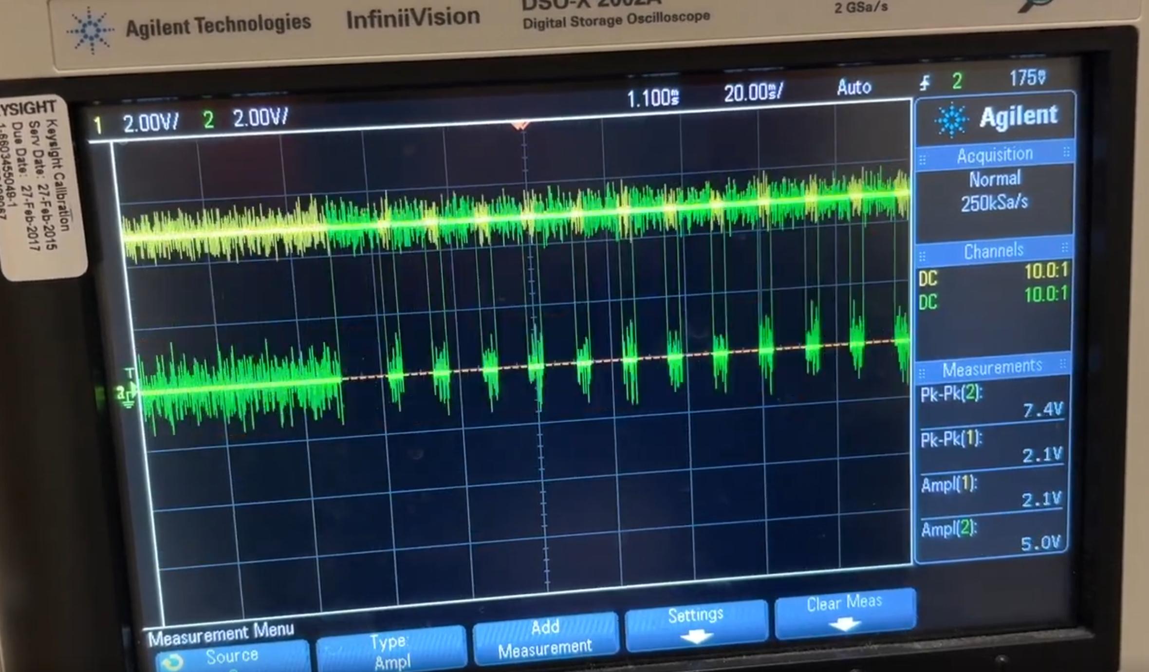

When I run the motor calibration sequence, the waveforms become fuzzier. The motor still moves smoothly and at a consistent rate.
When I try to do tuning in Velocity control mode, the waveforms first look like the calibration. (The control starts about 18 seconds into the video). Then as the motor slows down and eventually stops, the waveforms become really weird. I don’t know what to make of that. At around 44 seconds into this video, the motor is visibly still (with no visible vibrations).
Maybe that weirdness in the waveforms is a reflection of the encoder? Also my calibration failed when I initially hooked up the rotary encoder outputs to a different breadboard, so maybe that’s an indication that I need a stronger electrical connection.
Mechanically, the shaft coupler seems pretty tight, so I don’t think there’s slippage.
Interesting! I’d say it generally looks like a noise/interference issue, but there are some parts that just don’t make sense / look super wrong, e.g. we should be seeing some transition on whichever phase is on the yellow channel:
My general assumption is that you have some loose connection / bad solder joint in there – those breadboard jumpers are always some horrible cheap copper/aluminum that’s weirdly impossible to solder to, it might be worth actually doing a dupont crimp on the encoder cable itself, or getting a S1 harness build kit and just soldering the whole thing up.
Thank you, Solomon! Yeah I did have a hard time soldering those breadboard jumpers. I’ll give the crimping a try or the harness build kit and will let you know how things work out!

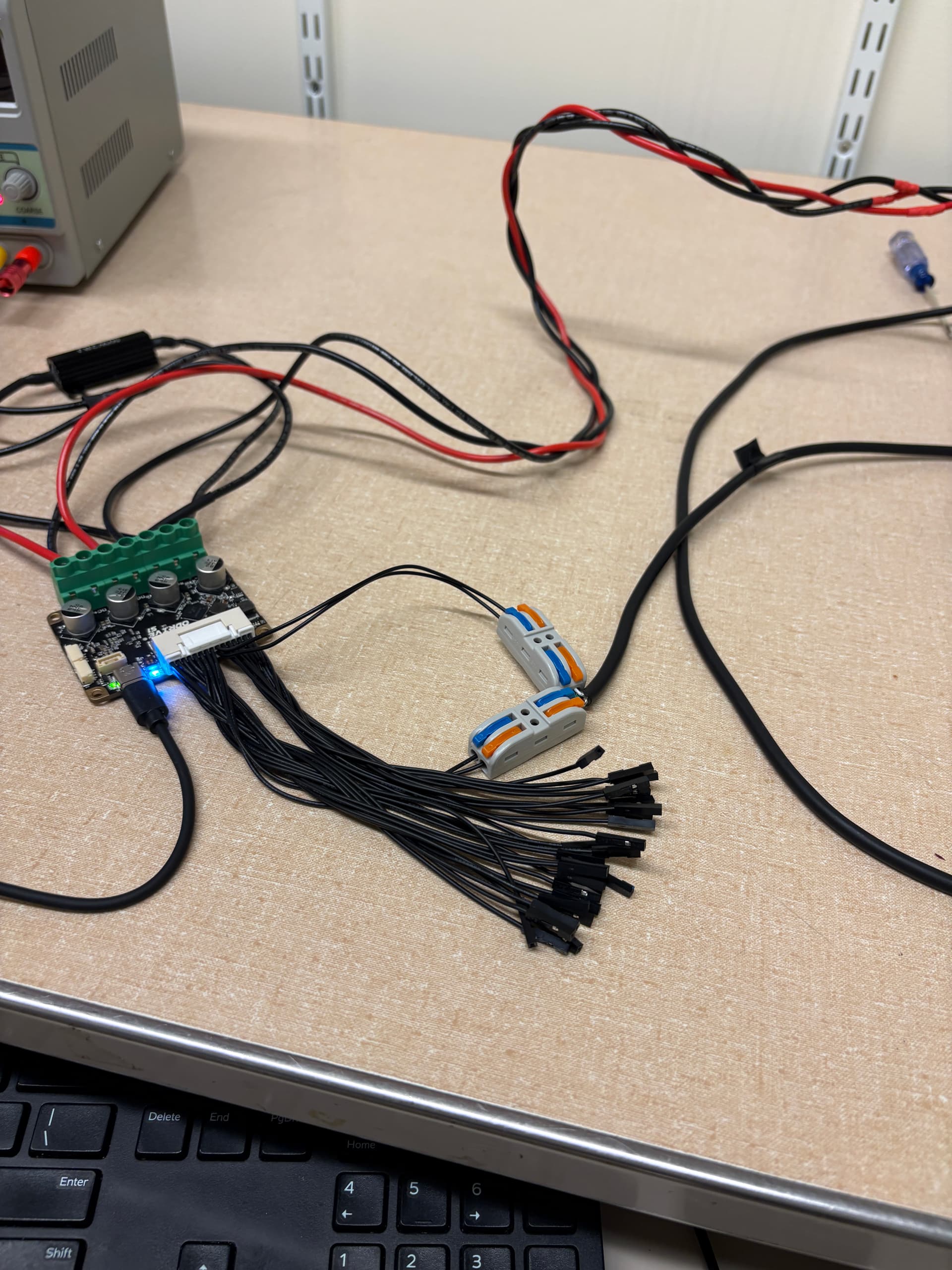

The motor now spins continuously! I made two main changes:
  1. I ditched the breadboard jumpers and connected the relevant wires from the IO harness I had to the rotary encoder directly. I used the Gkeemars wire connectors we had on hand, and I stripped the female dupont ends of the wires on the IO harness
I originally tried putting dupont crimp ends on the rotary encoder wires directly and then connecting those crimped wires into the logic pins; however, I was suddenly getting POLE_PAIR_CPR_MISMATCH errors. I probably didn’t crimp those connections well.
  1. I grounded my encoder’s shield wire more robustly. Before, I just connected the shield wire to an unused GND GPIO port by soldering to the (bad) breadboard wire. To fix that issue, I soldered the end of my shield wire to my encoder’s designated GND wire.
Here’s a link to the motor spinning. Now I can tune the parameters.

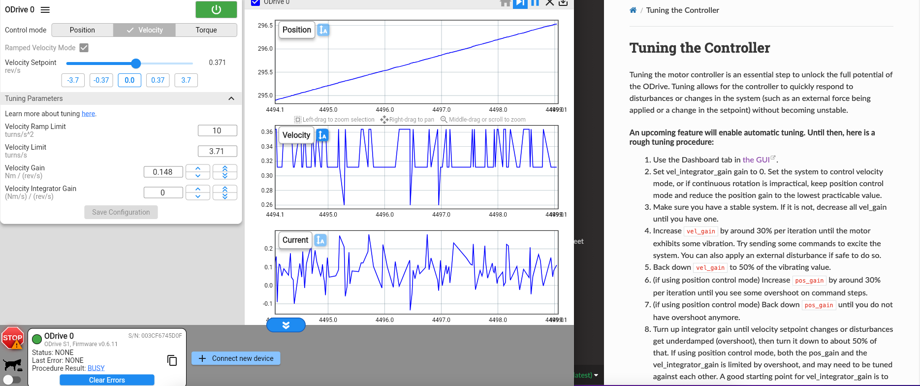

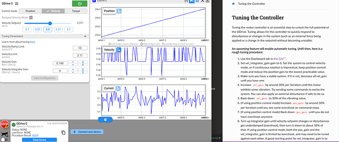

Hi, I am working on the same project, and I was trying to tune the parameters of the motor using the instructions in the photo. I was confused on what it means for the system to be stable. I thought it meant that the velocity shouldn’t be oscillating, and I was unable to ever get it to be a straight line in the velocity plot. Could you guide me with how to tune the parameters? Thank you!
Some velocity noise is totally normal, especially with lower resolution encoders like yours. “Stable” means the motor isn’t physically oscillating – usually I’ll set the velocity setpoint to zero, then kinda torque the motor by hand while increasing the gains, until I feel some vibration/oscillation – that’s the system starting to go unstable.
