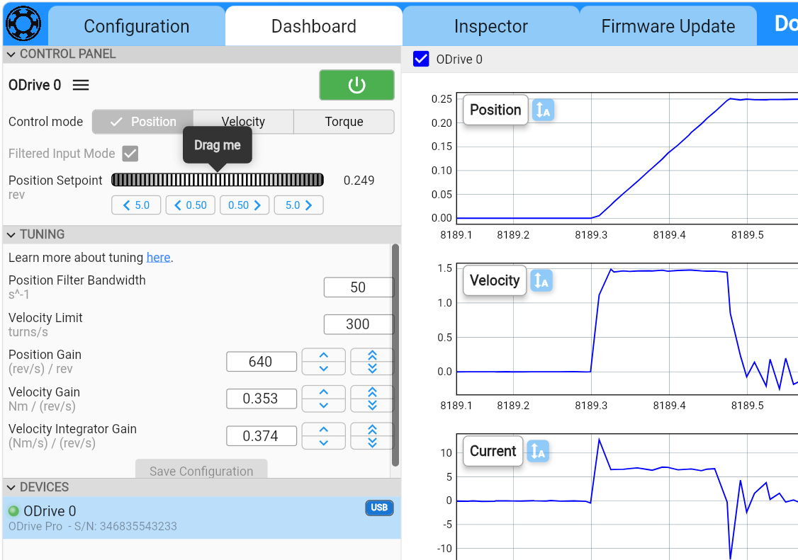

How to set velocity limit
We have a motor of 12 pole pairs, max speed is 150RPM. How to set the velocity limit in the software GUI for test? Is this mechanic velocity or electrical velocity? I set it to 300; the velocity can only go to 1.5 during position change.
That’s mechanical velocity. Note unit is in turns/s (or revolutions per second). So 150 RPM is 150/60 = 2.5 turns per second.
The 1.5 turn/second limit seems to be a system limitation. What motor, encoder, and power supply are you using?
The motor is a customized motor with 12 pole pairs, encoder is RLS 18-bits BISSC absolute encoder, power supply is 24V, 20A. How to increase the system limitation to make the motor run at 150RPM?
Motor is 24V power input BLDC,.
Is your motor under a lot of load? Perhaps the 150RPM number is only with zero load? Otherwise, you could increase the supply voltage.
