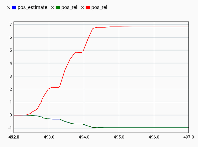

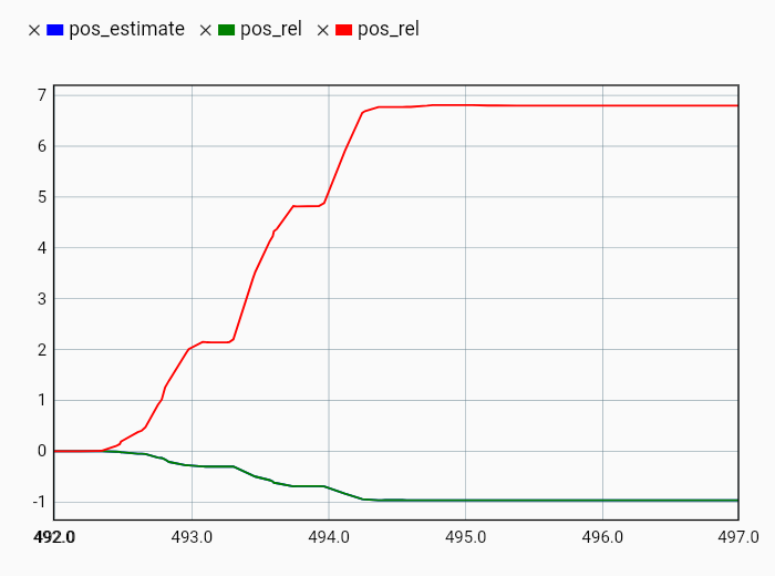

My encoder has a resolution of 1 µm, which means the A and B signals both have a pulse every 4 µm and this is multiplied by 4 with the quadrature encoding. My ballscrew has a pitch of 10 mm. So every revolution of the motor, there should be 10000 counts, so I have set the cpr to 10000.
Then I checked the following parameters in the monitor while turning the ballscrew approximately 1 turn (I have set the circular range of the commutation encoder to 20, to avoid overflow:
axis0.pos_estimate (blue)
axis0.pos_vel_mapper.pos_rel (green)
axis0.commutation_mapper.pos_rel (red)
There is a difference in scaling with a factor -7. This factor also appears in axis0.commutation_mapper.config.scale and is set to -7 after running ENCODER_OFFSET_CALIBRATION. I can only set this value to -7 and 7, as it should match the pole pairs of the motor.

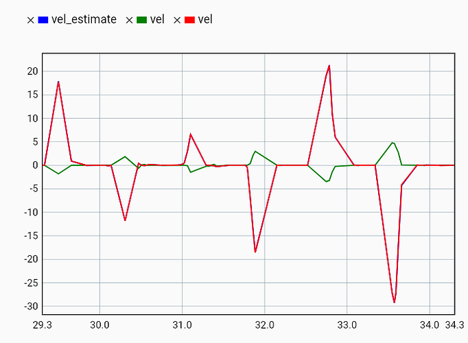

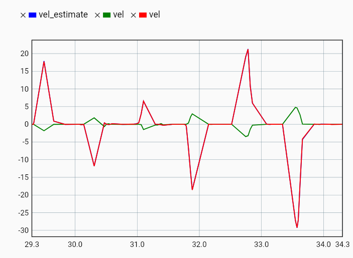

When I look at the velocity estimations, I can also see approximately that same ratio between the velocity of the control loop (vel_estimate, blue), the commutation mapper (vel, red) and the linear encoder (vel, green):
This meant that my velocity estimate is not correct and the polarity is reversed. That’s why I have set axis0.controller.config.commutation_vel_scale to -1/7 = -0.143.
With these settings, everything works fine.
