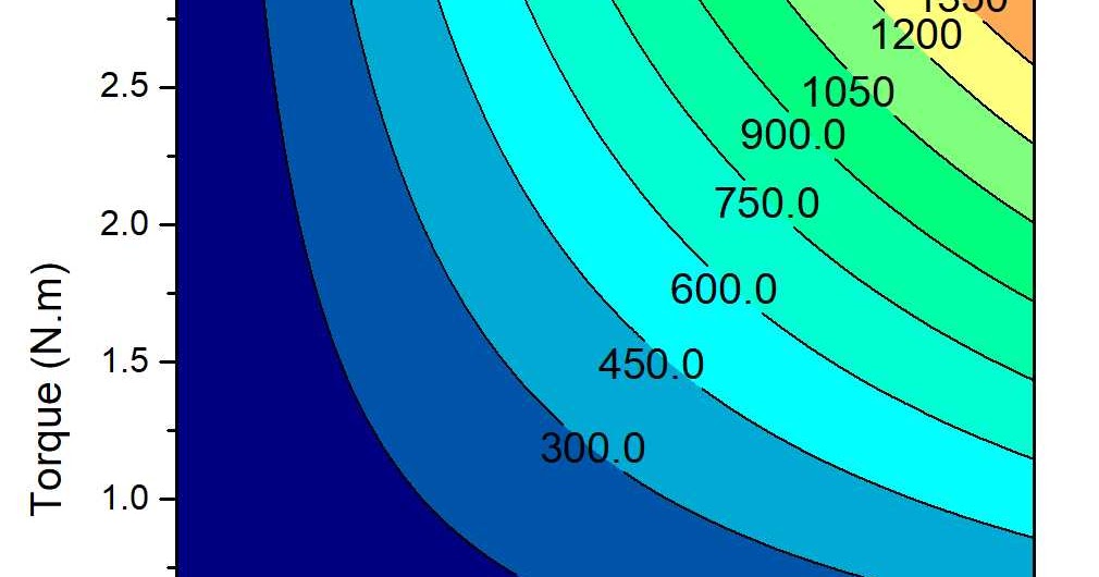

The current isn’t the same – bus power == motor power, but the ODrive “steps down” the voltage as a property of how motor control works, so motor voltage < bus voltage, motor current > bus current, and motor voltage * motor current == bus voltage * bus current.
Happy to do a better job explaining tomorrow - here’s a good article on it though:
