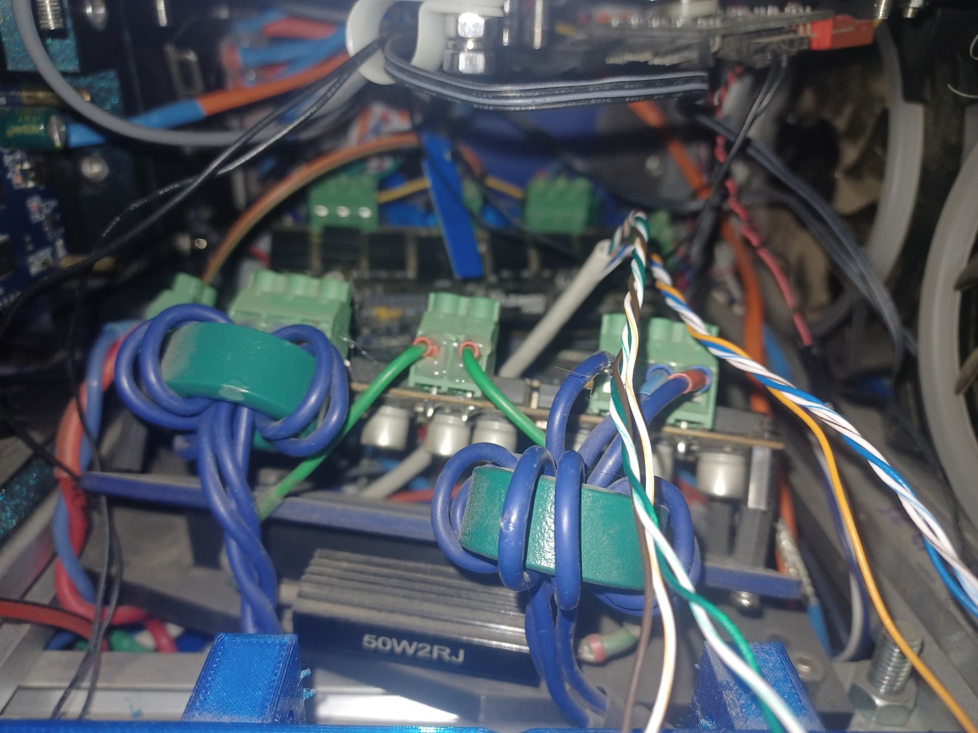

Hmm, super interesting! Could you post a picture of your wiring, and all of your configuration (from erase_configuration)?
Sure. I’ve disconnected everything except a single motor while I’m troubleshooting.
And here’s the code I use to calibrate, replacing axis0 with axis1 when calibrating each, with the exact same settings otherwise.

Hmm, where’d you buy those ODrives? The reason I ask – a few details about the board make me think they’re a clone / not official. Those are all based on ODrive v3.4 (even if they say v3.6 on it), which had some massive massive electrical interference and performance issues. I would definitely point towards that as the culprit here.
I received them from a colleague a few months ago. They were purchased as redundancy for the project we collaborated on and didn’t end up needing them. The box he delivered them to me in had the original packing slip and purchase receipt from ODrive, though its current whereabouts are unknown.
Still, the M0 lanes calibrated other motors prior to now as I was testing various builds and motor placement. This is a new issue.
Any noise causes problems you def need to use 31X19X13mm Isolator Ferrite Core rings. Solved all my problems with my hoverbot. My 2 odrive 3.6 boards are noisy. 4 im guessing is worse
