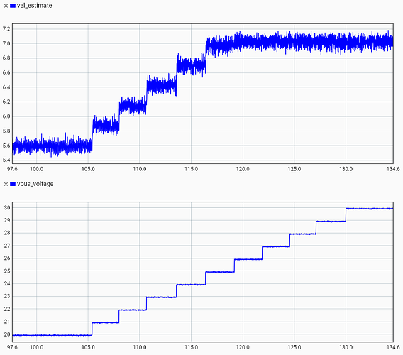

I have an iPower GM5208-12 motor connected to an ODrive S1, with an AS5048A encoder. There is a plastic disk connected to the motor that I want to spin at a constant velocity, so practically no load on the motor.

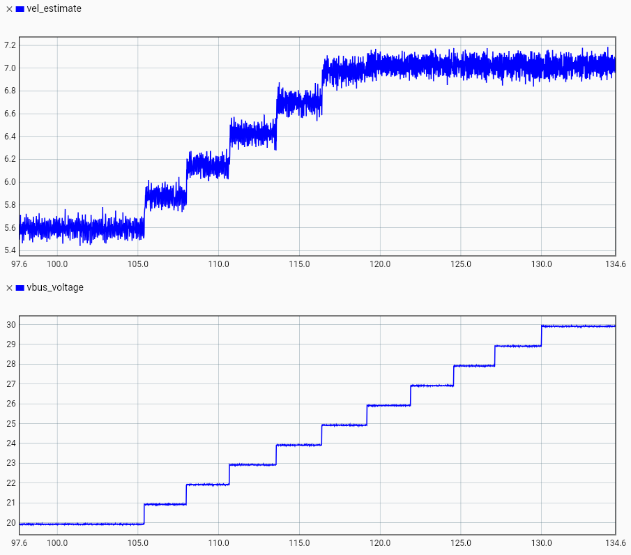

The problem I encounter is that the ODrive seems to actively limit the velocity for a reason I do not understand. I expect it to be able to spin at k_v * v_dc * 0.78. The motor is rated at 24 rpm/V, so with 24 V it should reach 450 rpm, and at 30 V up to 560 rpm. However, the velocity saturates at around 420 rpm at 25 V and doesn’t increase further with increasing supply voltage. Setting the target velocity to 15 rps and slowly increasing the voltage from 20 V to 30 V yields the following behavior:
On an oscilloscope connected between two motor phases at the ODrive terminals I can observe that at 25 V, the motor voltage does indeed reach the maximum 78 % duty cycle during the sine wave peaks. However, at 30 V, the duty cycle only goes up to around 66 %. The effective voltage is 25 V * 78 % = 19.5 V and 30 V * 66 % = 19.8 V, so this matches the observed behavior.

Does anyone have an idea if there are further configuration parameters or hardware limitations that can limit motor velocity?
Here is a scope capture of the phase-to-phase voltage at 30 V, where the duty cycle only reaches 66 %:
Hi! If you’re running in PMSM_VOLTAGE_CONTROL, then this is normal – that’s only really applicable for low-speed control, it won’t compensate for things like motor inductance (which is what prevents the higher speed control in this case). I’d recommend running in PMSM_CURRENT_CONTROL. You may have to manually set the phase inductance, since it’s higher than the typical acceptable range for the S1; I measured a GM5208-12 on my LCR meter, and got a number of 5mH. Try setting:

Thank you very much, that did indeed increase the maximum speed to around 500 rpm at 30 V. In what instances would I need to run in voltage control mode? I couldn’t really notice a difference with bEMF_FF_enable set to True or False in my quick test.
